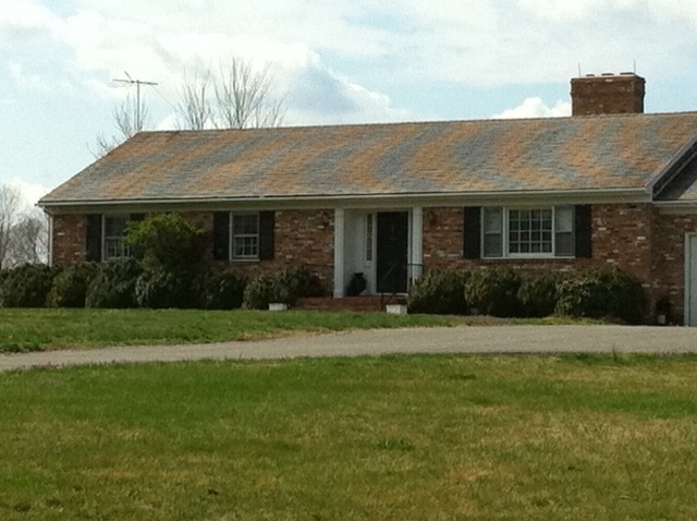

Many houses in my area (Virginia where it is humid) with Asphault/fiberglass shingles develop roof mold stains. My house is seven years old and hasn't developed them yet, but I think they are really ugly and would like to avoid them or remove them should they occurr.
I know they make shingles that are supposed to be resistant but I don't know if I have those or not (probably not). They also sell some kind of cleaner in Lowe's which I imagine is bleach based.

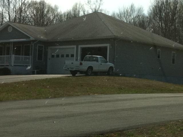

The first picture below shows a typical stain and the second shows a roof that has been cleaned and has a spotty scrubbed apearance that is not very good.
Aside from keeping the trees back does anyone know how to avoid or control this or have any experience with the cleaners?

The only way to prevent it is to keep the trees away from the home and allow sunshine and air circulation to prevent moss and algae growth. The second pic with the uneven colors looks like someone took a power washer to the roof and removed the colored granules. This is usually caused by the pressure washer at too high a setting. The cleaner should be applied with a garden sprayer to kill the algae and then washed off with water. If done correctly you should not see a color variation on the roof. Good luck if you are gonna DIY or hire a pro.
/ Roof Mold #4
I can't remember the name but I got a cleaner from a roofing company and it cleaned it perfectly with very little effort. I just used a garden hose to wash it off, not a pressure washer. I've heard that bleach will also work, just not as easily.
As far as prevention, look into zinc strips.

Pressure washing will get rid of the big stuff either before or after treatment with a commercial product.
A heavy copper wire on the ridge (both sides) will keep moss from forming. The exposed wire creates small amounts of Copper Sulfate that prevent fungus from growing.

Too late for this, but they make algae resistant shingles that have a small amount of zinc in the granules. I have heard that you can put zinc stips near the ridge of the roof and rainwater will spread enough zinc "runoff" over your roof to prevent algae (mold is really algae). Might want to research it some. Don't use high pressure to remove it if it shows up, it will also remove your granules, which are there to prevent UV degradation. Good Luck.
