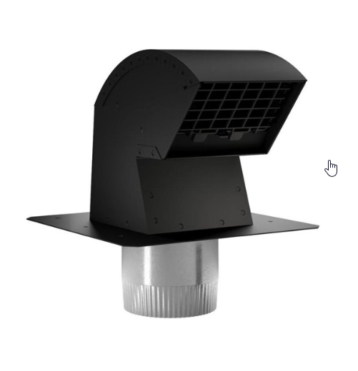

Located in South Carolina, so no snow issues.
the roof vent would be straight up with no bends, the wall will have one 90 degree bend.
   / Roofing discussion!!! #112
attach is one example, I like the length from the exhaust to the roof on this one but see your hardware store look at your options as long as they have a back draft damper, a screen so nothings goes in and a decent pipe diameter. (at least 4'' diameter) Use hard line pipe and not flex pipe as flex increase resistance.
I don't know your house configuration here but if its a finish house the roof might be easier to install you simply have to cut the hole through the sealing to the addict then through the roof and shingles and you just slip that in. for the wall you might have to deal with fitting it under the siding which can be lots of work … but you also could bring it to the addict and pipe it to a gable which could be easier then the wall … but again the major components for resistance are diameter, distance and corners. Resistance = less airflow...

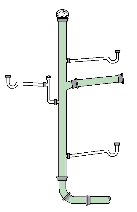

No, the P trap stops the gases from getting into the house, but the vent lines are clear all the way to the septic tank, or in town, all the way to the manhole.
A quick search of images found this picture. You can see how the trap is close to the sink, or whatever you are using. Then it flows into the main line. The main line is open from under the house, to above the house.
multi gracie to you and the others. I usually like to understand something first.
i still don't understand why i can vent a washer into the attic seeing that the washer drain is connected to the main drain line but....
i get it except the washer vent in the attic part.
thx all

If the washer drain is connected to the main drain, that's a path for gasses coming from your septic or municipal sewer system. So the P trap in the washer drain should block those gasses from coming back into the laundry room through that path. The vent for the washing drain is now the path for those gasses. You don't want sewer gas venting into your attic. You need a vent on the washer drain for proper drainage.
You have several choices. Three I can think of are:
- Tie your laundry vent into the main stack vent somewhere in your attic.
- Or, poke a hole in the roof and vent it separately out the roof.
- Or, put a Studor valve (air infiltrator valve) on a riser next to the stand pipe for the washer drain, making sure it's higher than the stand pipe. (this is the easiest way to do it, in my opinion, if it's legal in your location per code).
Never vent anything into your attic.
i got it
what i was missing was ....
while the p traps stop the gasses from reentering the specific room they are in, once the gasses get in the main line, they can move around.
the washer vented to the attic was 10 years ago.
anyway, time to cut a hole in the roof.
