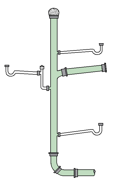

My question is re the gasses. if you refer to the humidity i agree but again, the nasty gasses from the kitchen or bathroom are trapped by the.....P trap? No?
No, the P trap stops the gases from getting into the house, but the vent lines are clear all the way to the septic tank, or in town, all the way to the manhole.
A quick search of images found this picture. You can see how the trap is close to the sink, or whatever you are using. Then it flows into the main line. The main line is open from under the house, to above the house.
