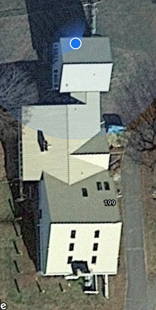

BlueMule, doesn't every home have a 2140sqft party room with dance floor, bar, and karaoke stage. And a separate 1200 sqft guest suite with indoor 4 person hot tub? I thought everone had that.....LOL
That is on top of 5BR and 3.5BA of the central part of the house.
But we bought the property for the view, and the 108x48 horse barn. The house structure needs a lot of work.
