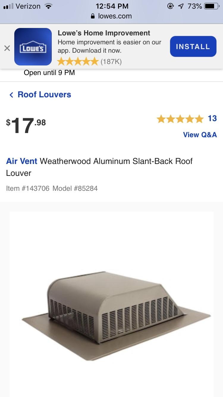

Roof vent stacks suck. They’re a guaranteed leak source. I don’t know why code won’t allow a wall or soffit vent for them. A rubber boot only last about 10 years. Left unmaintained they’ll every one leak.
   / Roofing discussion!!! #88
I’ve had better luck with these boxes vs rubber boots. I’m wondering if tge inspectors would allow the pipe to be cut short and put one of these over it .

I’ve had better luck with these boxes vs rubber boots. I’m wondering if tge inspectors would allow the pipe to be cut short and put one of these over it . View attachment 707731
For a plumbing vent, that would NOT meet code anywhere!
