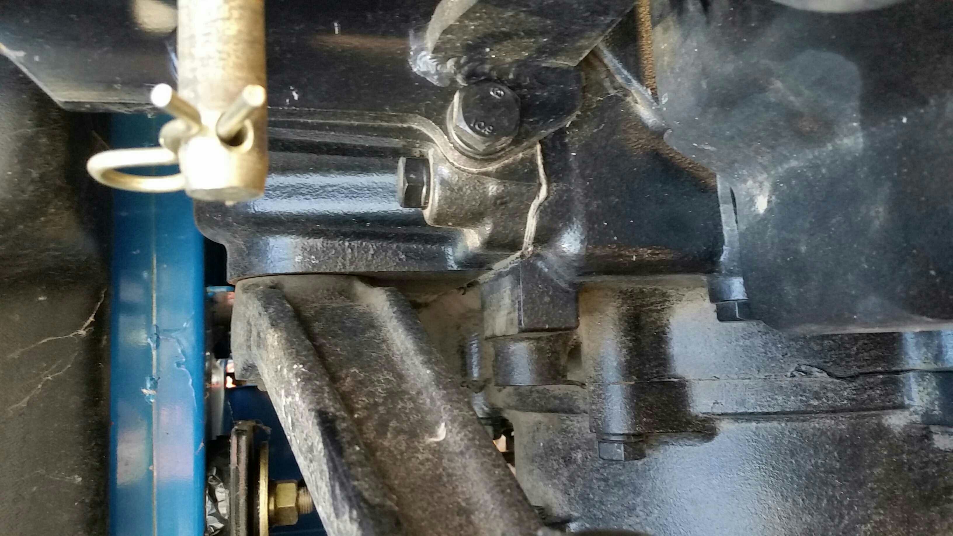

I have an LS R4047 and am trying to use the 3 pt hitch for the first time with a landscape rake. It seems like my 3 pt arms are not lowering all the way. This is as low as they will go. I may be missing something basic...? uploadfromtaptalk1459006509726.jpg
/ Rookie 3pt question #2
looks ok to me... Neither of my tractors allow the lower link arms to touch the ground.
Are you unable to hook up the rake due to the arms not lowering far enough?

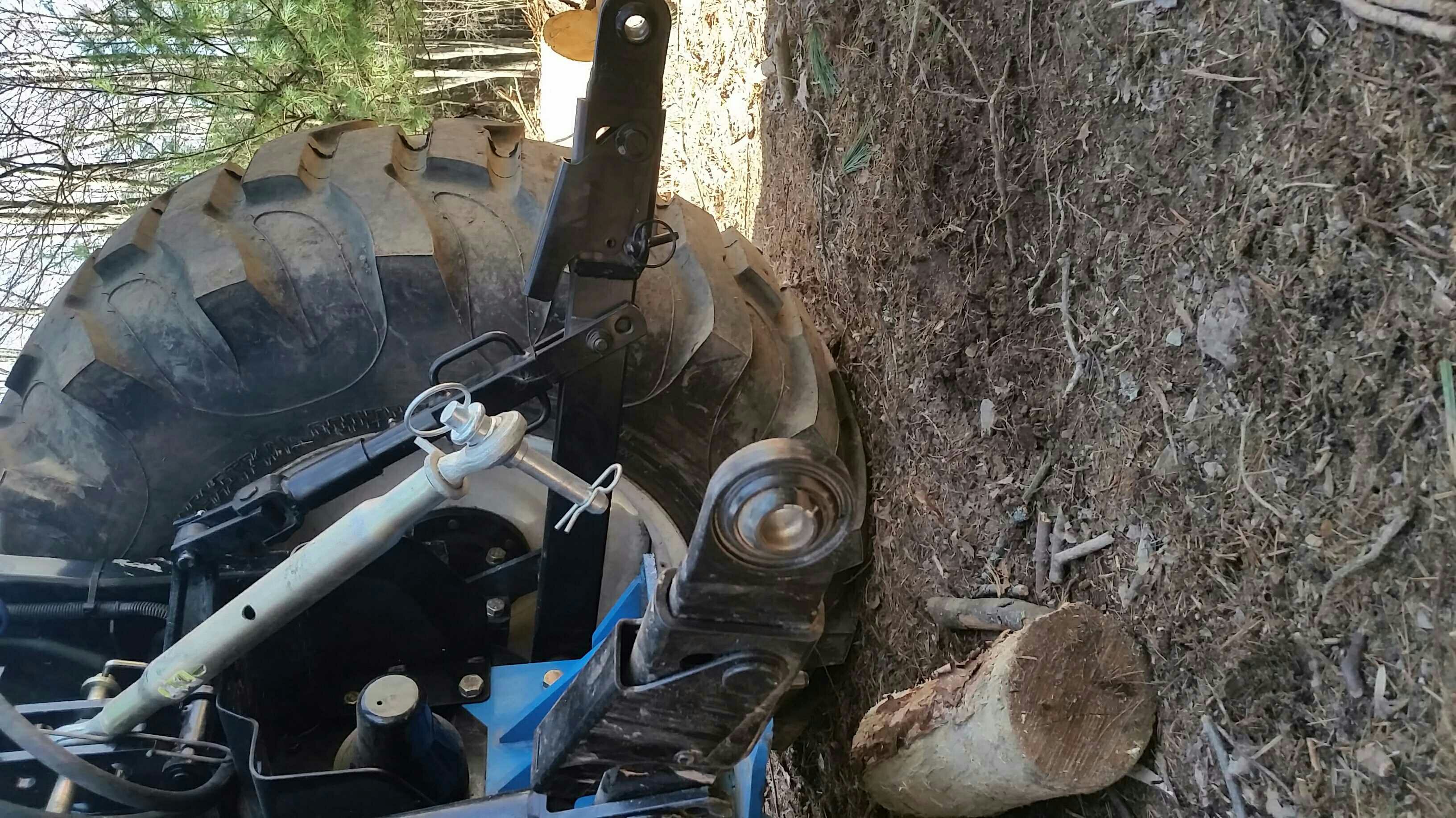

The right and left Lifting Rods, which raise and lower the Lower Links, have stirrups at the bottom. Stirrups pin to the Lower Links. If you move the right and left pins to the lower holes on the left and right stirrups, rather than the default upper holes as shown in your second picture, Post #1, your Landscape Rake will lower 3" to 5" further.
Adjust the left pin first, using the Lifting Rod screw adjustment on the RIGHT Lifting Rod to put some slack in the LEFT SIDE. Second, move the right pin. It is best to lube the pins occasionally to make changing pin positions easier.
Changing Top Link adjustment will alter angle of attack of rake teeth but will do little to lower the rake.

Thanks. I see the different holes for adjustment. It looks like everything is in the lowest position.
No.
In your second photo, Post #1, the right and left stirrup pins are in the upper position.
They usually need to be moved to the lower position when using 3-Pt. Lawn Dethatchers and often with Box Blades when pulling down mounds, sometimes with Landscape Rakes and sometimes with Rear Blades; whenever more 'drop' is needed in an implement.

In your second photo the right and left stirrup pins are in the upper position.
They usually need to be moved to the lower position when using 3-Pt. Lawn Dethatchers and often with Box Blades when pulling down mounds, sometimes with Landscape Rakes and sometimes with Rear Blades.
Ok, I see what you mean now. I got it to work by adjusting the top link. Tomorrow I will change the stirrup pins to the low position and see how that works.
