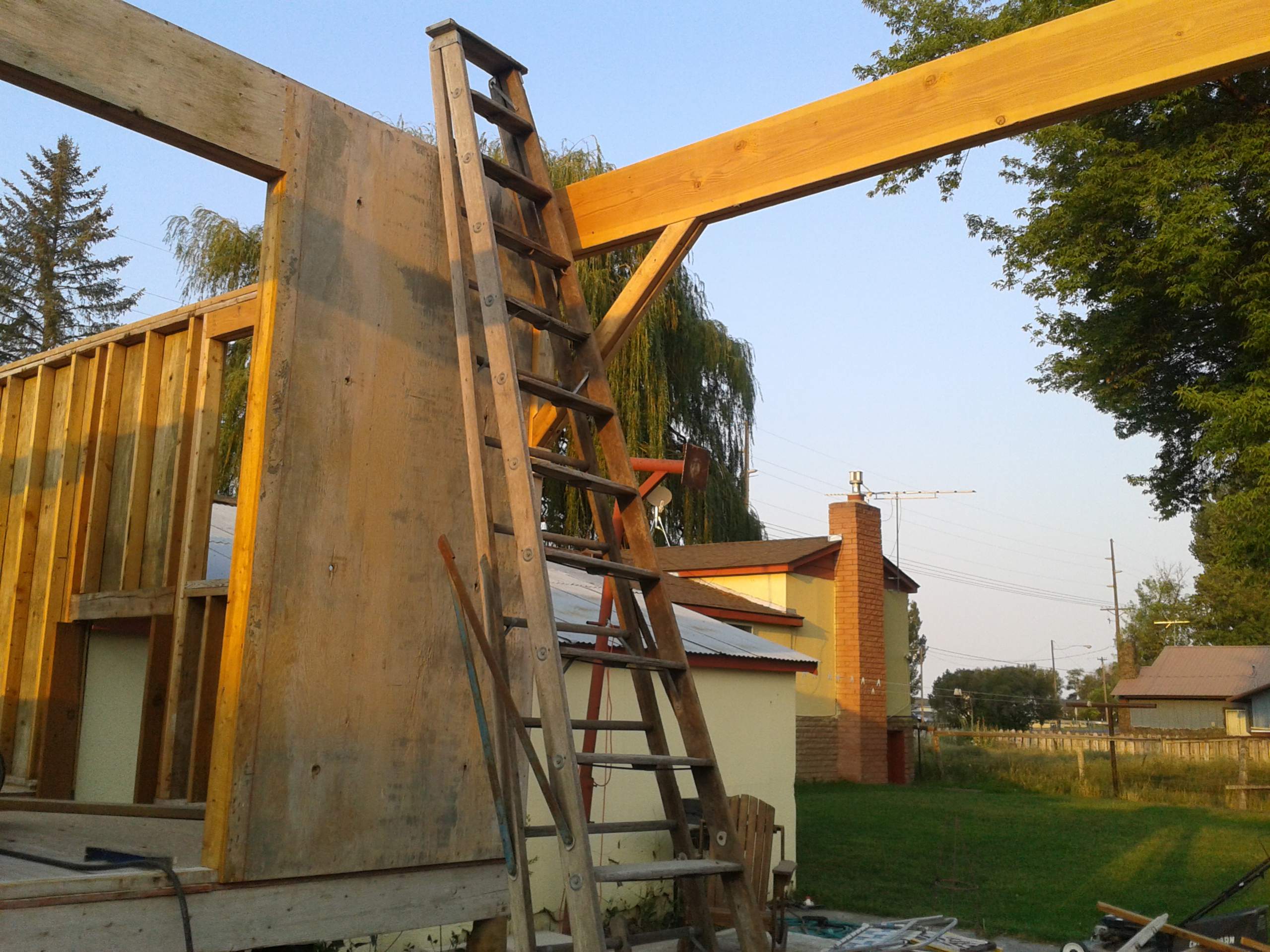

I spent half the night at the rodeo last night, so I only had time to put up one of the braces. What do you all think? I this going to hold the roof up?
I took the pictures this morning. The lighting is a little weird, but you can get the basic idea.

I got the second brace up last night. I like these braces enough that I think I'll do the same thing on the front of the shop where the gable overhangs. The angled notch in the verticle piece probably doesn't add a lot of strength to the system, but it really makes it easier to install.

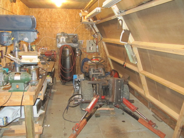

That's pretty close but the only window I have is in the entrance door which opens to the inside of a steel Quonset building. It's truly a cave-like place and I can heat it in winter:snowflake:. The boombox is a little newer; it has a compact disc player, too.:laughing: The WD40 is on the shelf at the opposite end of the shop - behind me as I'm taking the photo.:camera:

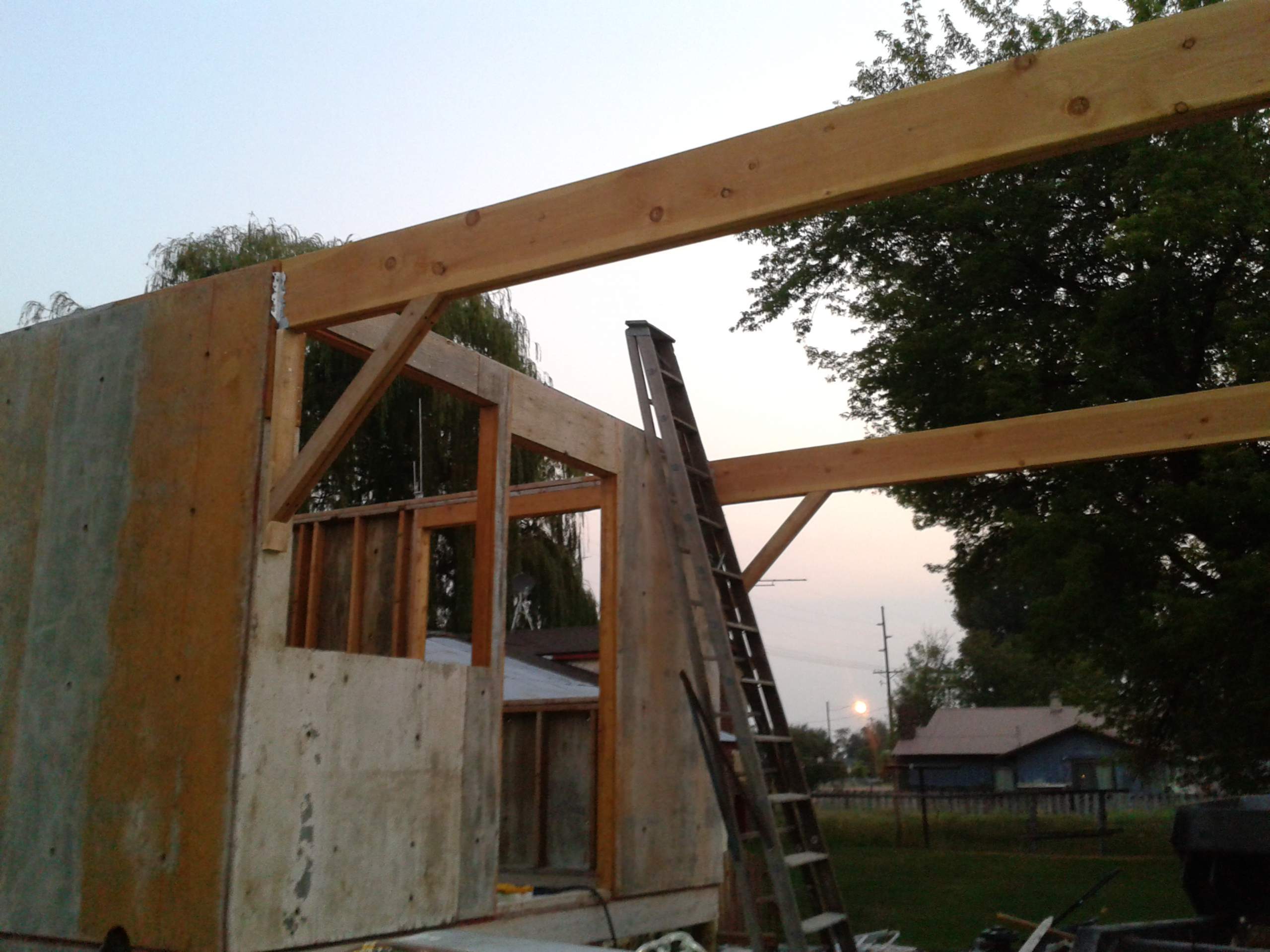

Here is the South wall with brackets added. As I posted this picture I realized that I left my contruction adhesive on top of the wall.

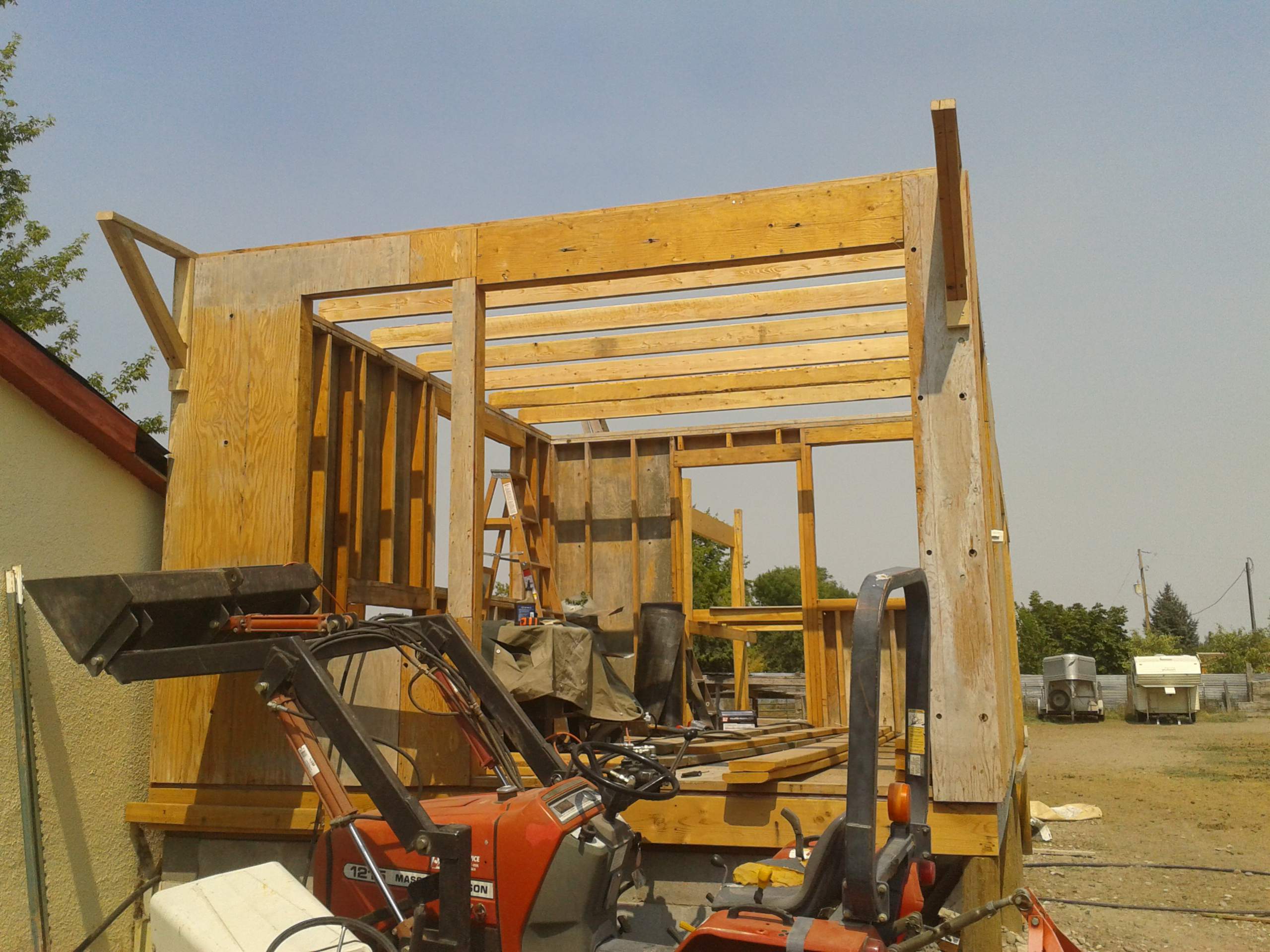

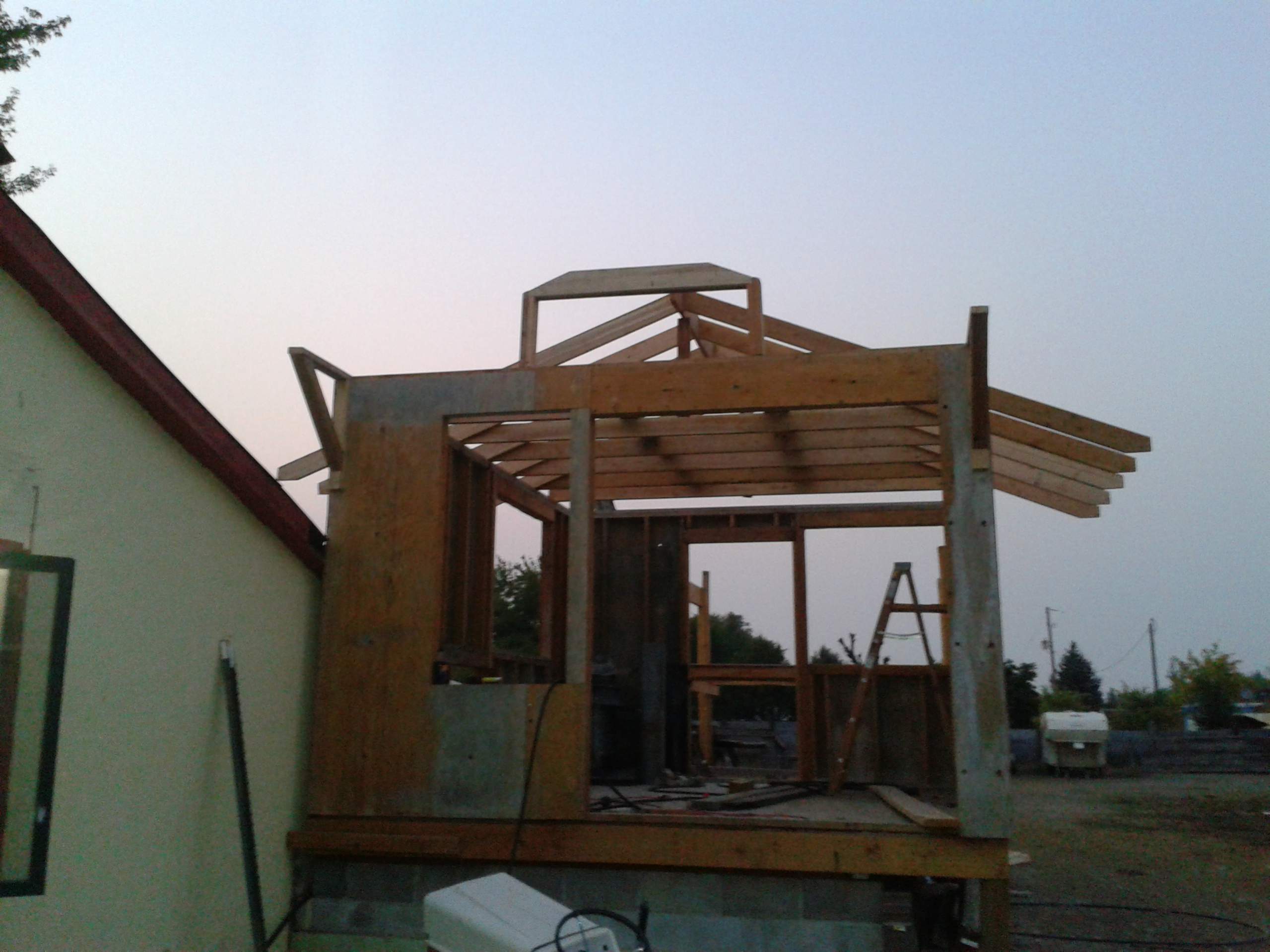

I got my construction adhesive down off the wall. I also got all of my ceiling joists up on the workshop portion and hung a bunch of rafters. The first picture is about halfway through the day after I got the ceiling joists up. The second picture is at the end of the day when I started running out of daylight.
I learned a few things about hanging rafters. I found that the best method is to set the rafters in place with the plumb cut at the top slightly above the ridge beam (~1/4" or so). Then I'd nail down the bird's mouth to the top plate of the wall. After both rafters were nailed to the walls I'd climb to the ridge and tap the rafters down where they belong and nail them to the ridge beam. This created the best fit and also kept the ridge beam straight as I worked.
I put up 5 sets of rafters. I'm 1/4 of the way done with the roof. It is a little nerve wracking being up on that roof, and I'm looking forward to being done.

Your gettin there...nice overhangs!
   / Root Cellar Remodel, Split Level Storage, Shop, Shed Pole Building on a Foundation
#190
Thanks. I planned for the long tails on the rafters because I had 10' boards already, and it seemed like a shame to cut much off. I was originally concerned that the overhang may overwhelm the little shop, but I think it looks okay. I have nearly 3 feet of overhang. That should keep the windows dry.
