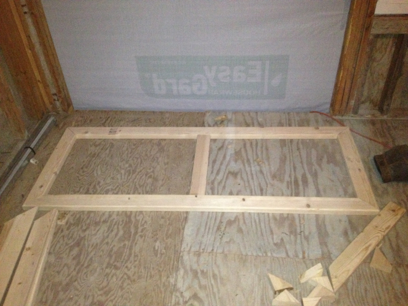

I cut out the frame for my garage door. I've decided to go with 1.5" for now. If I find that the area around the door is too cold I can make a thicker door later.

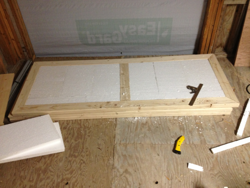

Here's the foam core.
Does anyone have any suggestion on how to cut styrofoam? I've tried a few things and ended up with a serrated kitchen knife.
   / Root Cellar Remodel, Split Level Storage, Shop, Shed Pole Building on a Foundation #278
I like to use a regular hand saw to cut styrofoam.
Eddie
#279
Thanks, Eddie. I may try that. The kitchen knife cuts okay, it just leaves a rough edge and gets fluff all over the place.

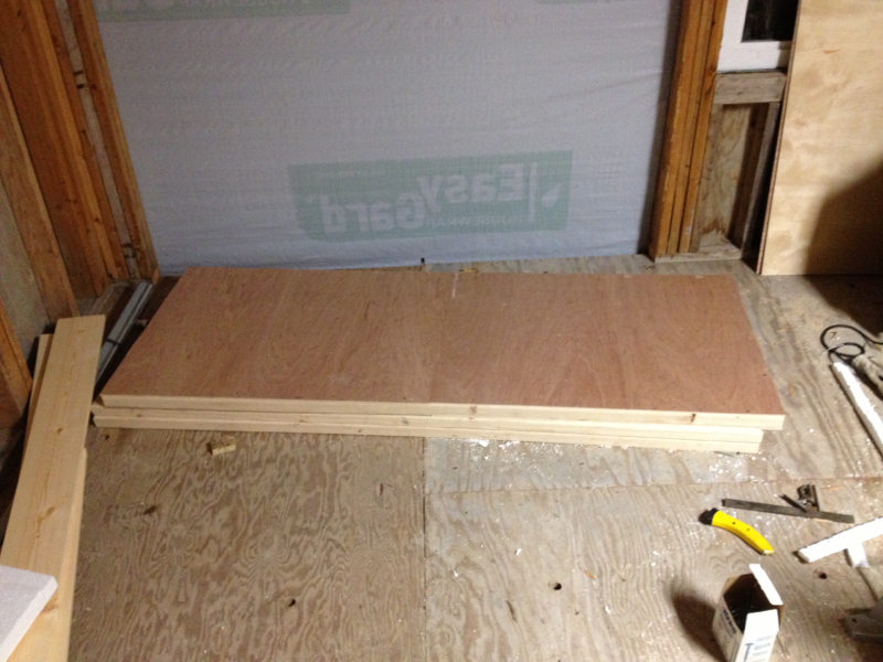

Here's a picture of the top panel done.
#280
Oops... Here's the picture.
