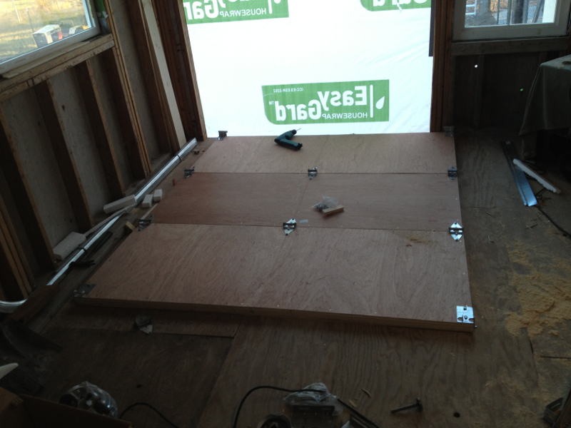

Here's my garage door all dry fitted and ready to install.
I ended up using the kitchen knife for the rest of the styrofoam just because it was out there.

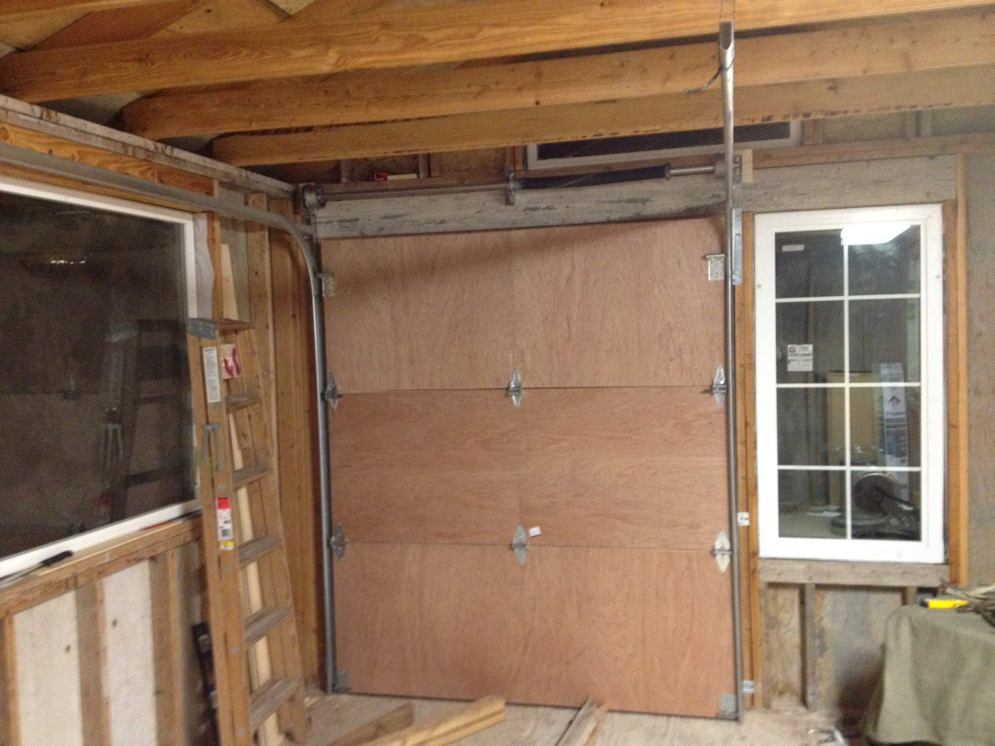

If anyone was wondering, installing a garage door is not a good project to attempt alone. When juggling loose track, a large door panel that has nothing convenient to hold on to, and wheels that fall out of the slots if the door is even slightly tilted, it's easy to run out of hands. I gave it a few different tries on Saturday night. I finally had to quit before I made myself late for a Christmas party. I found this video that makes it look easy. I'll try again tomorrow or Tuesday following the tips in the video.
   / Root Cellar Remodel, Split Level Storage, Shop, Shed Pole Building on a Foundation
#287

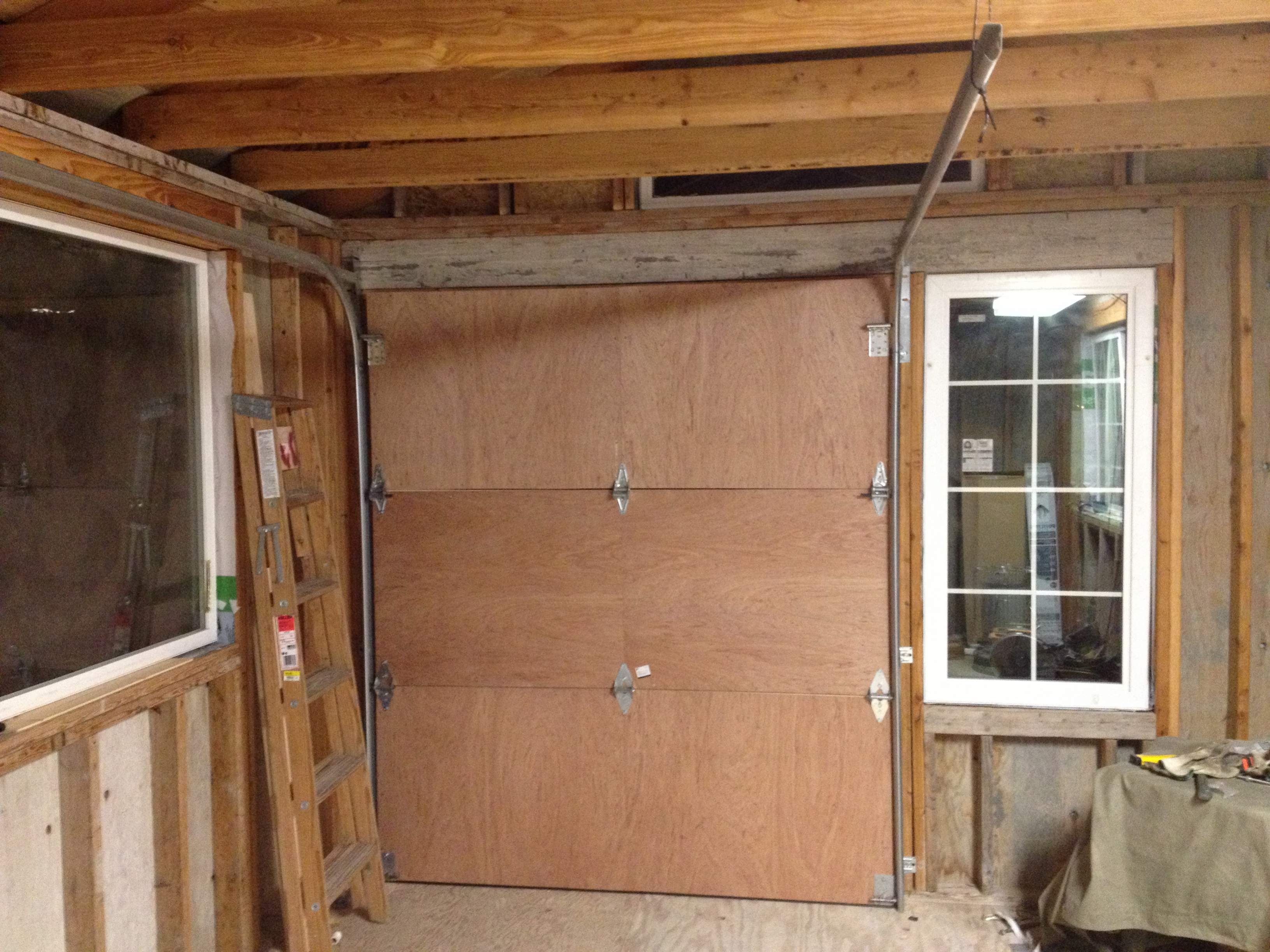

Here is the door all put up in place. The second picture includes the torsion spring in place where it goes. I haven't put tension on the spring yet. I'll have to make some adjustments when I put the sheetrock up, and I may just wait until then to fully install the spring, etc. It will depend on if I need that door for access while I do the other phases of construction.
