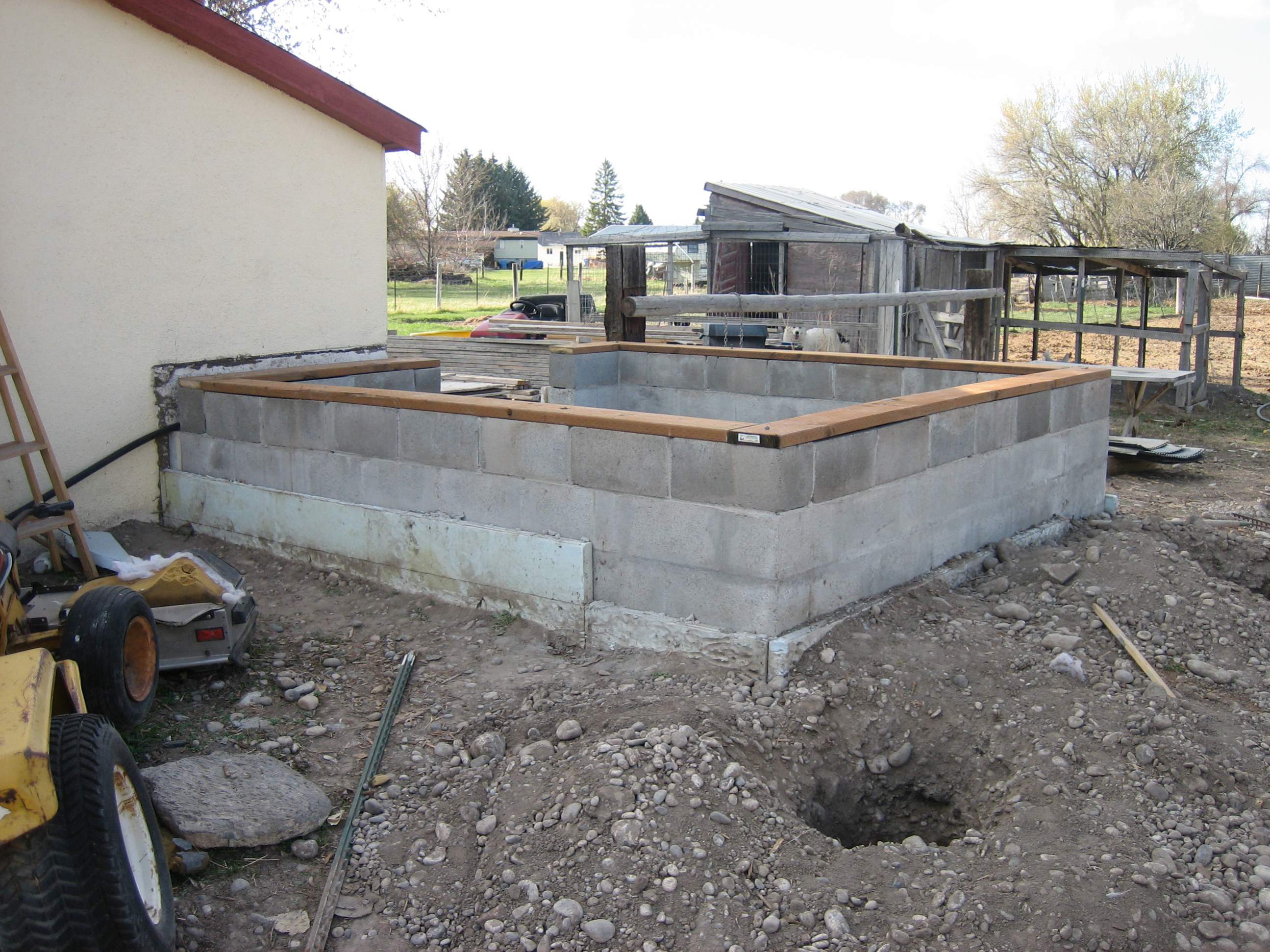

Progress report: I got the last concrete anchor bolt cemented in tonight. I assume that I did a good job on it. It was kind of dark by the time I got done. I'm planning on taking the trailer to work tomorrow so I can pick up the treated sill boards and the floor joists on the way home.

I spent another $170 today on boards for the sill plate and sub floor.

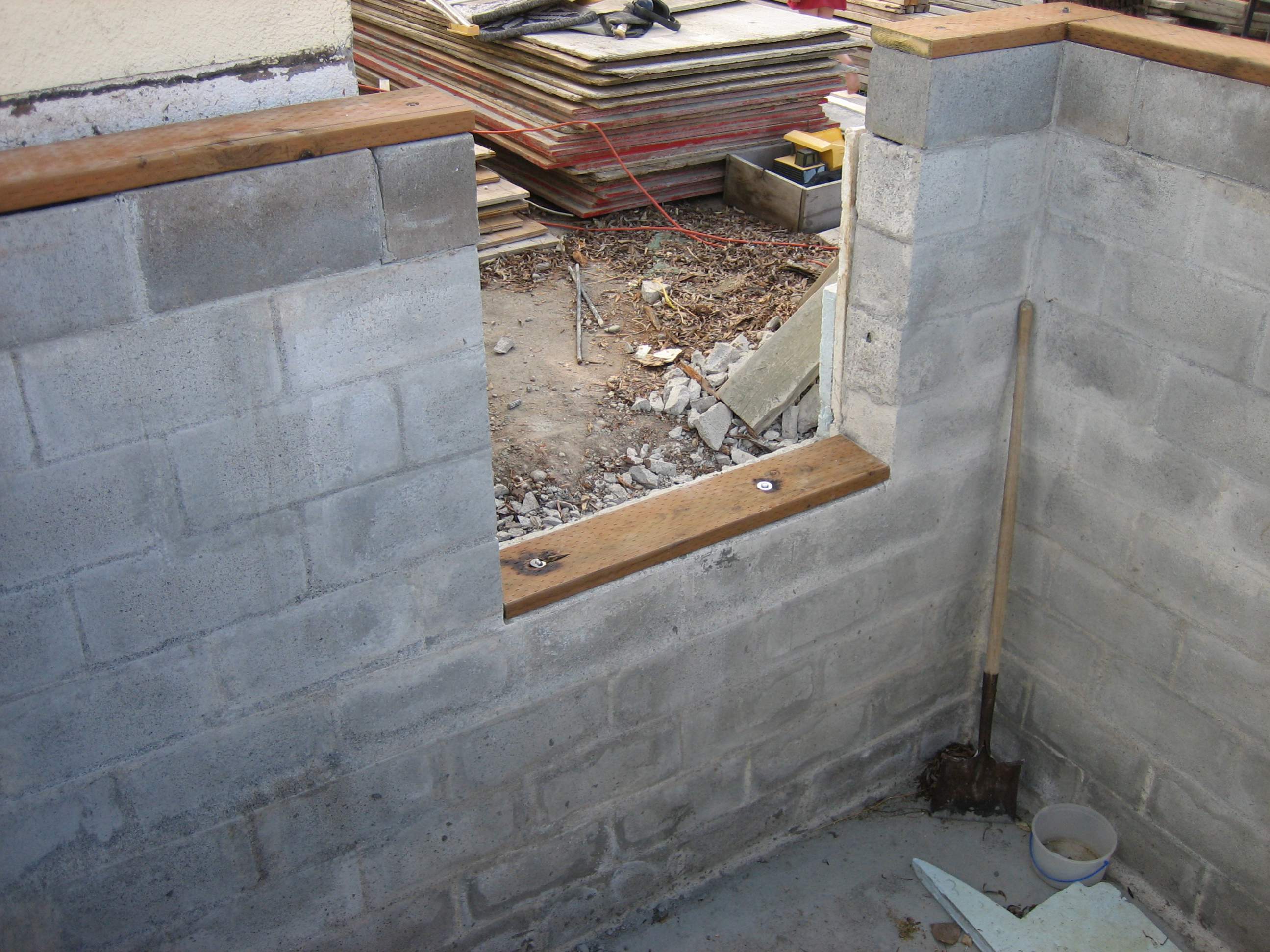

The sill plate is in.
For the base plate on the doorway, I left about a half inch of the rebar sticking out above the treated board. I put 1/2" washers over the rebar and then mushroomed the heads with a maul.
That will work and way cheaper that threaded bolts:thumbsup:

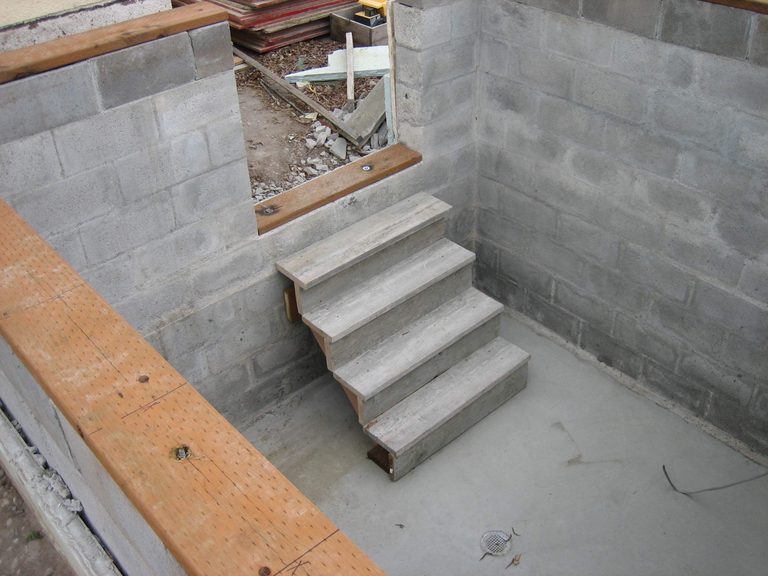

I cut stair stringers tonight. They turned out okay for my first attempt. These will be for the stairs going down into the basement level. I figured it will be easier to install the stairs now before I get the floor joists all in. I also anticipate that I'll do a bit of running up and down these stairs as I put the floor joists in.

The stairs into the cellar are done.
I used old concrete forms for the treads because I'm cheap. But, if anyone asks I'm telling them it's because I wanted the stairs to match the color of the block and the cement floor.
Next Step = Phase 3: Framing.
Hopefully I get some time tonight to start framing the subfloor.
