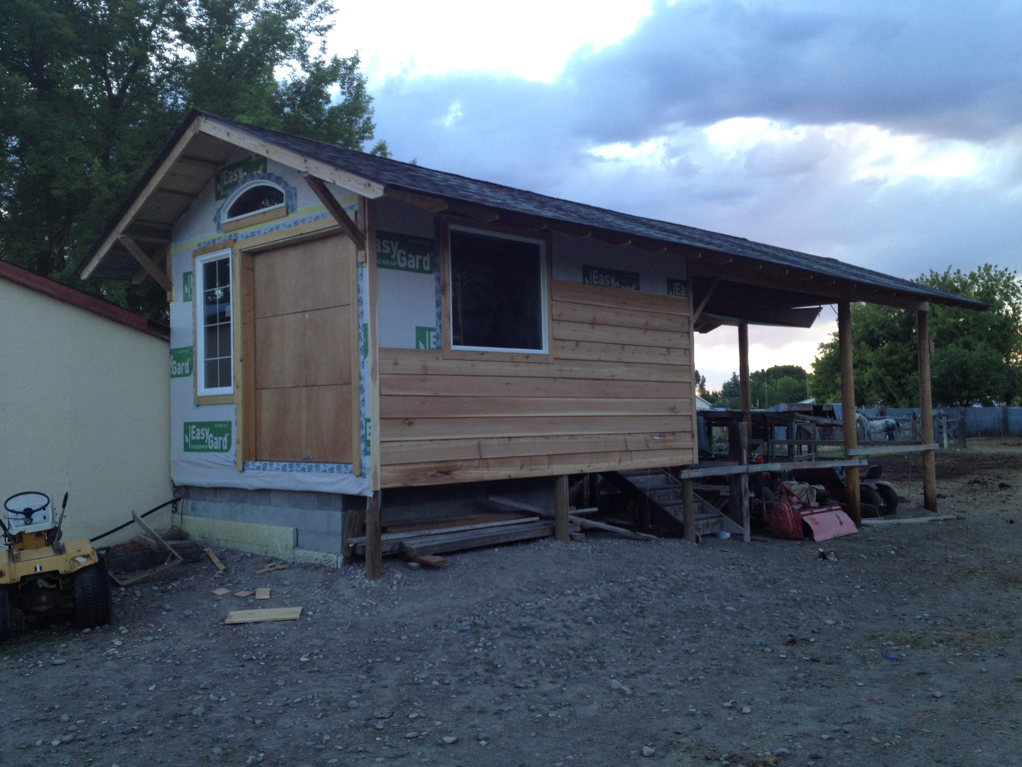

I have hung the first of the siding on the shop. It took a while getting everything ready (trim, etc.), but once I started hanging siding it's going pretty fast. I took the picture early this evening. I've done a little more since then.

Followup picture showing the other 4 pieces of siding that I put up Saturday evening...
I'm hoping for some more time tonight to put up more siding.
