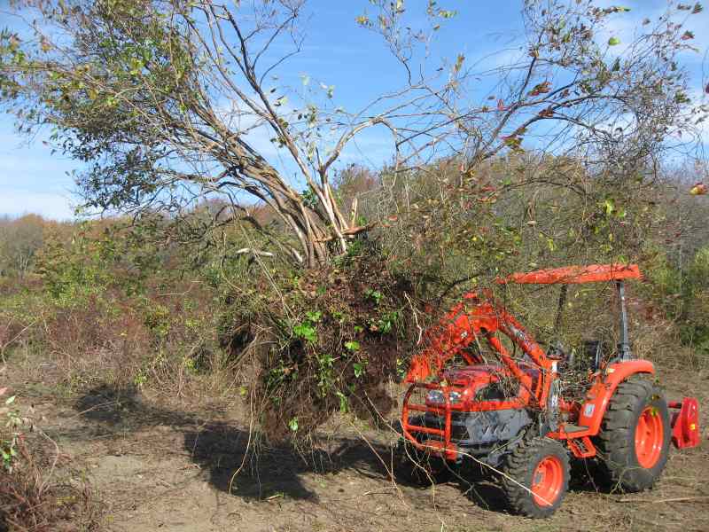

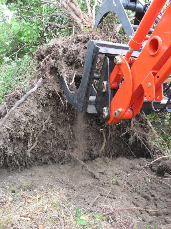

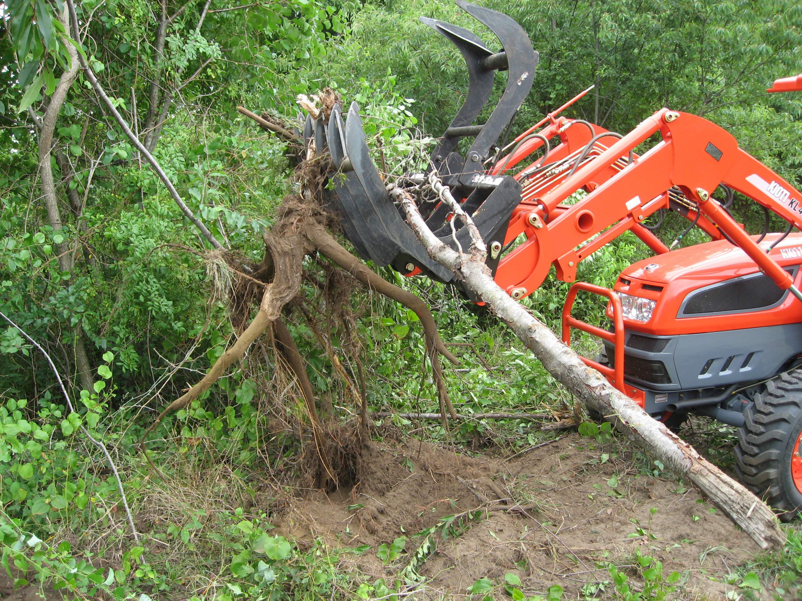

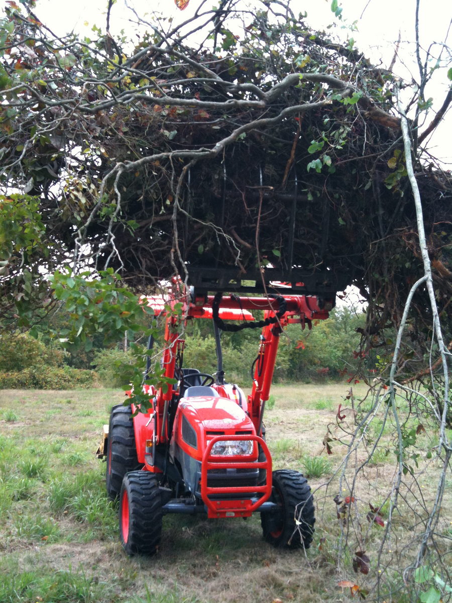

I guess I have to disagree with some of your points. Photos follow.
Grabbing logs is duck soup for virtually any type of grapple other than a bucket grapple and even that works OK. The type of grapple I have easily picks up a full load of logs. There are two ways to load it though. You can try to slip the bottom tines under the log and then clamp it but even easier is to open the grapple full and then tilt it so the open jaws are pointed down at the log pile. Then just drop the thing onto the logs and clamp. I have a photo doing that with loose woody debris.
The grapples are also pretty good at digging out roots. You just don't do it while moving. Drive up to the stump or bush or small tree. Push on the tree/bush to reveal where the main supporting roots are (they will bulge beneath the turf). Next just insert the bottom tines under the root and curl/lift the grapple. Depending on the size of the root/bush you will either pop the whole thing out or for larger trees/stumps you will rip that root and then work your way around the tree until it is unstable and can be pushed over. That technique works up to about a 5 or 6 inch diameter trunk and works with any size bush. The OP has the same loader I do so I know it has the power to rip roots up to about 3 inches in a single curl. Bigger roots sometimes need to be dug up a little further from the stump to rip them.
Brush is very easy to pick up with a grapple but is best done by using the grapple first to push it all into a pile. You then use the open grapple face down approach to squash the pile down before closing the jaws. I can get so much brush in one bite that I cannot see where I am driving!
I think Ken seems to be looking for a bulldozer type root rake rather than root grapple. Trouble is that while the clamshell type grapples do allow easier raking while moving, I still think it is a mistake to use a tractor FEL as a bulldozer. Just not engineered for the strain of hitting an immovable object like a big rock or buried stump while the 5000lb tractor with all its momentum is moving forward. It is especially dangerous if the immovable object is off centerline as that can twist the FEL arms. Tractor FELs are loading devices and are engineered to lift. Bulldozer "FEL" arms are stout, short and much more heavily built just for the purpose of absorbing those types of shock forces.

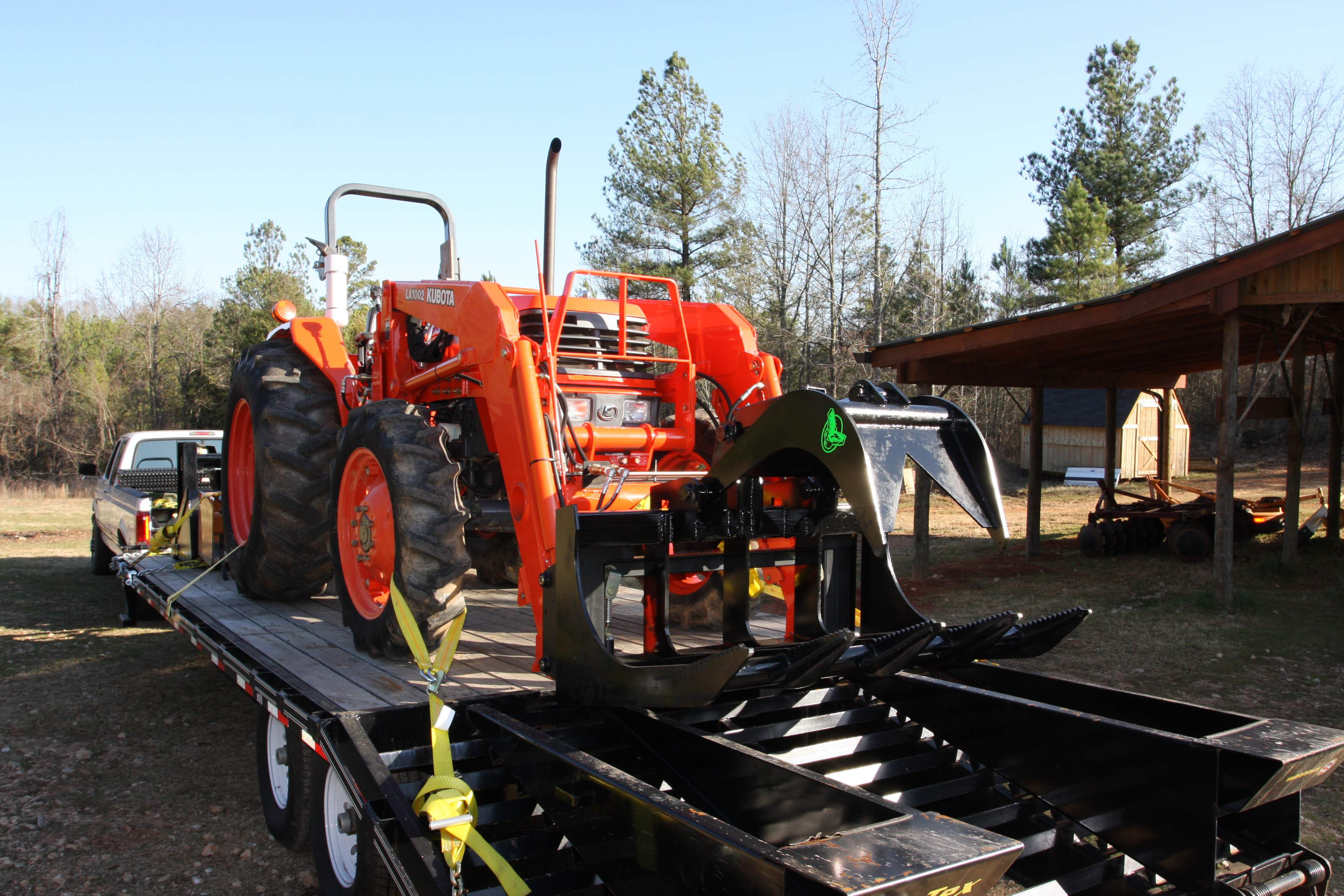

/ Root Grapple? #10
Listen to Island Tractor!! Everything he said is gospel! I also bought a 48" grapple from Markham (like the Wildcat, I think) and it is awesome. Mounted on a 70 horse Kubota, it is a beast for clearing land, moving debris, uprooting trees (up to 6" diameter). Don't get one wider than 48" and one hydraulic "thumb" on top is plenty. All of his pictures say it all. It works flawlessly. I have used my countless hours and made mountains of debris piles.
