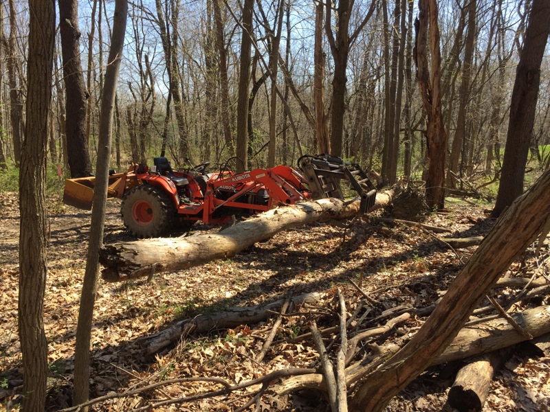

#152
An old poplar that been down for a couple of years.
Probably 30'+ long and 8" to 10" in diameter at the end closest to the camera ... fairly light I would assume:

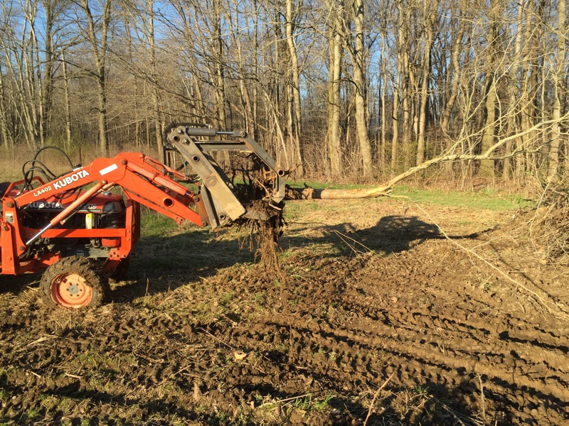

#153
The area off beyond the wood pile is what I worked on today (strictly for testing purposes mind you :D)
It's a small area that grew up with a lot of poplar/aspen, as they intruded in from the woods on my neighbor's property.
The area this side of it is where we used to have a vegetable garden. I'd like to put one in this year, but we'll see how it goes.
It's still pretty wet, especially towards the center, as you can see from all the ruts.

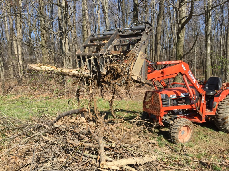

#154
Some type of small tree that I tore out ... use the root rake on either side to cut the roots and then get under it and pry with the curl:

#155
A small hawthorn tree:
