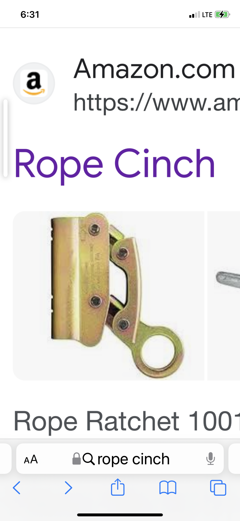

What do climbers use for a safety cinch on their ropes that only allow one way of freedom unless they use some sort of positive release?
I bought the guardian fall protection kit and am not at all satisfied with the mechanism they use because it doesn’t actually lock the rope in place until there is tension on the rope that would happen during a fall.
Here is a picture of it.
I want to decide when the tension is lessened on the rope, I want to squeeze or release a mechanism every single time that I wish to move any perceptible distance on a roof.
I don’t want the stress of wondering how far I gotta drop before the rope gets ahold of me.

Any mechanical device needs to be “set” before it will arrest a fall. It will lock up faster than you think, as long as your rope is properly managed you won’t fall far at all, more likely you’ll feel a swinging sensation as gravity drags you to directly below your anchor more than any falling sensation. If that device is properly rated and from a reputable company I would not worry about the device.

Set up a trial.... Find a tree or pole and set up a "fall" from maybe 2 or 3 feet above ground and see how it performs... You may be surprised...
Any fall protection device that has any friction on rope going up is going to be a pain in the butt to use as you will be having to always work rope through device as you are trying to climb.... IF you don't like it or don't trust it, don't climb...

For fall protection in while following a line over dicey terrain (as opposed to vertical climbing) we often just attach ourselves to a rope with a loop of cord using a prussic knot. Allows us to slide the knot up and down the rope as we wish, and if you fall it locks immediately. This is more for travel on steep terrain, not fall protection when climbing vertical. That is usually protected by a belayer. The GriGri is good because your belayer really just keeps the slack out as it essentially locks down for a fall on it's own (good for new belayers!). I have seen people self-belay on a top rope with GriGri's
The Croll/Ascenders I shared are always locked down to travel in one direction but move freely in another direction (same with the grigri). To move in the "locked down" direction, one has to move the release lever on the croll or ascender.
So if you are worried about falling while traveling in either direction on the rope, then a prussic might be the best solution.
Regardless beware of static ropes and cord when falling. easy to cause pretty bad damage to one's body even with very short falls.

They make mechanical locking devices that slide upwards on the rope but are always locked in the downwards direction, without waiting for weight on them. You have to manually operate them to move to a lower position. When I was a rock climber long ago we called them "Jumars" but they're called ascenders now.
iu
A prussik will work but you have to make sure the knot is tight when you reposition it. They tend to loosen if you're not putting weight on them. If it gets too loose it may not grab quickly when you fall.
