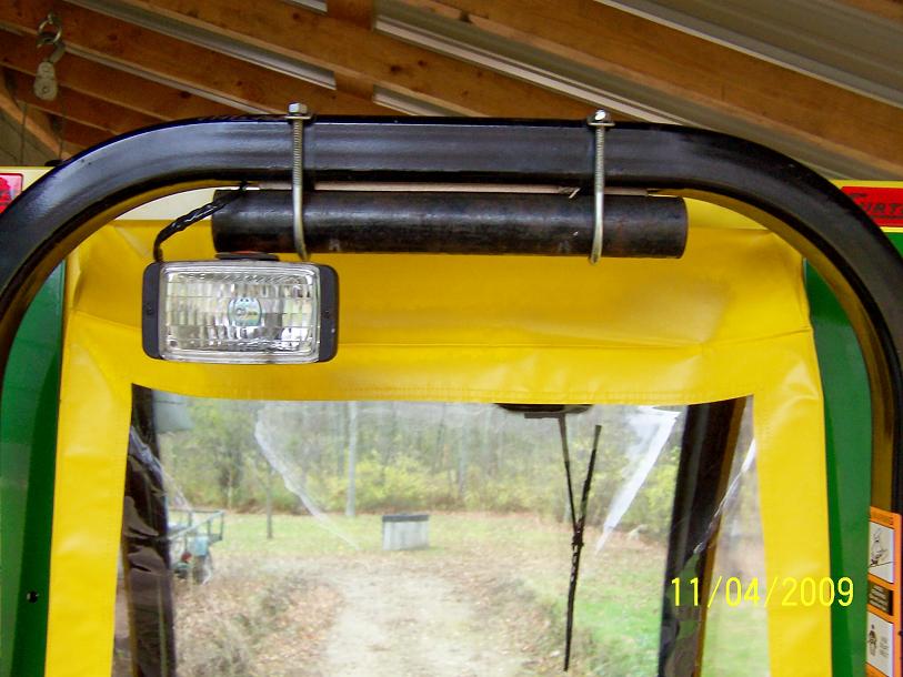

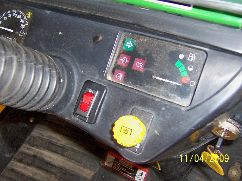

/ ROPS Light brackets #4
A couple of spacers between the pipe and the ROPS allow space to thread wires through existing holes in the underside of the ROPS. Twisting the pipe raises/lowers the beam; the light can be twised left or right. I added a switch on the instrument panel.

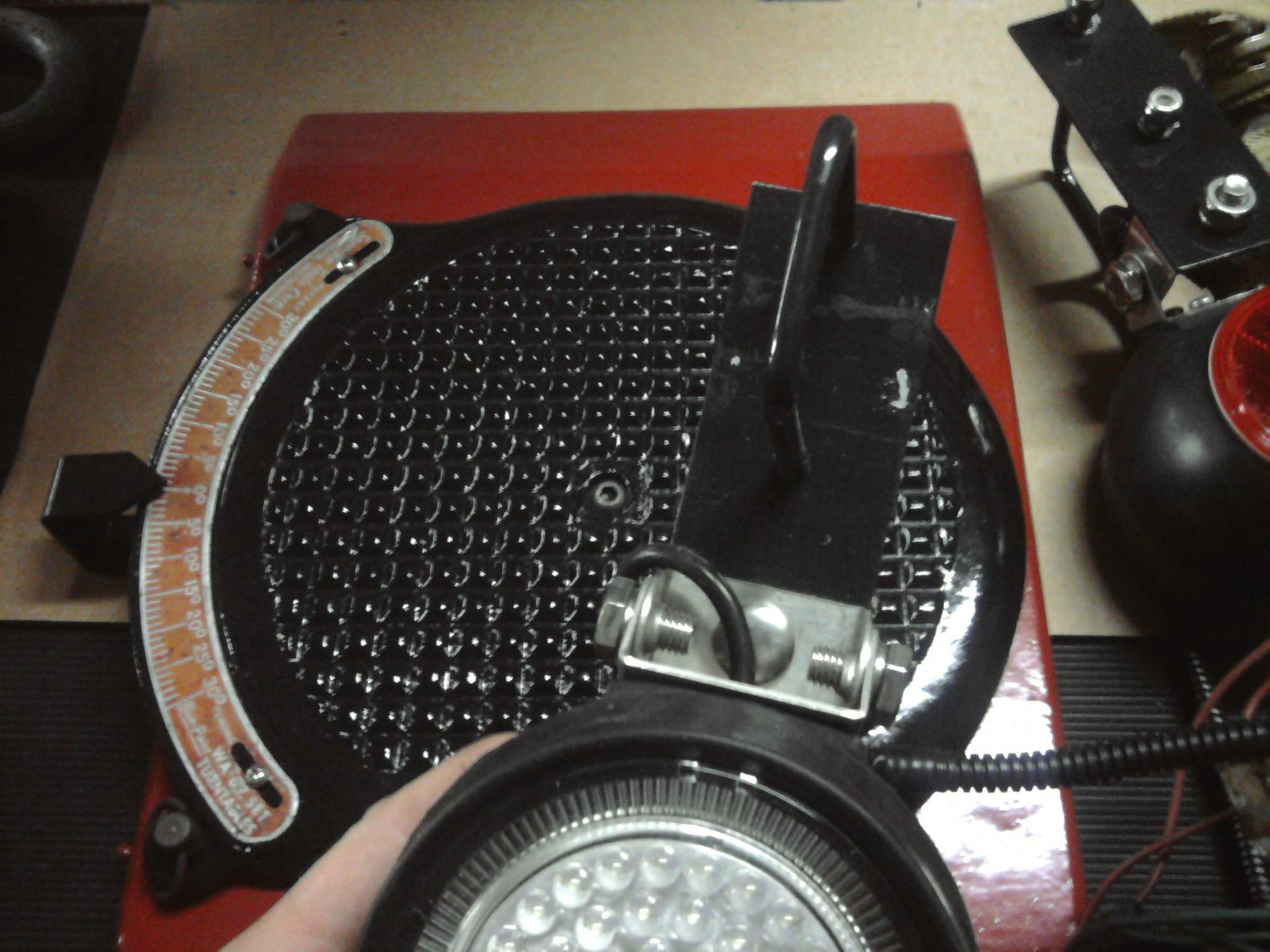

/ ROPS Light brackets #5
Get some u bolts a the hardware store. I took a scrap piece of aluminum and made a piece for the light to clamp to.

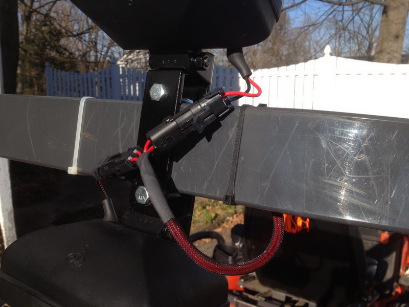

not the best pic, but here is what i did. just two pieces of flat stock that 'clamp' over around the ROPS. i placed watertight connectors at each fixture as well as one at the folding point of the ROPS for easy removal. i run four lights in total - front pair is on one switch and the back pair is on another.

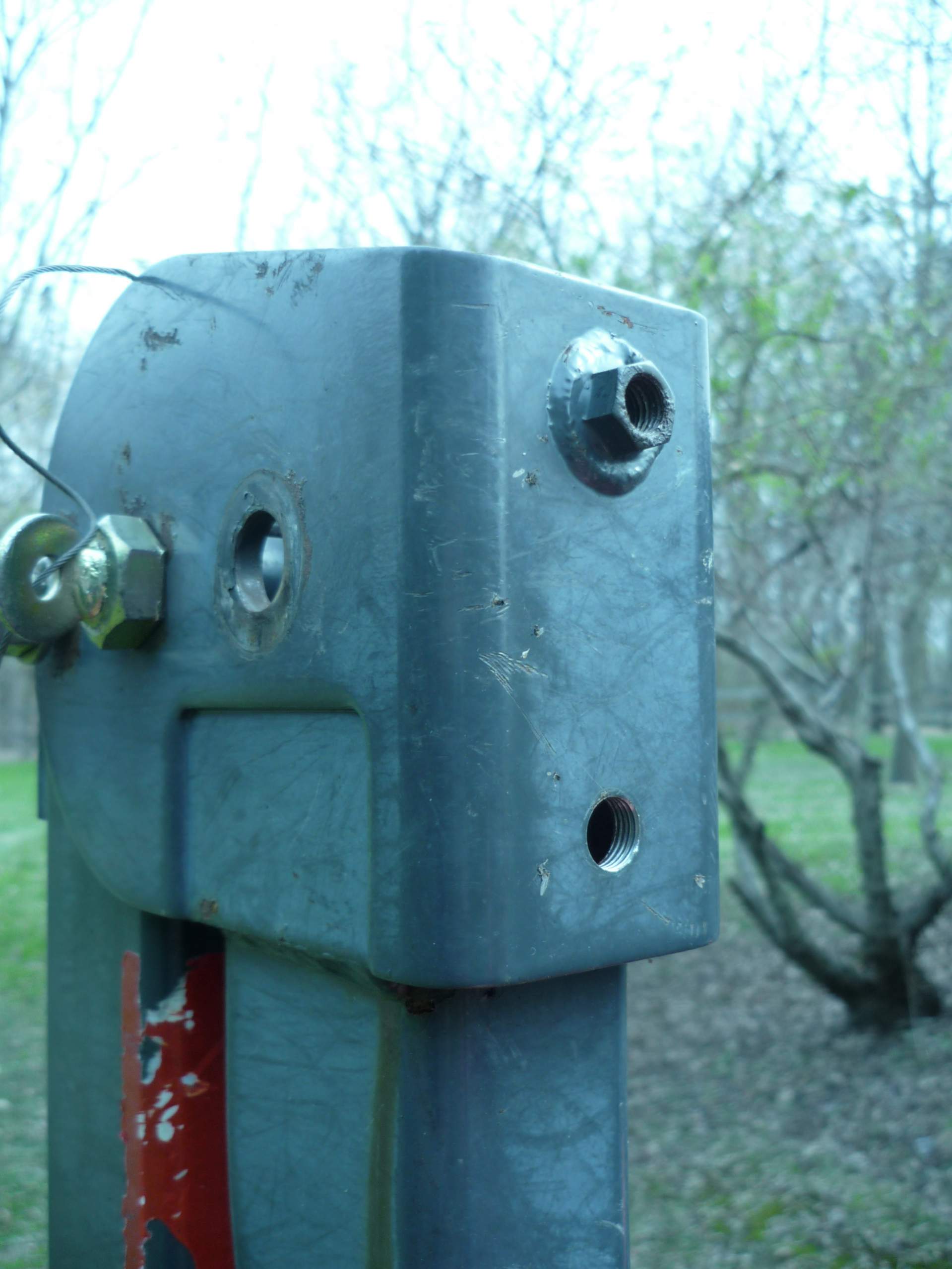

If you have a Kubota with a folding ROPS, there are threaded bosses on the front of the ROPS near the hinge line. It's a standard metric thread. You can attach lights or brackets to that point directly with very little fuss. No need to fab up a complex bracket or clamp into the ROPS.
The bosses are intended to be used for a set screw to put pressure on the ROPS and prevent rattles, but I don't think I have ever seen that done in real life. So that leaves two nice threaded attachment points for things like lights, etc.
That is some nice work and great idea I will be doing the same!!! I wont be folding mine much but I still like the option to fold it if I need to with that plug one can fold the ROPS with a simple unplug. Thanks HeLA!!

I like those protective "boxes" around the lights... I have thought about doing the same, but using some 1/4" x 2" bar stock. And those anti-rattle bosses that s219 mentioned work fine- just how I mounted lights on my L3130, but if I remember right, I drilled and tapped another hole below as well, and make spacer plates out of some old Bakelite sheet.
