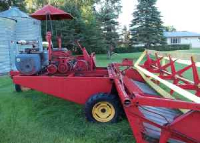

I have just the tool for you it is cheap! But you will need a building to keep it in :)
It is a swather. Based on a sickle bar mower mounted in front of a platform with reels to push the grass into the cutter. These old ones have canvas conveyors with wood slats to move all the grass to the center and form a windrow which can be baled or collected with a dump rake. No grass in the pond. The down side is that the platform is 16 feet. Is that a show stopper.
