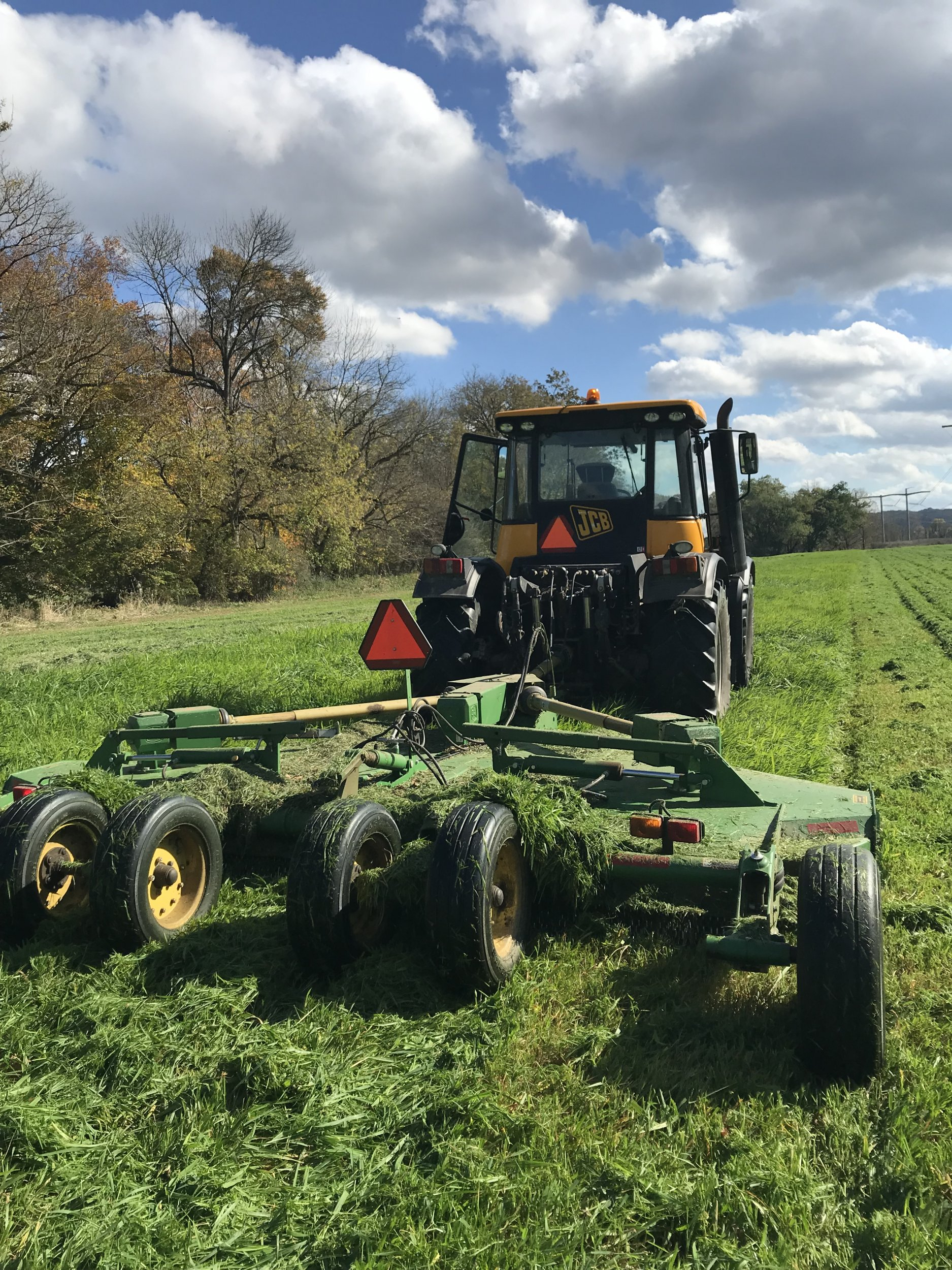

Batwing.....the extra width allows you to mow close while keeping the tractor safely away from objects.
   / Rotary Cutter Driveshaft failure. Your suggestions. #22
Wow that thing is a beast!
I'm guessing it has a slip clutch?
It looks like you got good use out of your old cutter. This new one will last you a very long time, the old ones life is limited so what would you do when its not worth repairing which is probably not too far off and the batwing will probably just be more expensive then. Besides, I think the color of the batwing is a better match for your new tractor!

I called my dealer that I just bought the tractor from and he had a Titan 12 foot batwing for $13,000 in stock.
I'm debating if I should buy the bigger mower or keep fighting with the one I have. 19 year old light duty 6 foot cutter or a 12 foot cutter rated for 2 inches that will fit my 70 HP tractor better? View attachment 751736
Go for it. You can make money with it, too.
Once you get into field mowing, you won’t want to do construction any more.
Ask me how I know…. :)
Might want to see if he can swap aircraft tires on it, so you can drive to your locations, unfold and mow. :)
