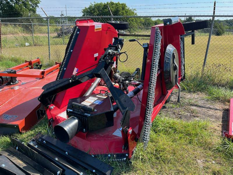

I called my dealer that I just bought the tractor from and he had a Titan 12 foot batwing for $13,000 in stock.
I'm debating if I should buy the bigger mower or keep fighting with the one I have. 19 year old light duty 6 foot cutter or a 12 foot cutter rated for 2 inches that will fit my 70 HP tractor better? View attachment 751736

The Titan Flexwing can be operated with 1 remote. That is one of their selling points. So at least you do not have to add any more remotes to use it.
I say get the mower. New tractor deserves at least one new implement.
I was looking at their website and some YouTube videos and I'm wondering if there is any advantage to using two remotes? I've never had a batwing, so I'm just guessing, but I can't think of any reason that I'd want to lift the wings and not lift the wheels. I'm not taking it off of the land, my insurance is very clear that it's only to be used on my land and nowhere else. I have some 12 foot gates, so lifting the wings to get through the gates would be the main reason to do this, which will also lift the wheels. Otherwise, why would I want to connect to the second remote?
