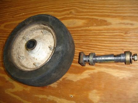

I can speak from experience, be sure to grease the wheels with plenty of grease when you do. I just had to replace all four wheels on my rhino finish mower. I greased them on the ten hour schedule, but did not put more then one pump of the grease gun in each wheel. You can see the wear marks on the axle bolt in the pic. On that same note, is there an advantage to using pneumatic tires over the solid tires? I have very level ground without anything obvious to cause flats and my thought is the pneumatics would stay inline better than the solid rubber tires and create less divots on the grass.
