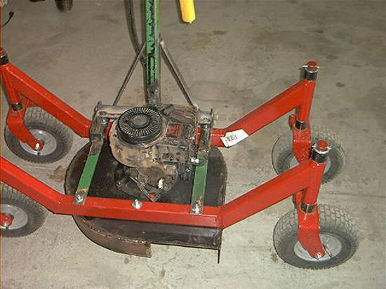

Are you thinking about something like for the spindle and wheel set-up? You reckon they would hit your tires? I believe this was designed to cut banks/steep slopes.
Well not exactly. I plan to use 8.5 or 8.75 in diameter solid rubber tires. in their going straight position they will be almost touching the cutter deck. I plan on measuring it up this week end to check for turning clearance.
By the way, what is that, a leaf blower?
Russ
   / Rotary Cutter Modification #13
A two stroke engine mower for cutting banks and slopes.
