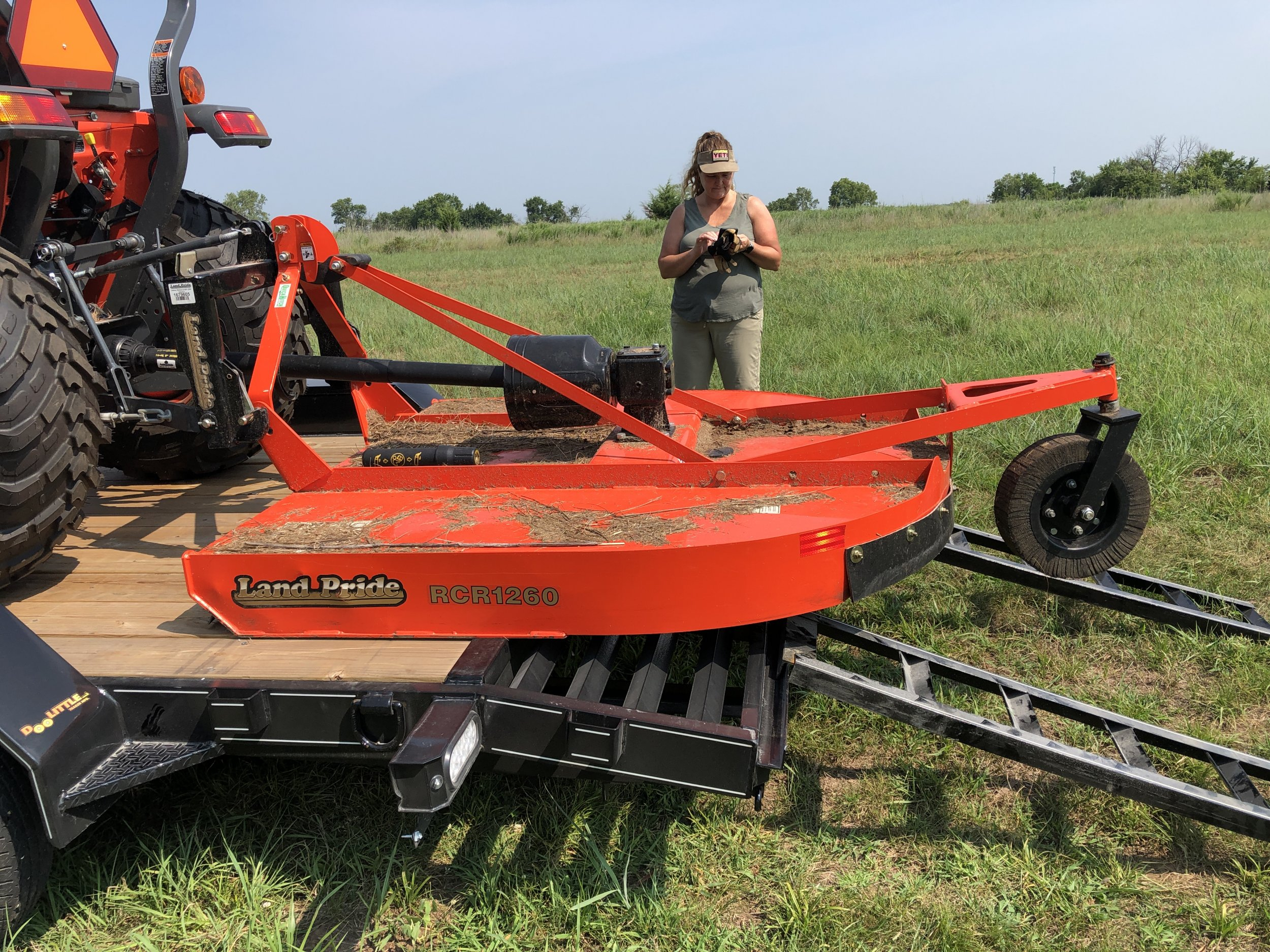

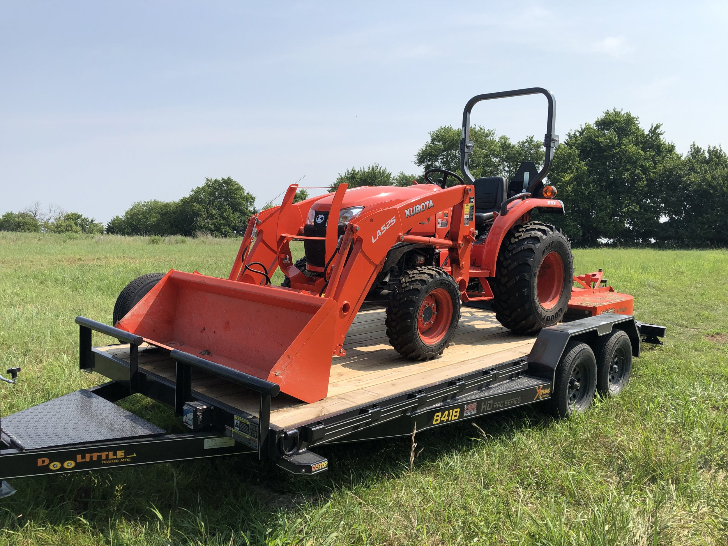

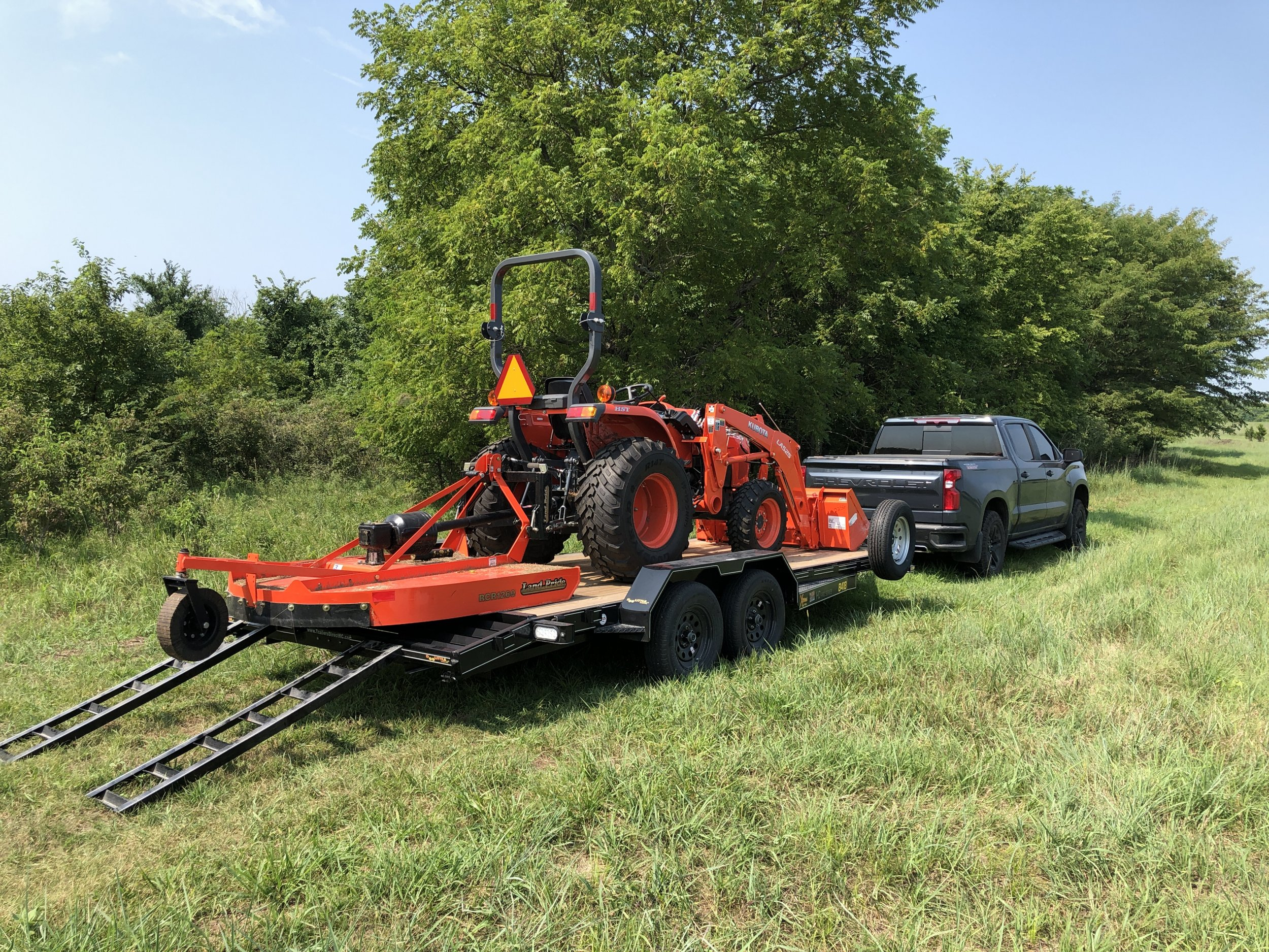

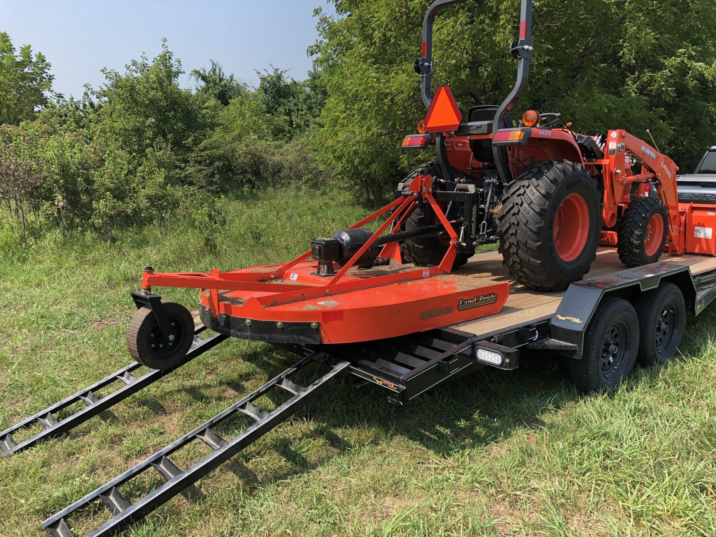

Recently bought a Doolittle 18’ (16’ + 2’ dovetail) equipment trailer. I figured that my rotary cutter would stick out past the trailer some, but should I be concerned? My tie down plan is 4 points on the tractor with 5/16” grade 70 and ratcheting binders with a 2” strap over the bucket and 2” strap over the rotary cutter. I have corner protectors for the strap. I will also be attaching a red flag to the rotary cutter wheel. I think I’m okay here, but looking for 2nd opinions by experienced tractor owners/haulers. BTW, the silver spare is getting swapped out for a matching black one by the dealer, they just didn’t have a black rim when I bought it. I had TPMS monitors installed in all four tires and the trailer pulls like a dream empty. I plan on using it to occasionally haul my tractor and I plan on building some side boards to haul mulch and topsoil and other odds-n-ends.
Way too short of a trailer sell it and get a 20 foot 10k
