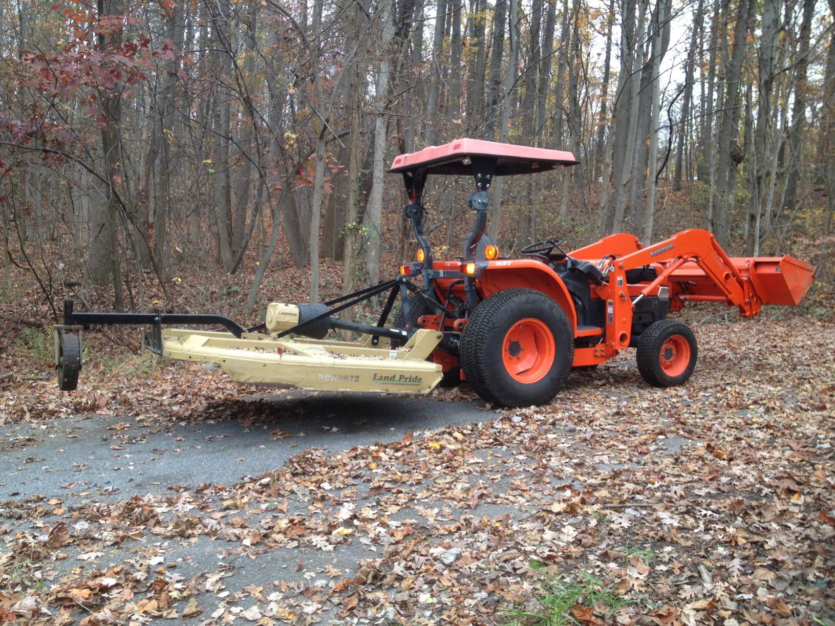

Sorry for waiting so long between posts, but shortly after starting the thread my need went to zero in a hurry. You see, I only needed this to maintain some trails where we allowed our dog to run free. Unfortunately a very fast growing tumor stole him from us. How a very healthy dog with no symptoms can go from 100% one day to being consumed with a massive tumor that the best surgeons couldn't remove is still painful nearly 5 months later.
Flash forward...
After adopting another rescue dog I stumbled on a barely used LandPride RCR2672. It's big and heavy and does what I need.
Thanks for all that shared their advice in this post.

Here's a picture to complete the thread. I don't think I mentioned this earlier. It has a PTO slip clutch.

That is too bad about your dog. I've been through a lot with my 3 and have come close to losing 2 of them. Anyways, congrats on the mower, that is a great mower from what I have read on here (no personal experience).
I had been searching for a used heavy duty brush hog for a while, and the RCR2672 was one of the 4 or so I was looking for. I finally found a Brown 472 which is similar, and let me say, it is incredible the difference between my old Woods BB60 light duty model, and this cutter. I never knew difference would be so great. You made an excellent choice!
