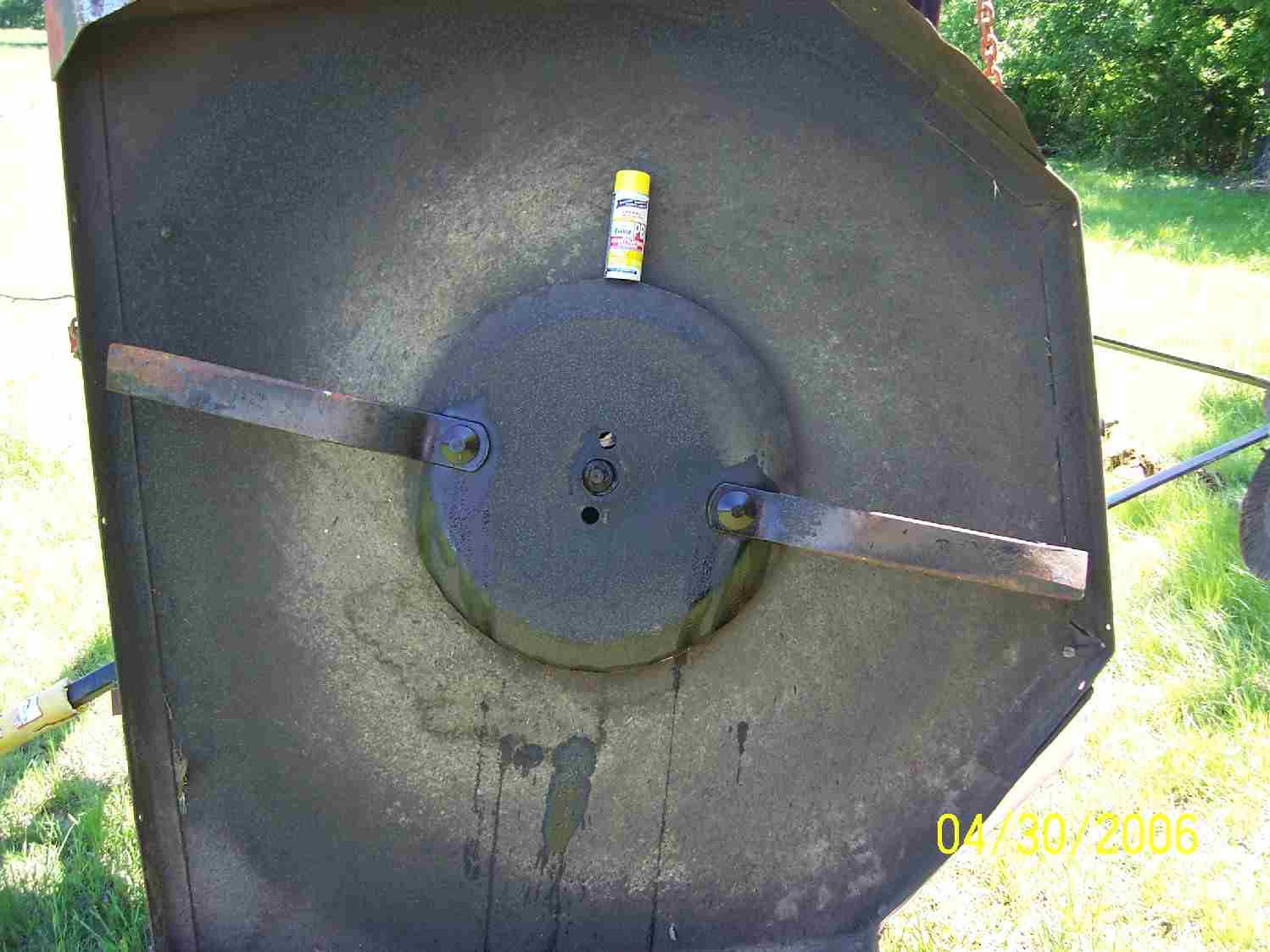

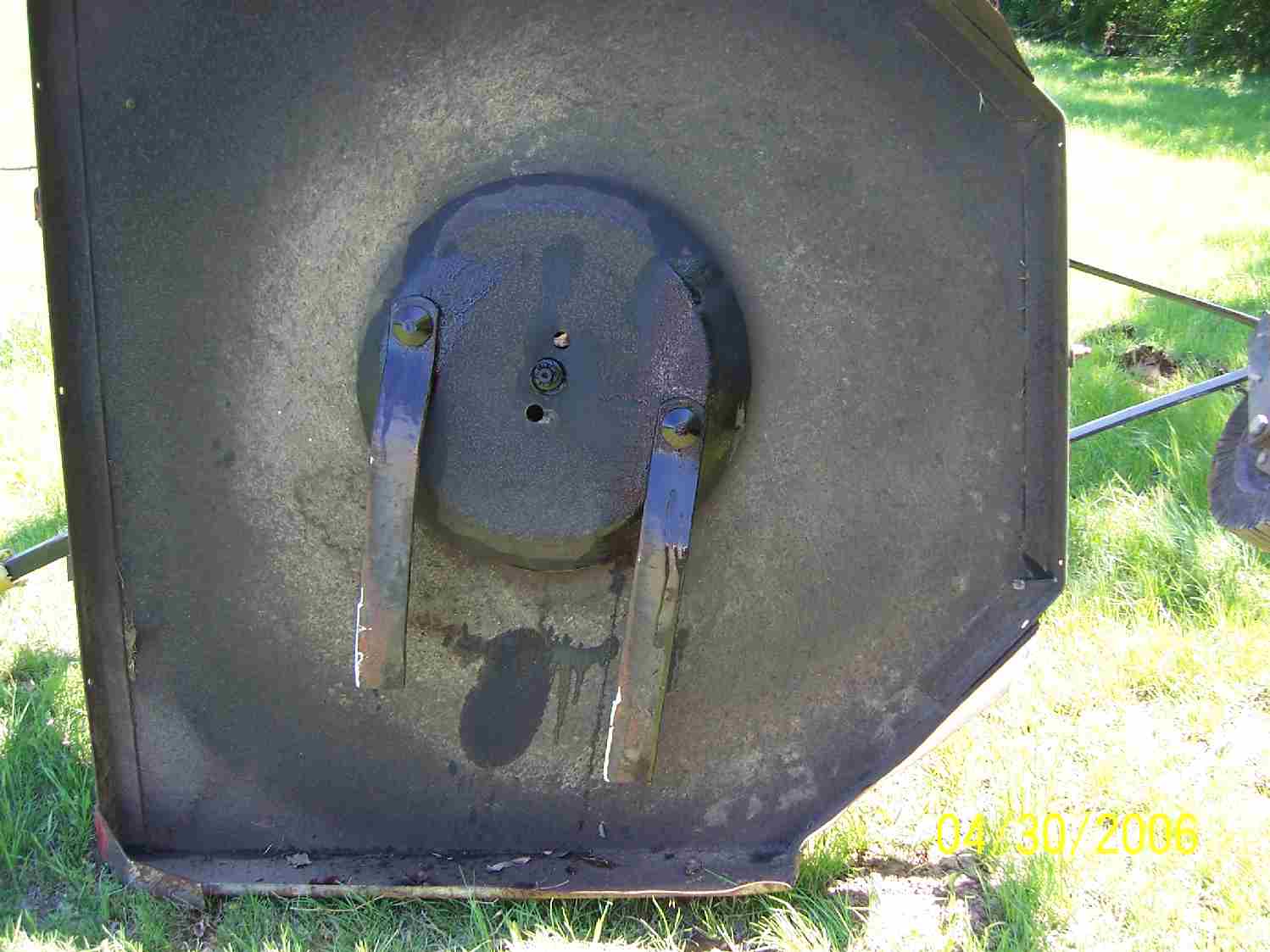

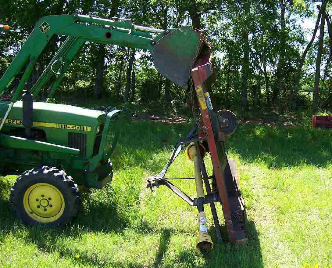

Here is the underside of mine before I freed up my blades and afterward.
Third one shows how I got the pictures.

Thanks for the pictures they are exactly what I was looking for.

They are very durable. The more expensive ones have what is called a stump jumper on them. It is a steel, bowl shaped part that covers the bar where the blades attach. It allows the bar and blades to slide over stumps, rocks, ridges of dirt etc..
/ Rotary Cutters? #8
Looks like Jay was posting the same time I was. You can see the stump jumper in Bills pictures. I was letting Linky pull up all three pictures while I was posting and hadn't looked at them yet.

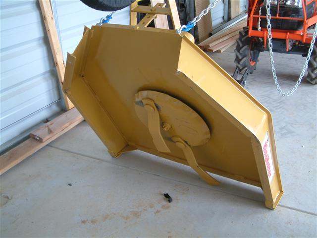

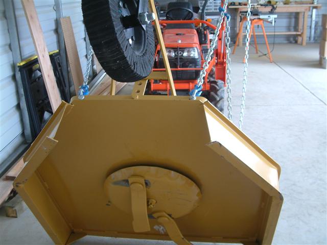

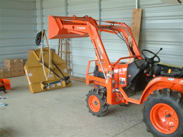

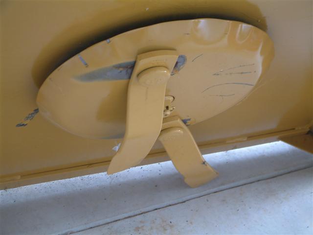

Here's a few shots of my new 48"-wide KK brush hog after I unloaded it from the F150 pickup with my Kubota B7510HST/LA302 FEL.

Both BB TX and flusher have examples of good rotary cutters; both models have a blade pan/stump jumper to which the blades are attached and rotate. Some stump jumpers are elliptical rather than round and there is some reasoning behind that design to which I can not remember :(. My brush hog that died did not have a stump jumper it was a straight bar from which the blades were attached and rotated. I did manage to bend it slightly which did affect the balance somewhat (and killed seals), but it was baling twin that finally did it in :(. It is interesting when two members post simultaneously. Jay
