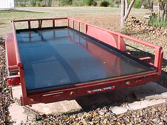

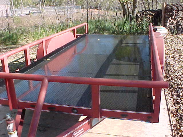

When I went to check on progress yesterday, the old boards had been torn off already. The boards were pretty ugly, but I don't have a picture to show just how bad they were.
The shop finished their work this a.m. and the trailer is now back home. I have a few pictures to post.
Okie G

A shot from the front. Some touch-up on the red paint will get done, maybe this weekend.

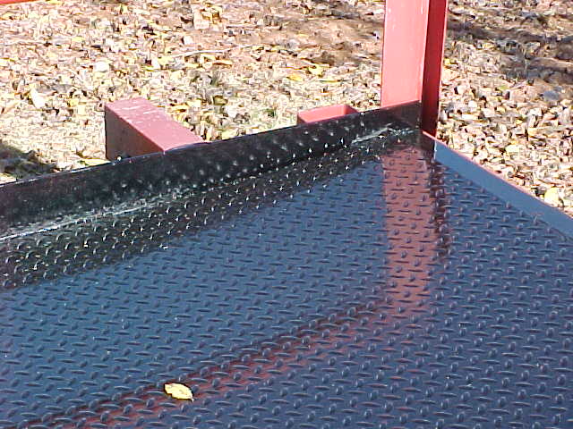

#47
Leo,
This shot shows that the bed is definitely not flush with the sides. It also shows the ramp up at the last foot of bed.
These "compromises" are give-aways to the trailer's true heritage. I'm sure the bed could have been blocked up to be flush with the sides, but what the heck. I don't know if the extra cost would be worth it to me.
By the way, there are braces at each seam and another about midway between the seams. The midway brace on one sheet is spaced at about 1 foot from a seam and 3 feet from the next seam. The other mid-braces are pretty well centered. I'll keep an eye on the 3 foot span for signs of give or sag. Thanks for the tips.
OkieG

   / Rotten Trailer Boards #48
That's a nice looking trailer ... I see how they ramped it and if it's welded as good as it looks you probably have nothing to concern yourself about ... what's the load capacity of the trailer?

   / Rotten Trailer Boards #50
they did a nice job. the little wall around the edge will keep things from sliding off. Get back to us after a while on how this decking works out, compared to the wood deck.
