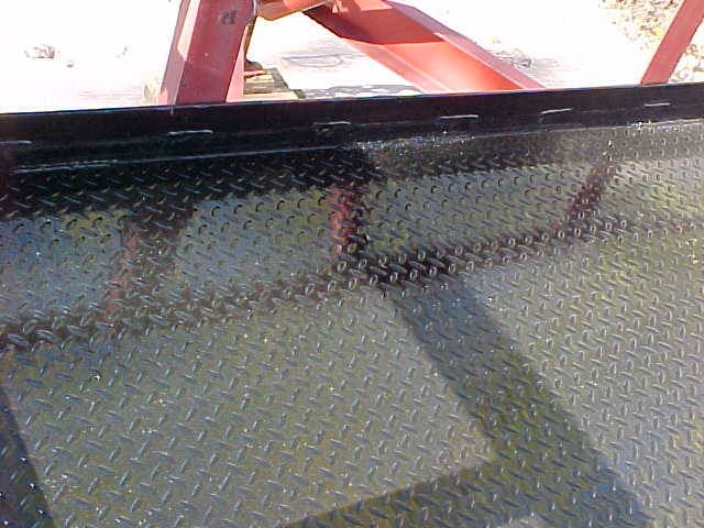

I only see one problem. It appears that water could pond in there with no place to go. Maybe drilling a couple of 3/4" drain holes in several places would correct that.
   / Rotten Trailer Boards
#52
Russ,
I had that same thought. However, the steel is not welded with a continuous weld around the edges. The welds are a few inches long, then there is a stretch of a foot or two before the next weld. I was planning on just drilling drain holes in the corners, like you suggest, but I may just wait and see how water tight (or most likely not water tight) the flooring is. The drill is handy if needed.
In the picture, the broken welds on the wall a couple inches above the bed is where the lip was that held down the boards at the front of the trailer. You can, also, see the intermittent welds securing the new steel bed. Those unwelded areas inbetween might just let water pass.
OkieG

I sure like the looks of that trailer. If you're concerned about the three foot span now you might want to go ahead and weld another support piece in the middle of it while it's still smooth and flat underneath. If it were to sag later you'll have a lot more work involved in supporting it then.
Besides, if you do it now you'll never worry or wonder about it. If you don't, you'll spend way too much time over the coming months and years wondering if and when you'll have to do it. It's part of that ounce of prevention thing. /w3tcompact/icons/smile.gif
   / Rotten Trailer Boards #54
I don't think you will have any problems with water even if dirt stops up the drainage in some of the "unwelded" areas ... Gary has a good point about the long span bracing ... by correcting this now failure will not occur...

Gary and Leo,
Just bought a length of 2x3x1/4" angle iron for braces. Will probably weld tomorrow. When I'm done, the widest span will be about 2 feet. Is that close enough so there won't be a sag problem? Gary, how far apart is the bracing under your trailer? I haven't looked under a trailer with original steel flooring to see the bracing interval.

Without going out and looking (the trailer is at my property, I'm at my office) I'm going to guess 24" centers. The sheets are 4' x 8' so the only reasonable alternative would be 16" centers and I don't think they're that close together. I'll look tomorrow and, if it's anything other than 24", I'll post the correction. Otherwise, just assume the 24" is correct. /w3tcompact/icons/smile.gif

Thanks Gary,
The picture of your trailer seems to show a nice flat bed. If 24" spacing is working for you, all should be well here, too.

I think that you will have some "sag" but only where you have continuous concentrated load, i.e., where the tires are when you haul your tractor... that's kinda the nature of the beast and if it is not a lot I would not worry about it... if you want to make sure it does not sag then brace (the angle you mentioned should handle that) those areas so that the brace is as near the point of the load (somewhere close) ... now to the slippery part ... Personally, I would not add the spray on bed liner material to the trailer bed and I would not try to seal (or waterproof) the trailer any more than to paint it to slow down the rusting ... remember it's a trailer and trailers live to haul stuff and stuff scratches and marks and tears through paint on trailers ... and given reasonable maintenance and care your trailer will last a long time .... if you seal the edges and cause the water to "pond" then watch out for rust because there is no place for the water to go (unless you drill holes to allow it to escape). If you are in an area where salting of roads is a problem then you may want to seal the edges top and bottom to prevent salt from getting into those small places here rust would form ... but it is hard to get into those very small opening that water can get into and coat the surface of the material but certainly a coat of sealer or paint is probably the best we can reasonably do …
Remember it's a trailer to haul stuff....
