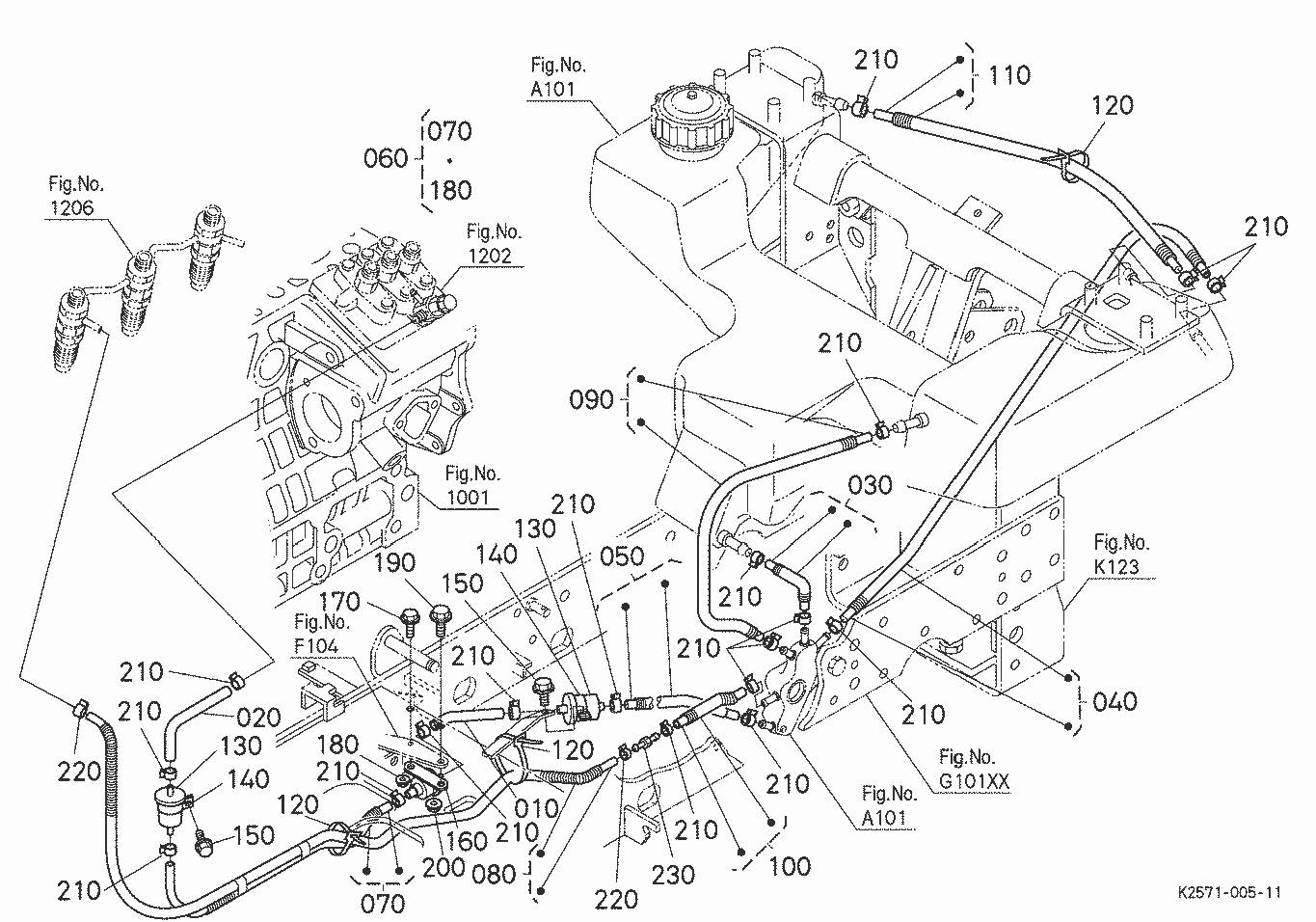

I'm having the same problem with a bx2230, but with a complication. The BX22, 2200, 2230 & 23 all have a small second fuel tank mounted on the frame below the main tank. This small tank is fed from the main tank, feeds the fuel filter and pump, and has the return line from the engine. It also has two vent lines back up to the top of the tank. If the sender has rusted, then both tanks will need to be cleaned. And if you're trying to blow rust out on one of these models, you may have to blow back from fuel filter and also blow back in the line between the main and second tank. Just blowing from filter back to second tank may not clear main tank as some or all air would probably go back up the two vent lines rather than into the bottom of the main tank. You can see what I'm talking about on attached parts diagram of 2230.
/ Rough Running BX #68
Are you referring to Fig. No. 101????
I don't know what it is called. It just seemed like a pass-through / Y in the line. I would never have called it a fuel tank, though. I was looking at mine during my mower height control thread. It was a real pain the rear to get in there and I debated pulling this thing out, but was afraid to do it because there were so many lines onto it I was sure I'd screw it up.
/ Rough Running BX #69
Are you referring to Fig. No. 101???? ... I would never have called it a fuel tank, though.
Yes, A101 on the diagram. I would never have called it a fuel tank either, but that's what it's called on the Kubota parts list. It is a PITA to get at and is an octopus of fuel/vent lines (five total). I've never figured out why it's even there. The first time I saw it under the tractor, I went to the parts breakout to see what it was. Couldn't figure out why anyone would ever add that much complexity to the fuel system. Later models did away with it and just plumbed the main tank dierctly to the filter and the return line back to the main tank.
Regardless of what its called or its usefulness, it's a small container (~1/2 cup) between the fuel tank and the filter that can also get clogged with rust particles.

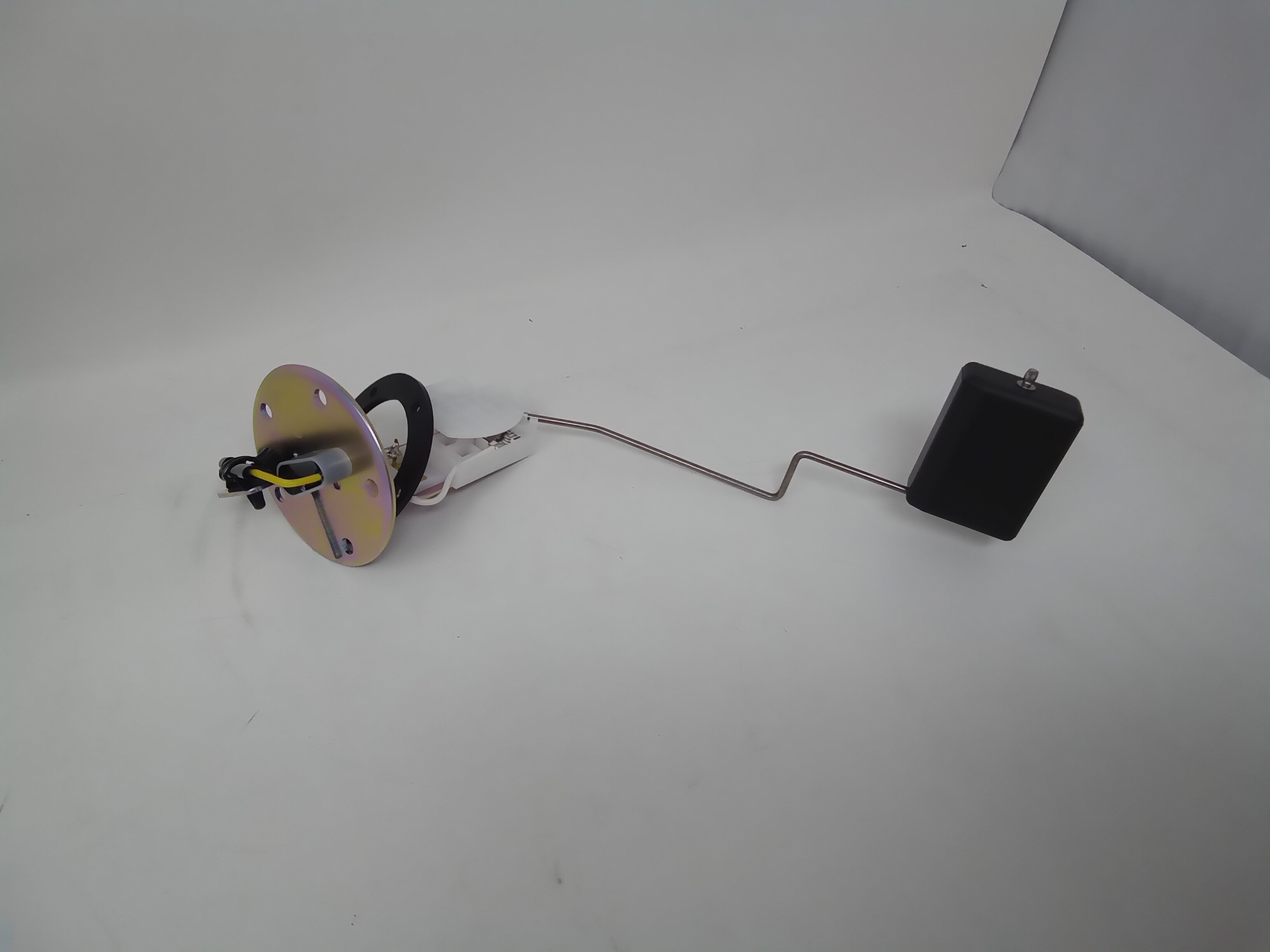

I'm glad I found this post. I just purchased a used BX 2350 and it ran great for a while and it started to sputter and stall and not run at times.
The first time I thought it was water in the lines so after blowing out and checking the filters I didn't see much water coming out so I ordered filters and replaced them both.
Well that last a little while and it started again, so I decided to replace the rear filter even though it wasn't clogged and got my grass done that day but it started to sputter under a load so fir sure it's not the filter.
I didn't think to try and blow the line back into the tank but I will now.
I'm 100% sure its the fuel gauge sender rusting and causing a issue with fuel starvation I have a funny feeling.
A new sender is like $134 :sick: :mad:🤮 not including shipping so if that's the case I will remove it cut off all the metal and not replace it for that much $ that's crazy.
It's not made of gold is it instead the new sender looks like plastic to me - I can look in the tank to see when fuel is running low - LOL
I saw someone who cut a hole in the tank under the seat to access it and clean it I was thinking of doing the same thing but if its the sender it would only temporarily solve it.
He installed an access port to make accessing the tank for clean-out while in the tractor.
If the sender is bad the only thing to fix it for sure is tank removal and replacing the sender or doing away with it.
I plan on digging into it over the next few days wish me luck :);)

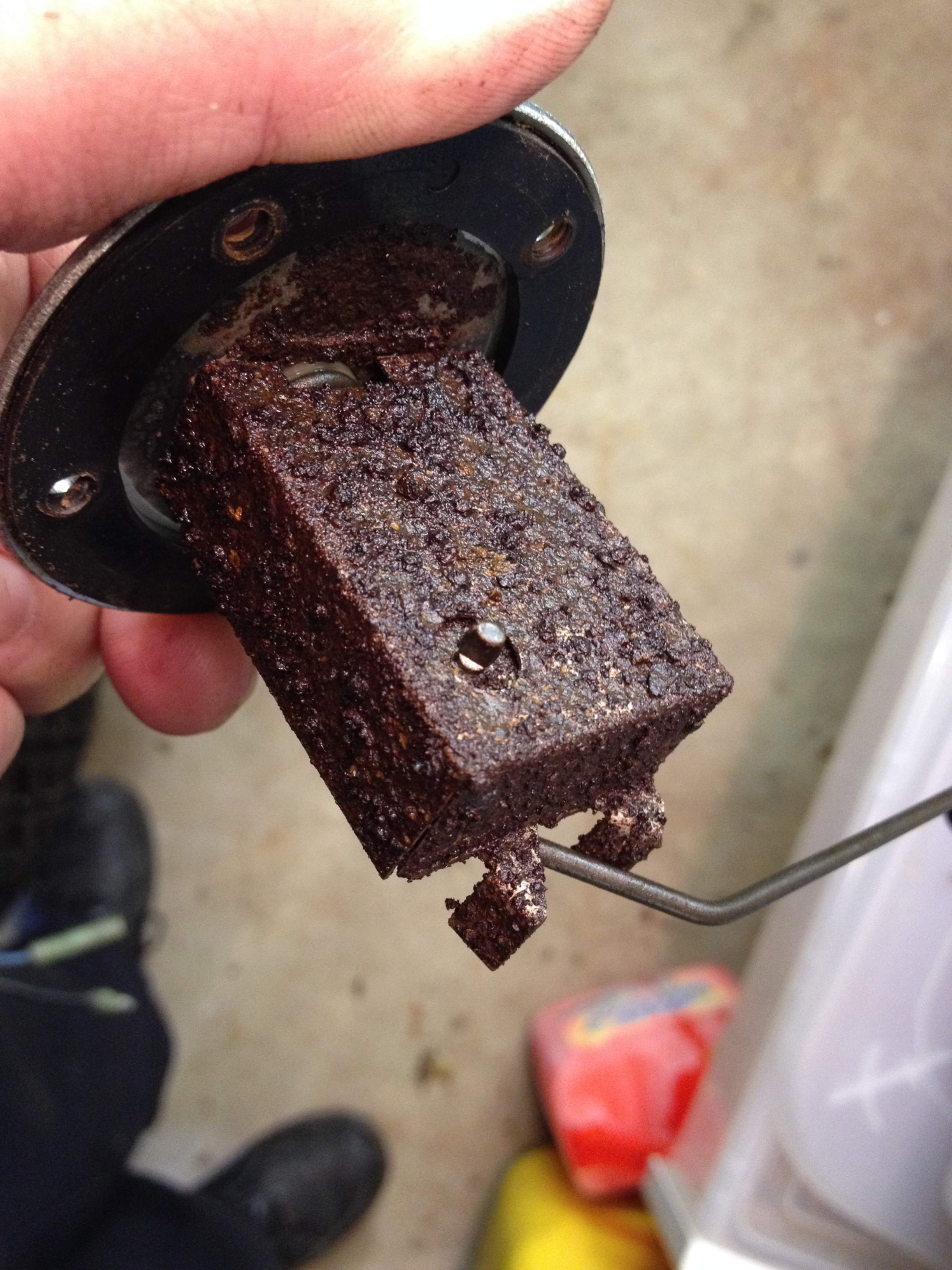

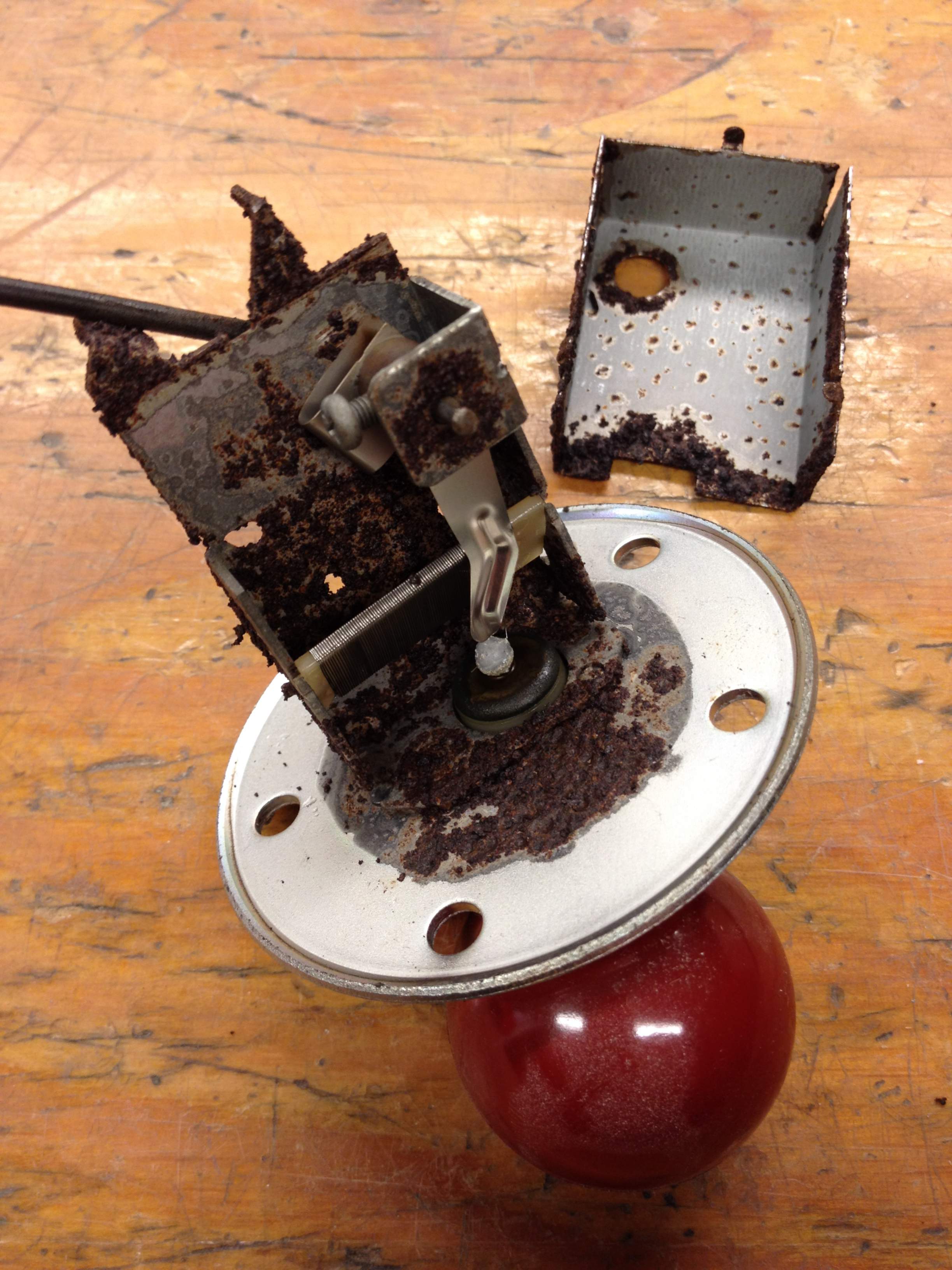

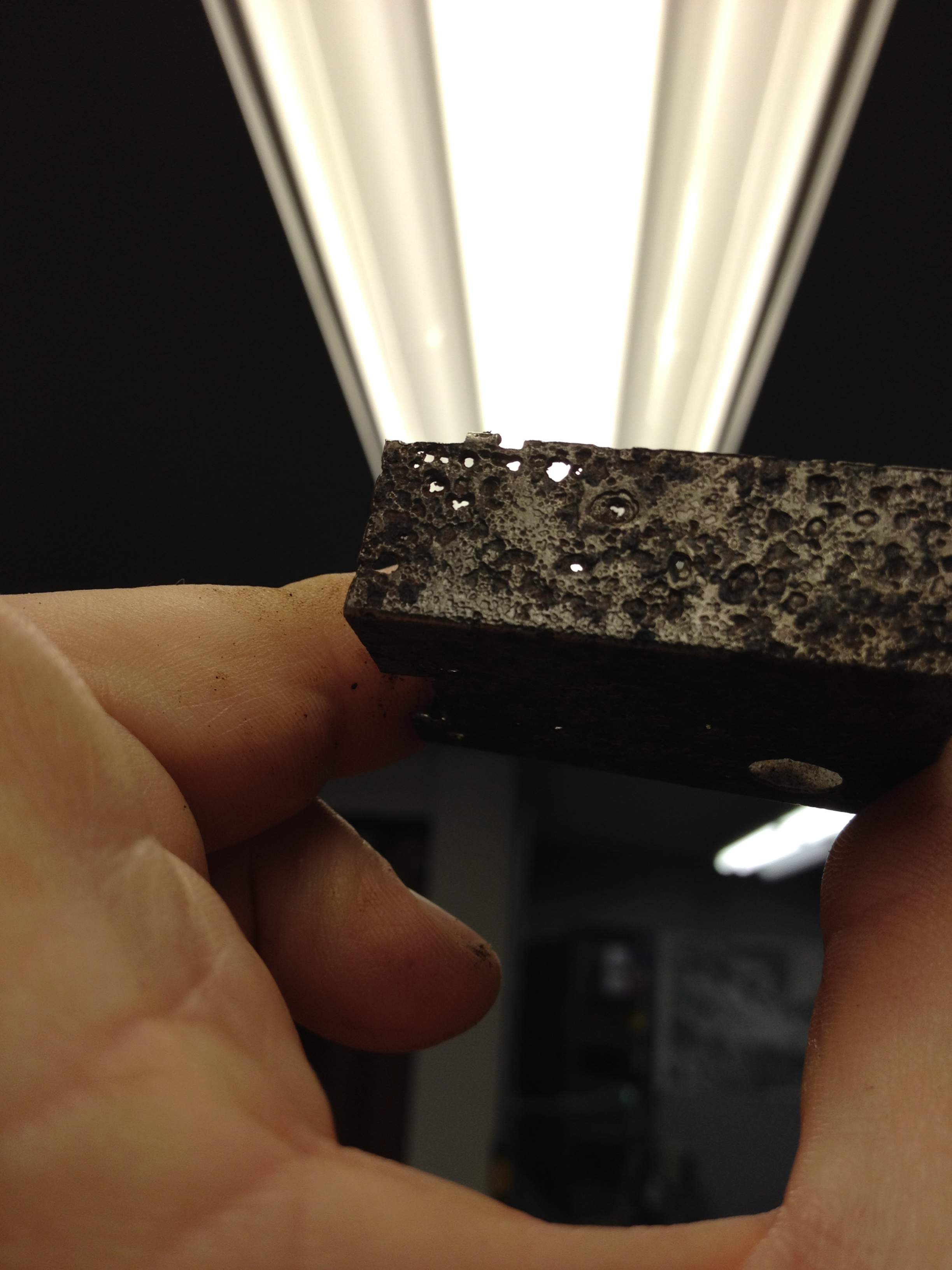

OK so I got home from work and siphoned some fuel out and not to my surprise after seeing all the similar symptoms I'm having it was filled with rusty metal ( magnet picked it up out of the diesel ) and some what likes to be tank plastic.
I am going to see if I can just pull the float level assembly out and gut it and just stick the plate back ( I may just make a plate ) on I am not going to pay $134 + dollars to replace it.
I also plan on cutting the tank to gain access to clean it and install an access port to close it up.
/ Rough Running BX #76
CONFIRMED!
Rusted and flakey sender.
I ripped the float assembly off and cleaned the base off and sprayed it with epoxy spray paint and was going to install it without the sender but I found a cheap replacement that works somewhat. The gauge goes to over half.
I'm happy I found the issue but very upset that a dealer could sell me this tractor used and not even checking a known issue! I found a sender that was close to the original.

It looks like the replacement uses some kind of plastic and possibly a stainless steel rod but don't know for sure - https://www.messicks.com/images/parts/55/ku_k2771-613700.png
