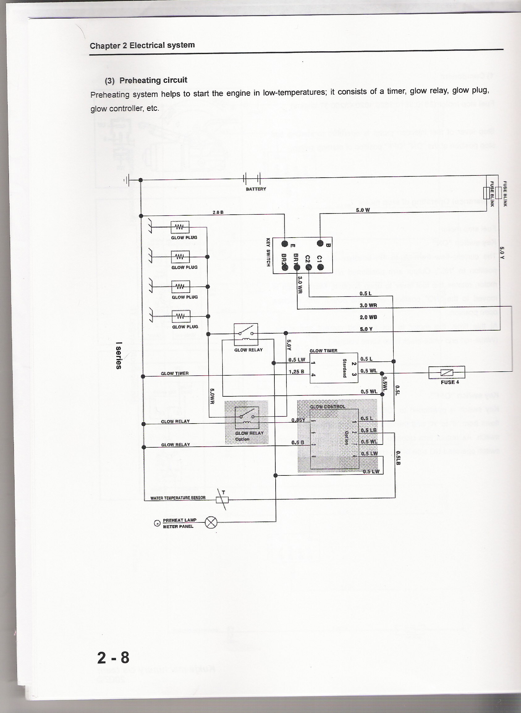

I have been reading the posts on the rough starting issue on some Bransons.
I have a 2910i, and in the cold weather it is rough starting, white smoke etc.
Here is a schematic of the preheating circuit. this covers 2910 (I),3510a (I),
3820 (I), 4220 (I), 4720 (I). Maybe this will help for someone is having the same problem. I hope this helps. Hope I got the attachments sent ok.:)

Did you have a problem with the pre-heat system?
   / Rough start in cold weather on Bransons #3
Looking at the schematic, the glow plugs are activated through a relay. You need to determine if all the plugs are in working order. A simple check with an Ohm meter will do. Is the plug open or not? Are all the plugs in the same resistance range, about 1 Ohm each cold? The problem may also be due to the plugs not being heated long enough, you may need to cycle the heat 2 or 3 times.

What I do is cycle the heat a few times. It helps somewhat. Since this is a timer and I think it is solid state. Ther may be a rc time constant that could be changed ?????? Or bypass it with a pushbutton and heavy enough wireing. I dont, know about the optional wireing in this circuit.
