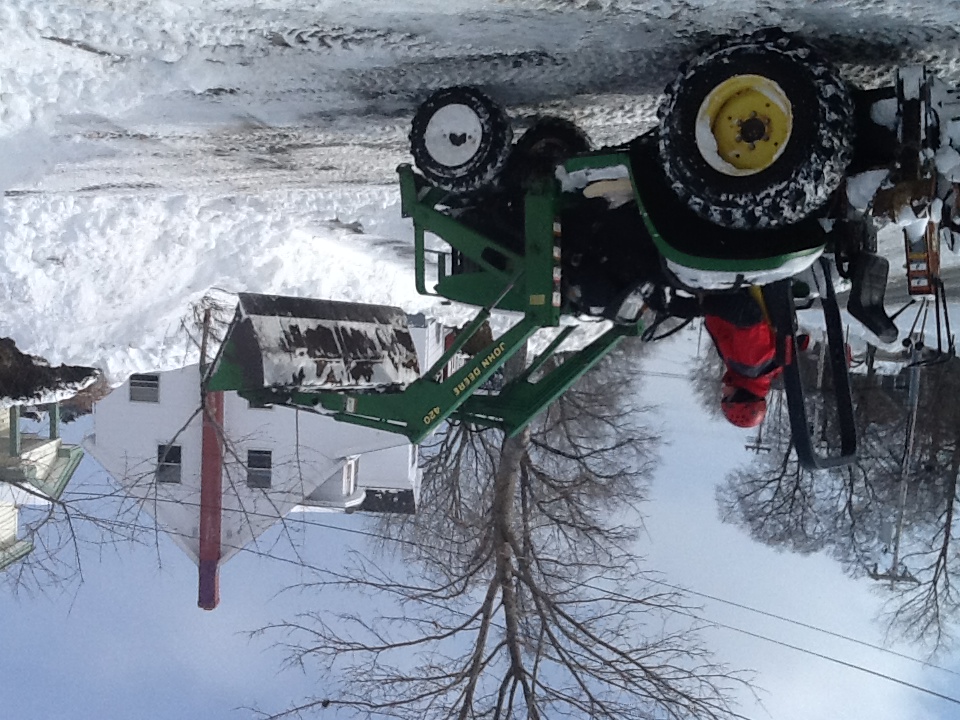

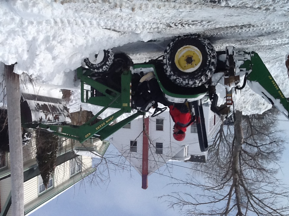

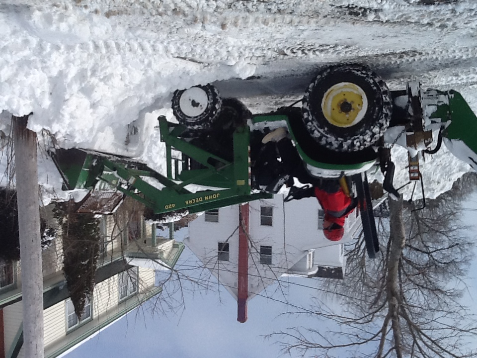

One can also put a screen up behind the bucket and angled so nothing can roll back.
Note, after a warning from Beentheres the angle has been increased.
