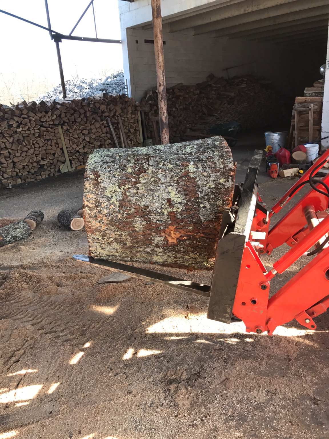

translate.google.com will help you with the japanese. It may not get the translation exactly right but should give the general idea of what the FEL capacity is.
Just remember that is at the pins. When you lift you lose capacity FAST. You also have to understand counterweight on your 3 point and how important it is.
My tractor says the FEL capacity is 1000lbs. At full height I would be lucky to lift that 700 lb round.
   / Tractor with FEL to lift 550-750lb round bales #29
2000 pounds capacity at the pins is bare minimum I would say. The weight of the bale is quite far ahead of the pins.
Wilkommen im Forum.
   / Tractor with FEL to lift 550-750lb round bales #30
I’d guess this chunk of wood weighs as much as the round bails and I lifted it with a 1200 pound at the pins loader. IMG_0823.JPG
