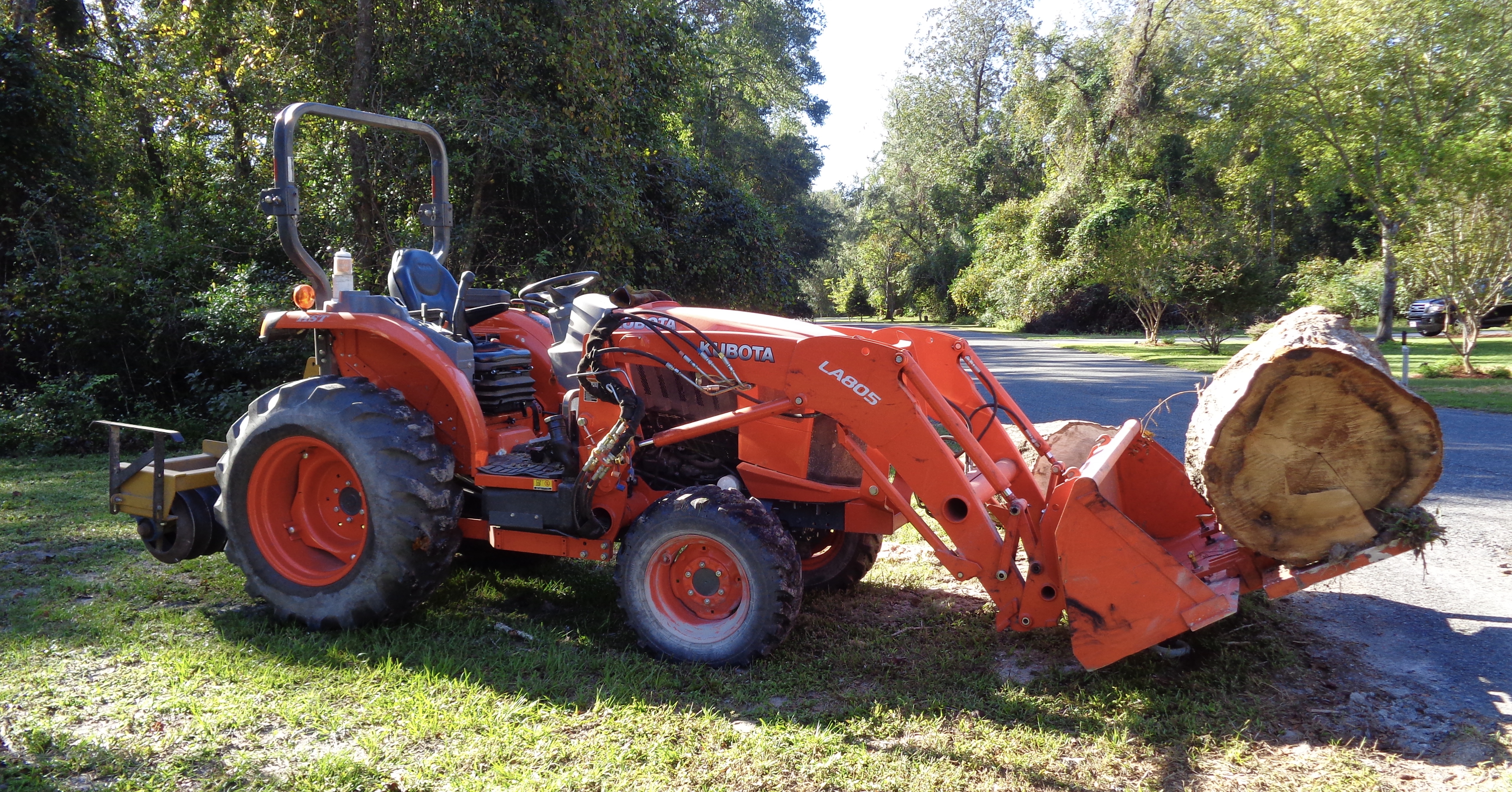

As your Kubota is just a bit heavier than the GL417 and just about the same wheelbase, length and width-- do you feel like it is pretty stable driving around carrying a ~600 pound load on the FEL?
YES ~~ However a counterbalance load on the Three Point Hitch, generally 3/5 of FEL bucket load, is essential. The lift capacity of my Loader is about 1,700 pounds.

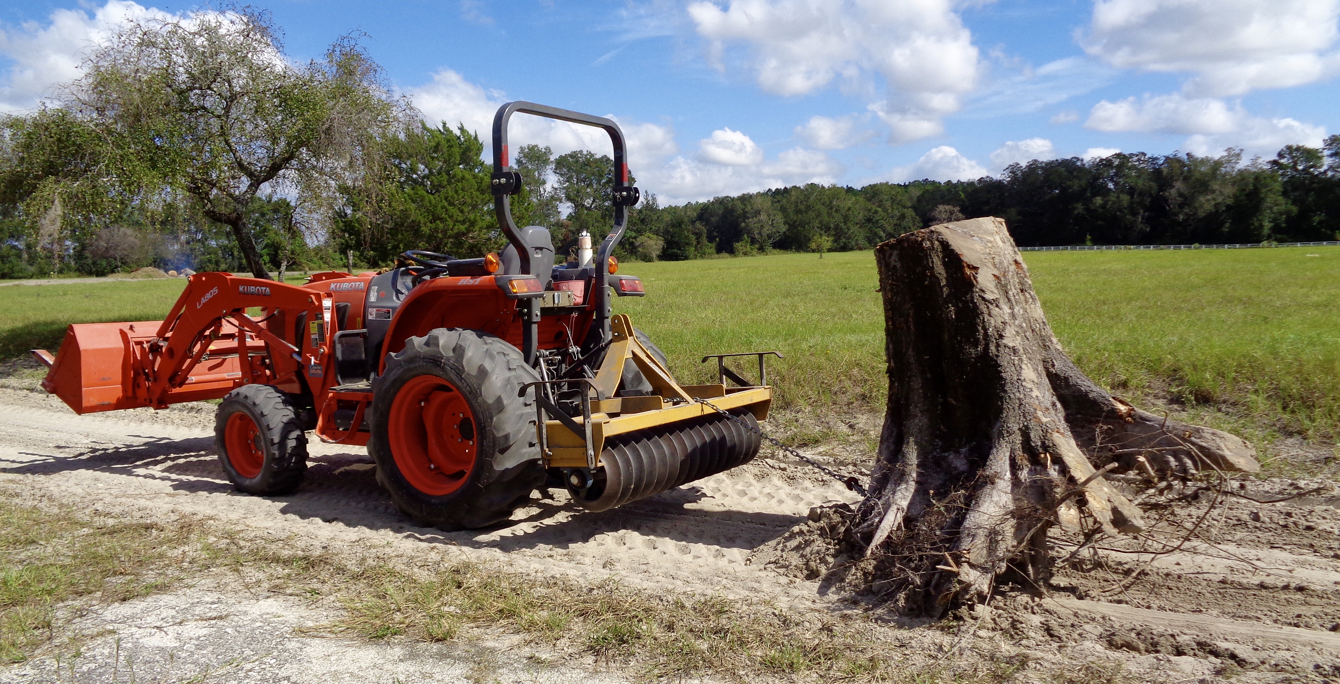

Do you ever run in to anything you can't get done with yours and wish you had a bigger tractor?

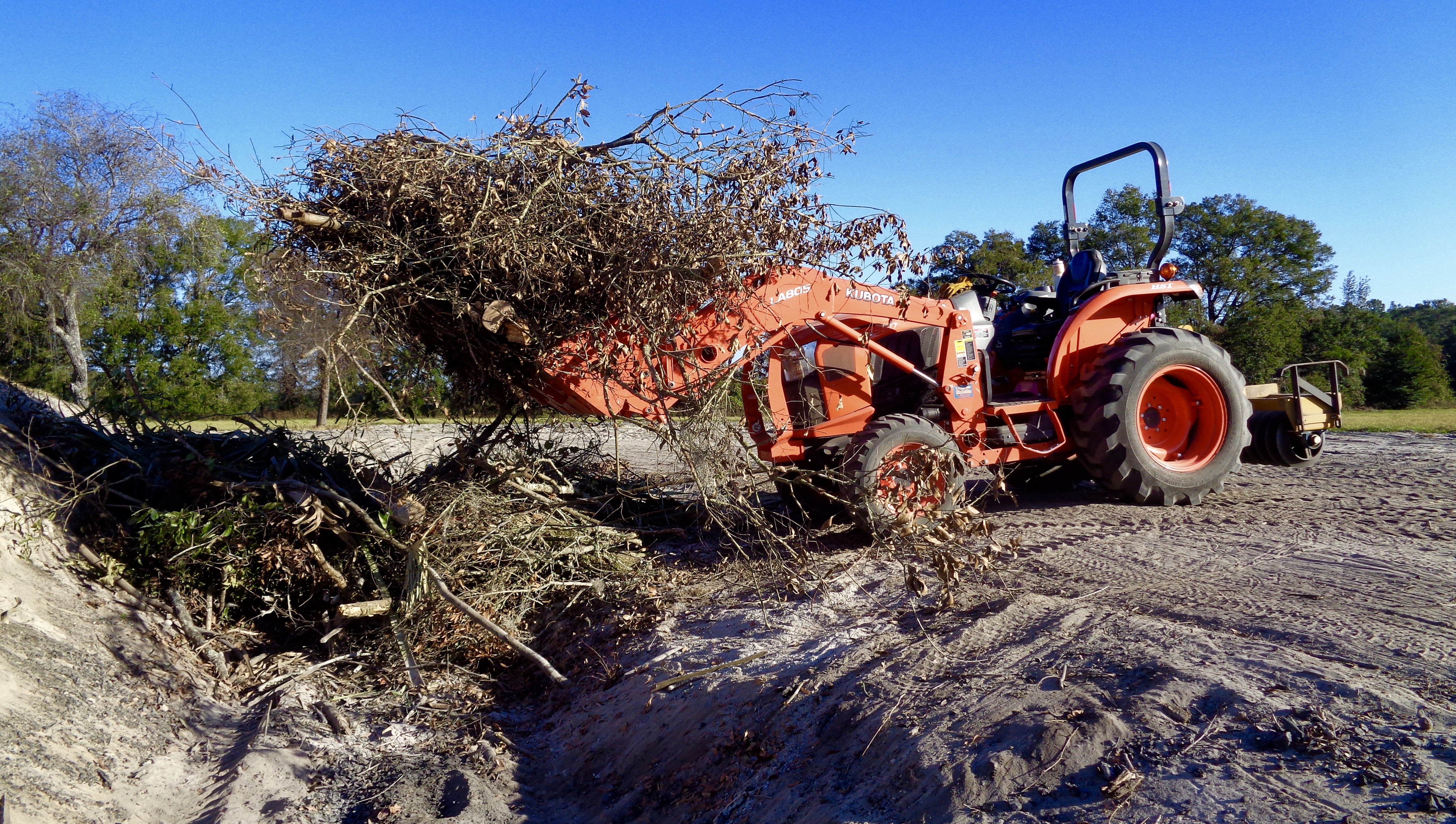

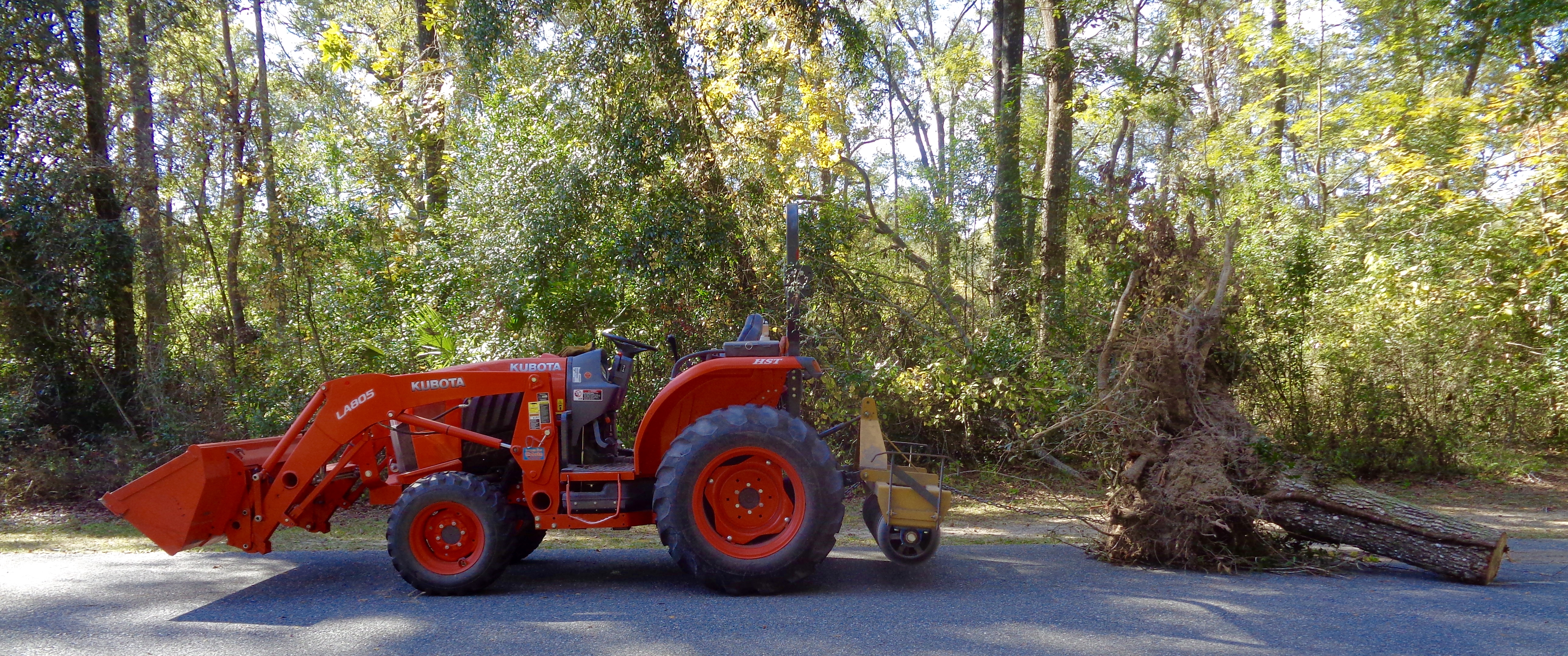

Very rarely. However, I am retired so I never feel time pressure. Much of my work is in woods. My tractor is 60" wide. A 66" wide tractor and implements would not pass consistently between the trees in my woods.
