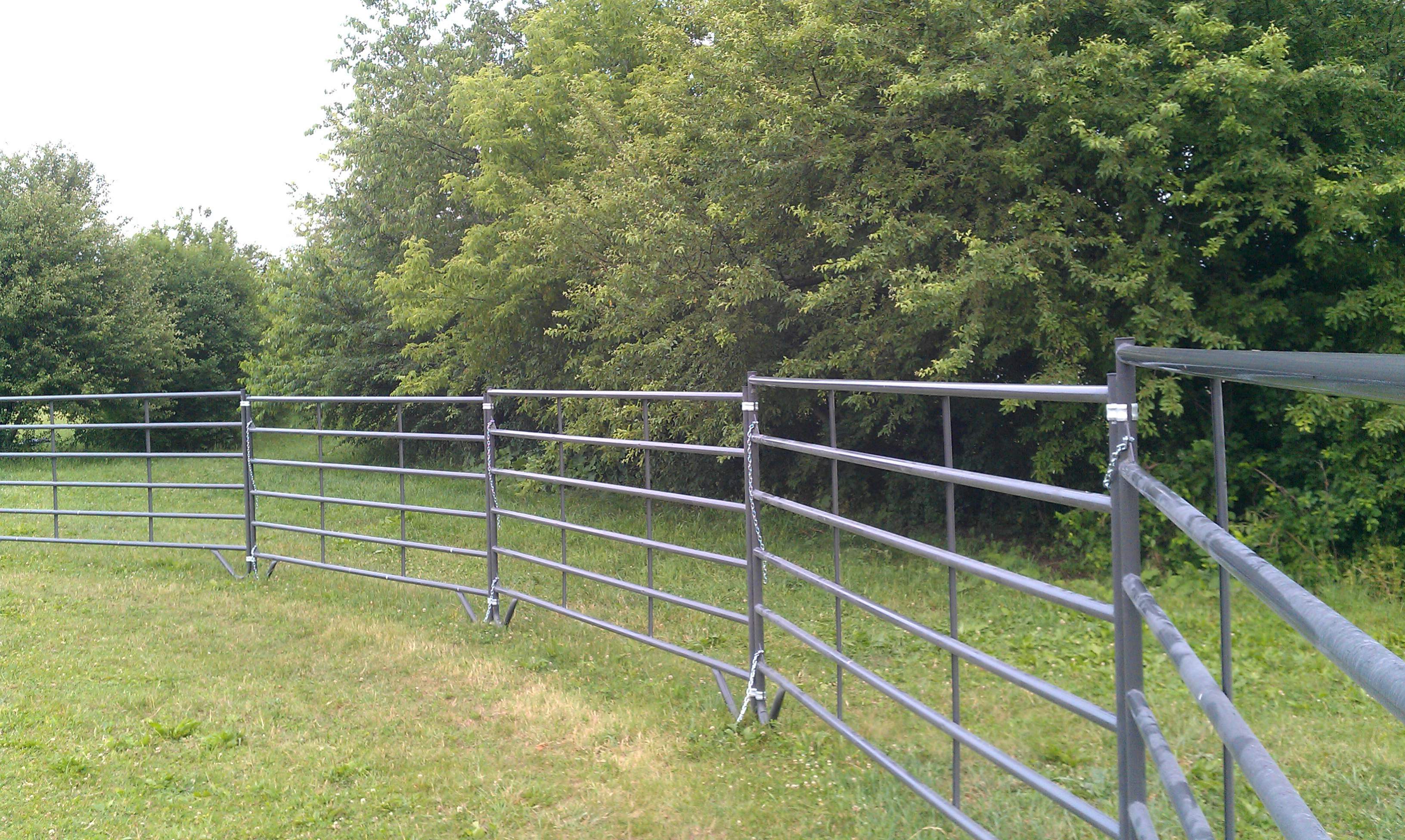

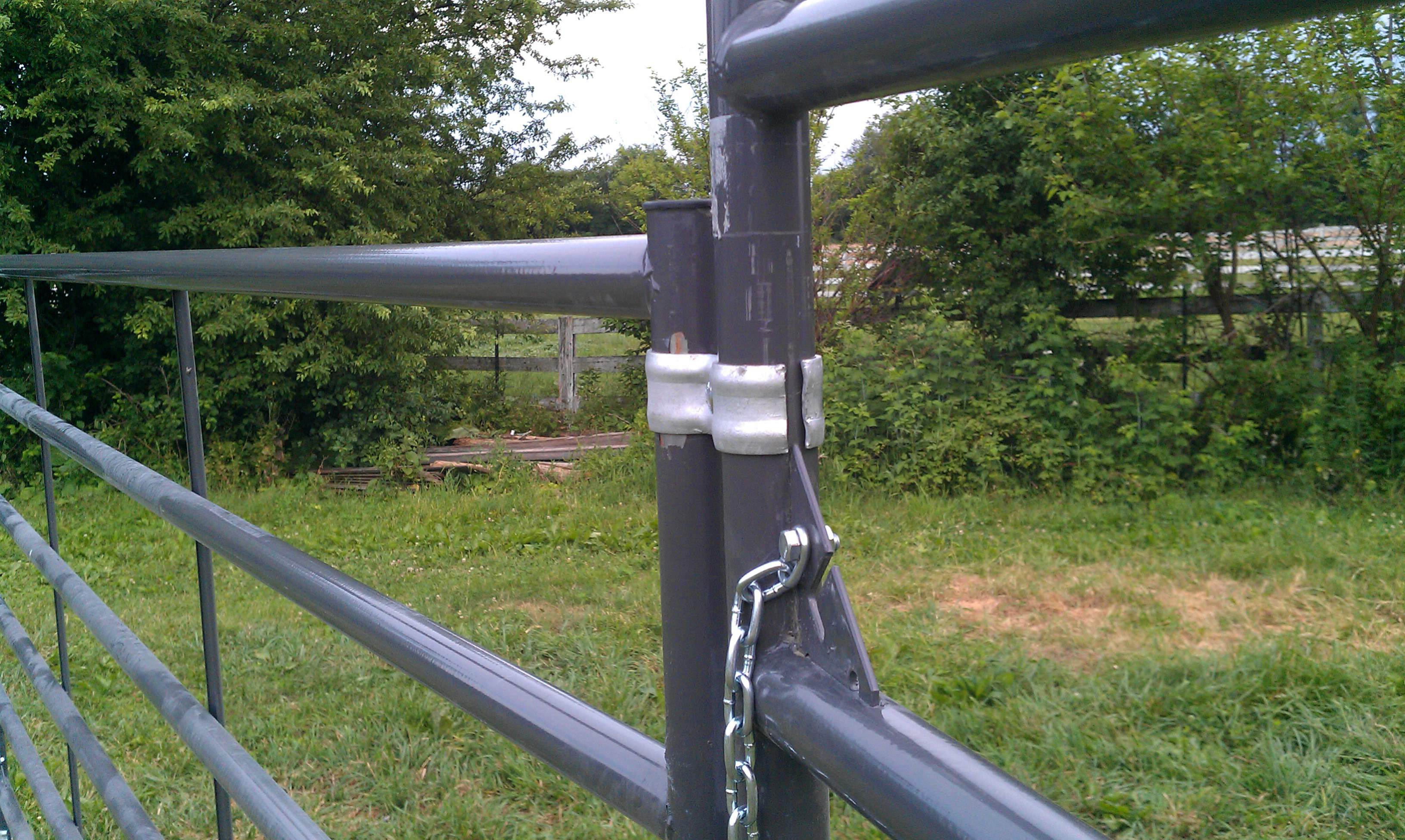

I setup an 80' round pen, used 5' high, 12' wide panels that I bought at Farm and Fleet. I've had a problem with the panels either wanting to tip in toward the center of the round pen, or tip out away from the center, creating a sort of domino affect where it affects a lot of panels on each side. The panels are connected to each other with chains top and bottom. The whole thing seems less stable than I would have imagined. Anyone have any experience with these things, maybe it's just how they are.
i have both pin in and chain type. ont he chain type.. just chain em as tight as possible.. if they lean a bit and it's going to be up for a while.. zip tie them...( and chain them ) fast, cheap (mostly) and works..
   / Round Pen for Horses
#15
Thanks, I put duct tape on them to see if that helped, works great. So I ordered some saddle clamps that they use to assemble dog kennels. I think that will hold them. They were only $1.25 each, will post photos once I get them installed.
   / Round Pen for Horses #16
yep.. dt works fine too... good thinking like that will get ya down t he road.
#17
Here's my solution, bought the saddle clamps, they work great. Also found that I had to keep each panel level and raise or lower them to go up and down the grade. So tops aren't even, and only one of the panel feet touch the ground (unless it happens to be on level ground) but panels are plumb so a clamp can be installed top and bottom to make things secure.
