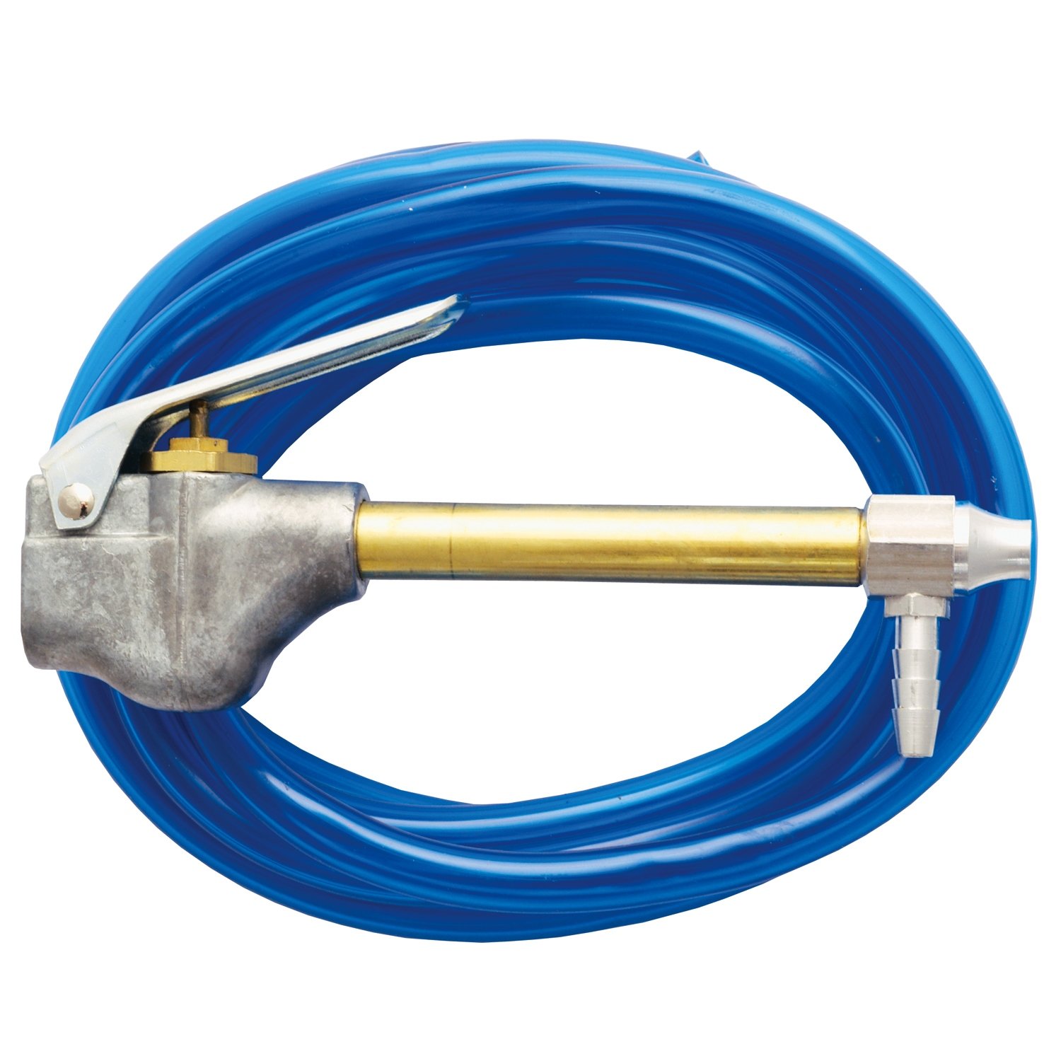

Hook this up to your air compressor, drop the tubing into the case and squeeze the trigger to get the siphoning started, pull the tube out when enough has been removed.
https://www.amazon.com/Milton-S-157...YMYCBBCX7HA&psc=1&refRID=RDC2WB88QYMYCBBCX7HA

Maybe it is just me but I still don't understand how this helps remove the drain plug. :confused3: Maybe it reduces the hydrostatic pressure on its backside? :laughing:
It doesn’t. But it will start a siphon. It’s the same concept I discovered when I was about 5 by putting 2 straws in a glass and covering the top with my hand. Blowing in one straw would push water out the other straw. Take it easy with the pressure so you don’t blow a seal out.

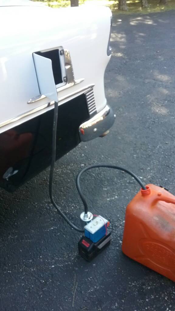

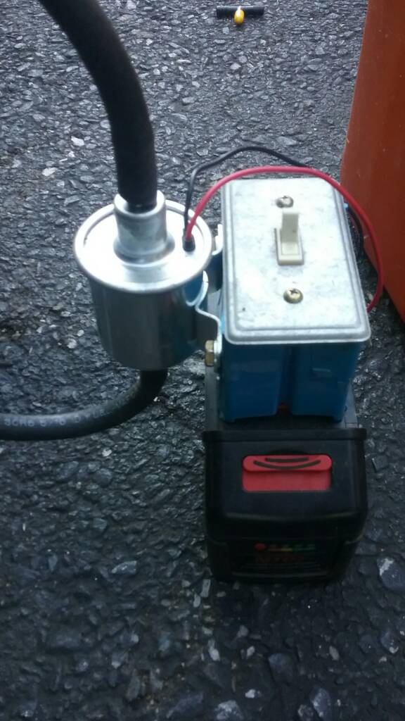

A universal fuel pump like this works also, self contained like this using a battery or just clip lead it to a car/tractor battery.20181023_152619.jpeg20181023_152608.jpeg
