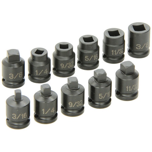

this is the only thing that should be used on a square drive drain plug. Cheap 1/4", 3/8", and 1/2" Square Box Wrenches photo8.jpg using vise grips, pliers, or pipe wrenches, or even open ended wrenches will eventually round off the square nut..

They also have socket sets for square plugs.
/ Rounded off drain plug #368
I also have several 8 point sockets for square plugs too. Most tool brands have them.
/ Rounded off drain plug #369
I would not recommend 8 point sockets for square plugs, as they would have less contact points, and could strip the plug if a lot of pressure is needed to remove it.. Thanks for the link to the four point sockets though, they are very difficult to find at a decent price!..
They work just fine, just have to be smarter than the tools your working with.
/ Rounded off drain plug #378
Thank you for the heads up. I had no idea and sure could use that set.
Your welcome, they are handy for sure. There are several different brands and price ranges , just have to search around and find what you like.
/ Rounded off drain plug #379
/ Rounded off drain plug #380
Not sure what that’s supposed to mean. Pretty simple fact that a 4 point head in a 4 point socket takes more before it strips vs 8 point. Let me guess. A 12 point works just as good as 6 point it’s just operator error?
