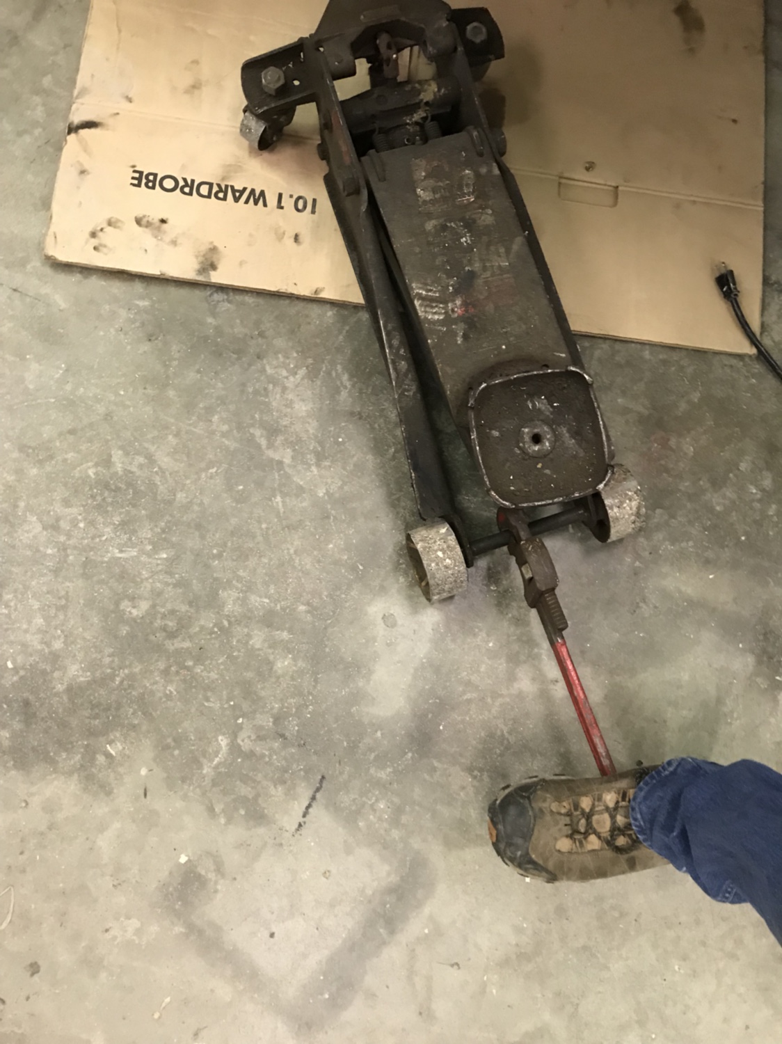

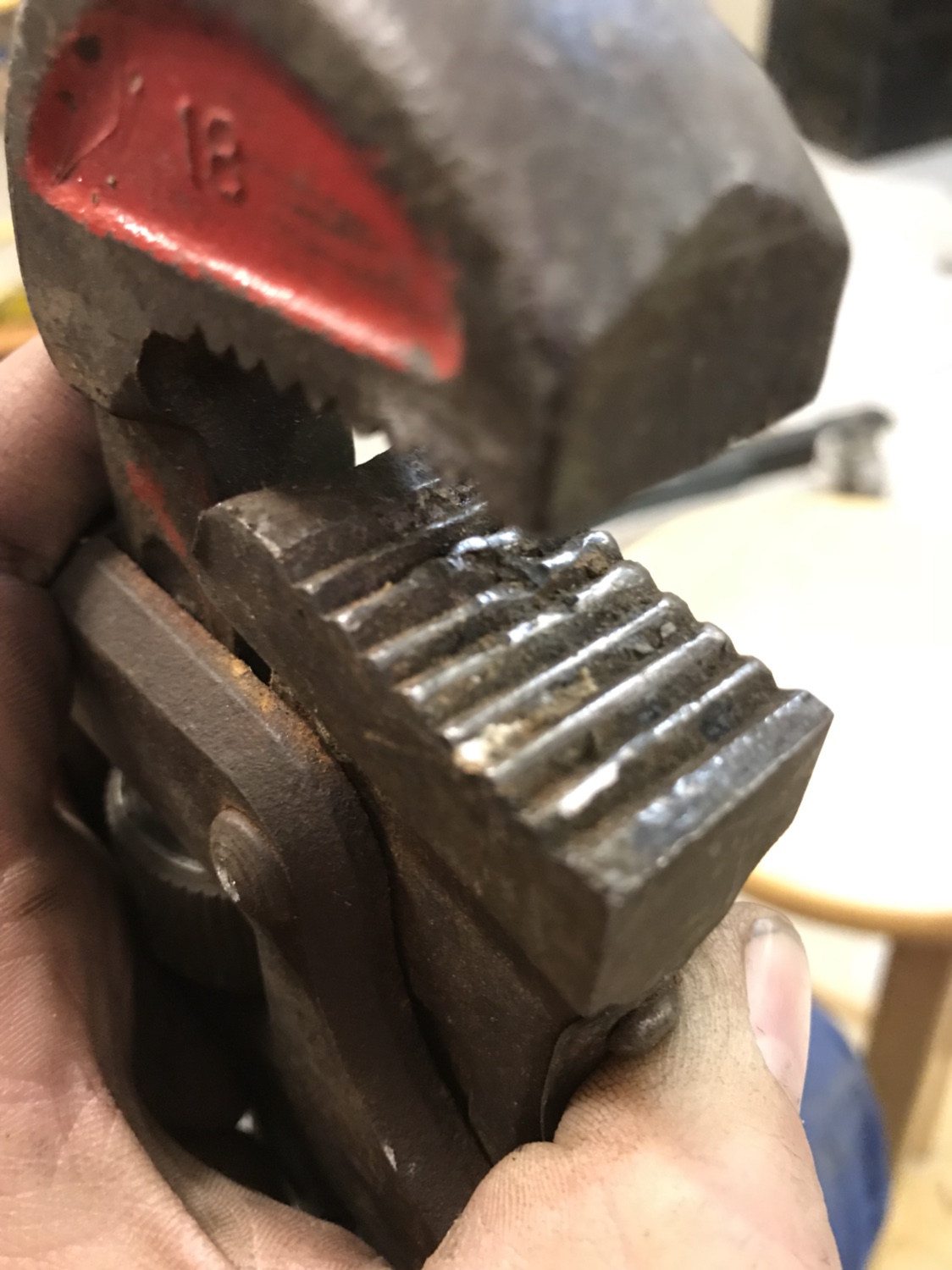

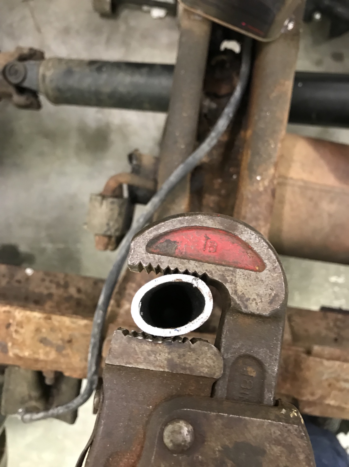

Hereç—´ how hard a pipe wrench will bite. This same pipe wrench which is by no ones standard a quality tool and has buggered up teeth easily holds my weight turning against a floor jack axel. View attachment 582215View attachment 582216View attachment 582217
Those bottom jaw teeth certainly do look a bit rounded.
I sharpened the teeth on mine (formerly my dad's) with a triangular hand file.
Then gave them both to one of my sons.
I have a nice set of 3 aluminum Rigids for myself.

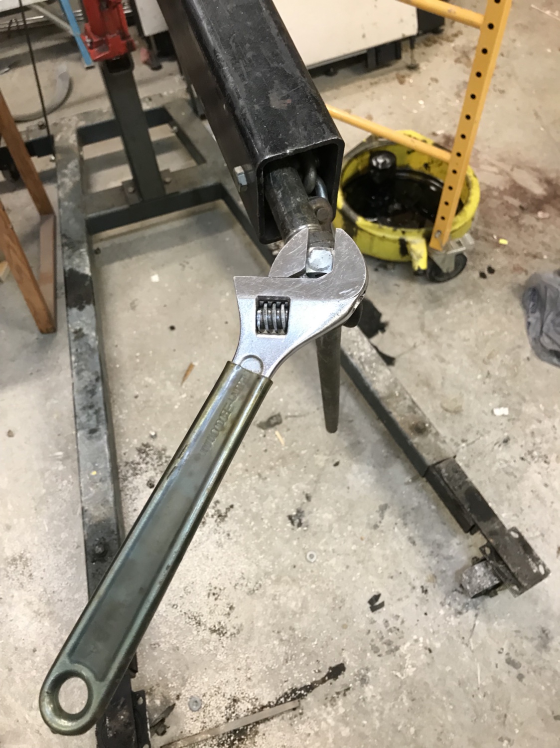

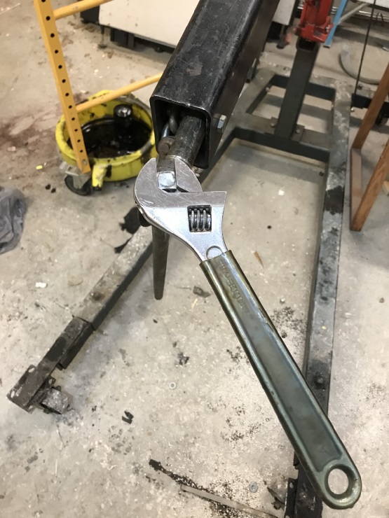

First thing would be to turn it over to the recommended position for tightening:
Less likley to break the adjustable jaw.
Then use a 3' long cheater pipe on it. :D

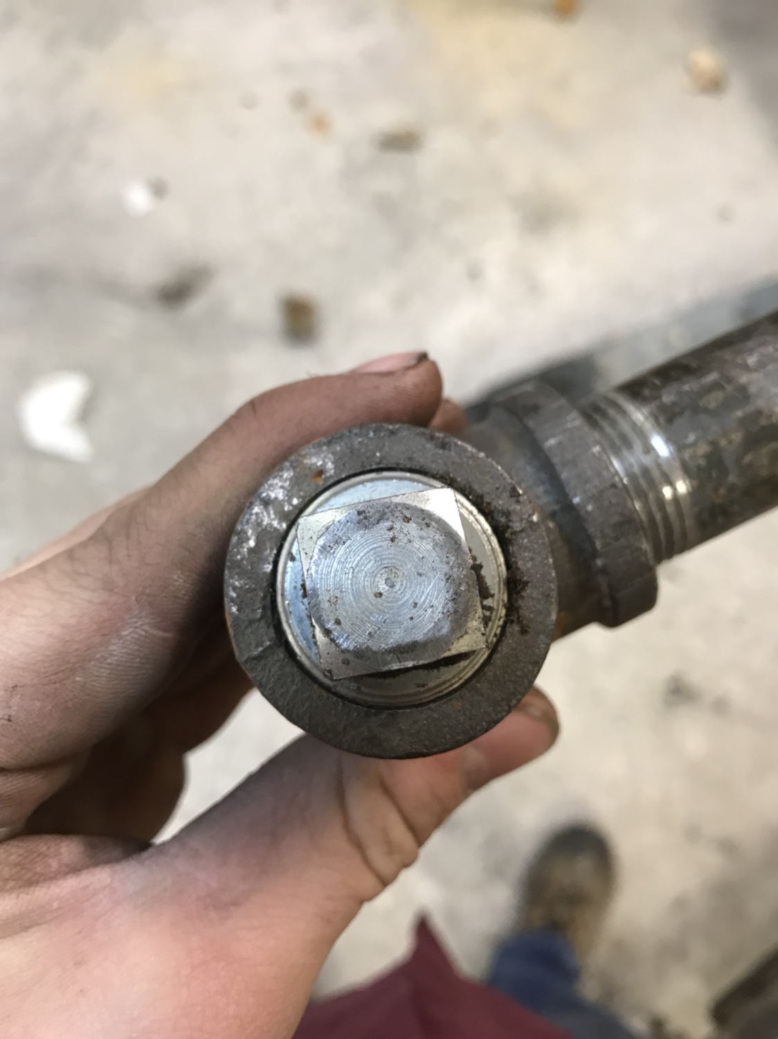

I didn’t have any pipe big enough to go over the adjustable wrench handle. I later swapped to a 12 point socket and breaker bar and drove the plug all the way in. I really figured that would do it in. Surprisingly that didn’t strip the head either.

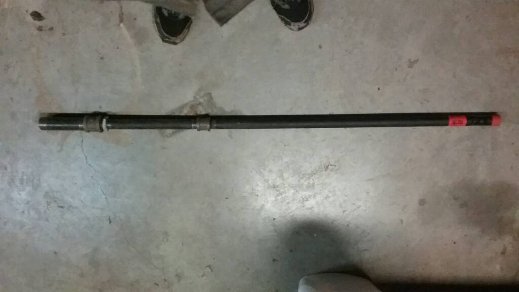

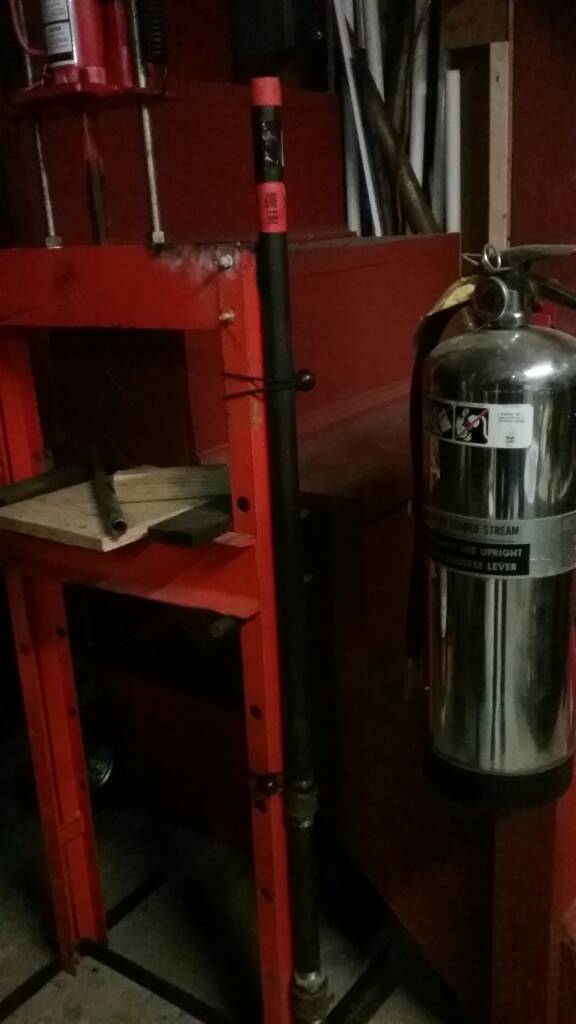

This will help. I use black iron pipe and adapters for pipe wrench torque.
I store it on press, and it makes various lengths.
Two posts to go.View attachment 582272 20181208_185052.jpeg20181208_185116.jpeg

The vice grip had the worst grip of the 3 and didn’t hold very long before coming off. It was also the shortest of the 3 tools so despite using the same test it had the least to live up to. I’m pretty sure if I had a big enough cheater pipe I could have twisted the floor jack axel off with the pipe wrench. The Knipex isn’t a very tough looking tool and really isn’t designed for cheater pipe action.
