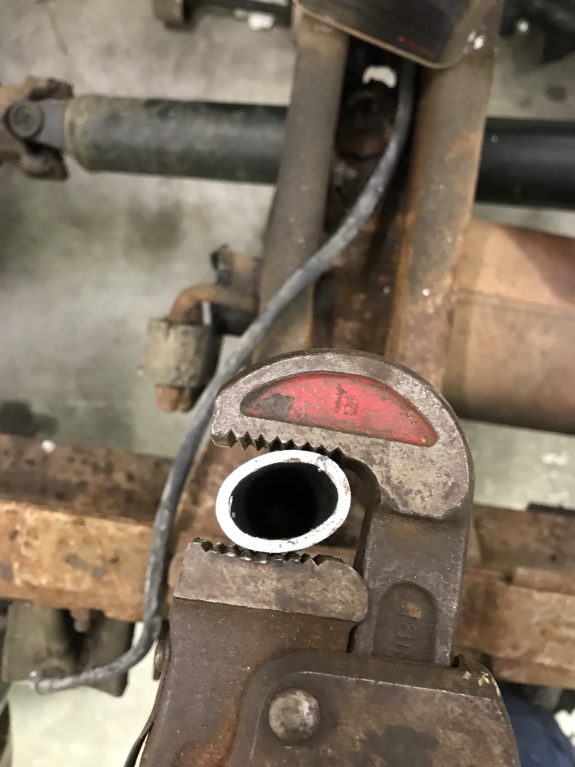

Here’s how hard a pipe wrench will bite. This same pipe wrench which is by no ones standard a quality tool and has buggered up teeth easily holds my weight turning against a floor jack axel. IMG_0829.JPGIMG_0831.JPGIMG_0830.JPG

I repeated the same test with my knipex and they also passed. Then I decided to do it again with a pair of vice grips which while I was standing straight down they also held. Then I got sideways a little and knocked them off. I’m pretty sure this less than perfect twisting force and instead pulling the wrench down is probably the OPs problem. IMG_0832.JPGIMG_0833.JPG

Since I’m still board how should we over tighten and strip this pipe plug? My Klein adjustable wrench seems to me holding like a champ. IMG_0834.JPGIMG_0836.JPG

Hereç—´ how hard a pipe wrench will bite. This same pipe wrench which is by no ones standard a quality tool and has buggered up teeth -------------
And you adjusted it correctly, note the gap where I put the arrows:
Here is a side view from their Website showing the same thing:
/ Rounded off drain plug #975
I think the pipe wrench jaws had actually bottomed against the head after crushing the pipe which is not optimal. They should be like this. Notice the gap which leaves room to grip tighter. IMG_0839.JPG
