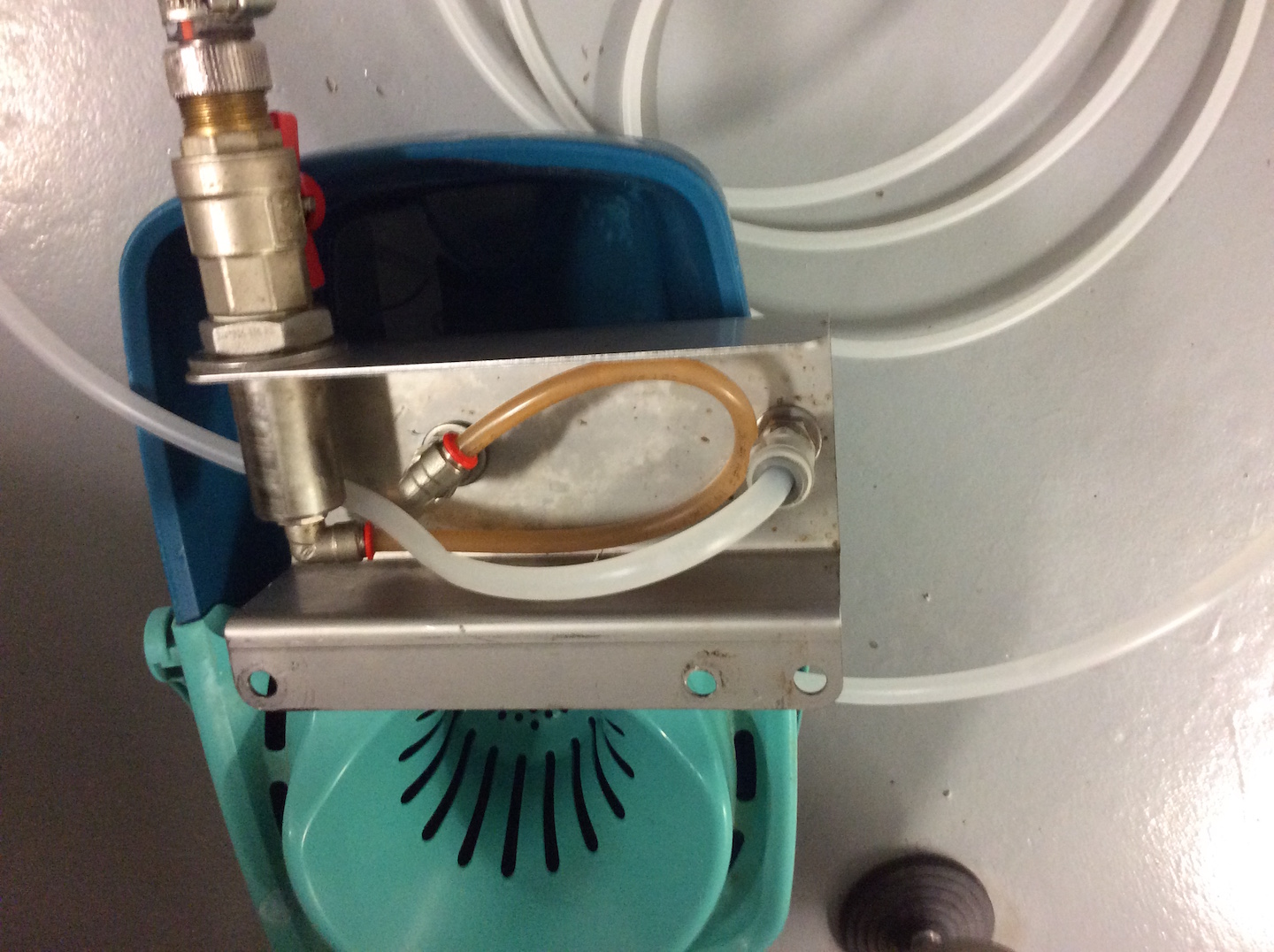

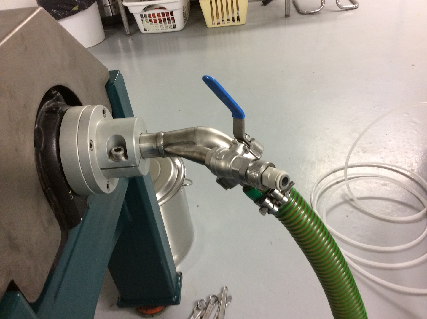

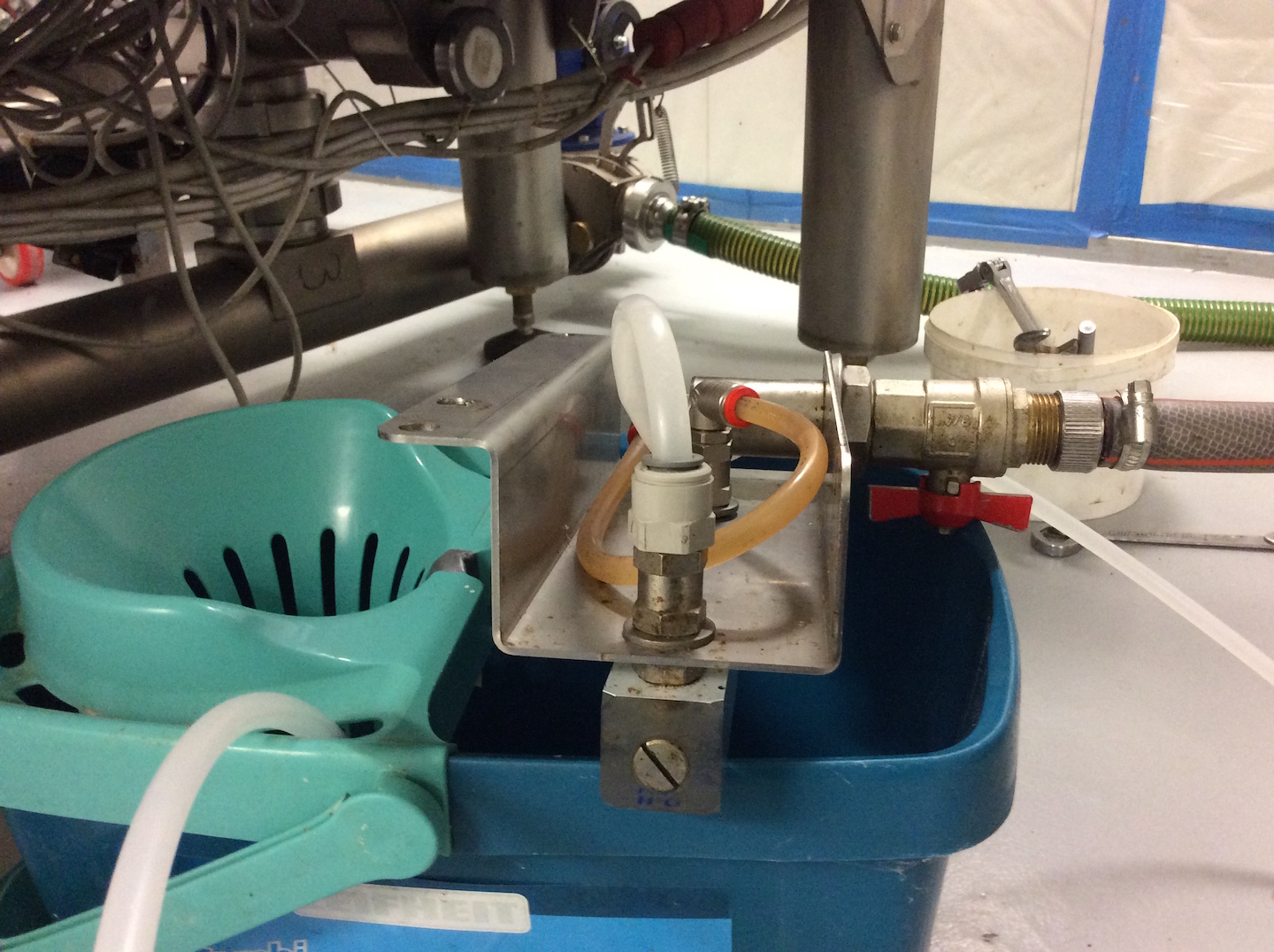

Now adding water is very tricky, we have a regulator with a simple ball valve that I can open and close and adjust the flow of water. Trust me those rings of paste/water/oil inside the centrifuge are very tricky, you adjust the water by a micro adjustment, it is that sensitive. The tube that delivers the water through the water regulator to the centrifuge are connected with push to fit connectors. Is that the right term? Anyway, I had small leaks on each end, the end where it connected to the water regulator and the end that connected to the centrifuge so I wanted to replace them. What an ordeal, frst of all I did not even know what they called those fittings in English much less in French. When after days and days of searching on the internet I finally found the term "Push to Fit" and bingo, there was what I wanted. When visiting my mother I took my pieces with me that I had cut off and found a supplier in Colorado and mailed him the pieces. The thing is, these fittings screw onto my regulator and my centrifuge so I didn't know what size threads were used, how the threads are cut is another way of saying it. As I researched this I found out about different types of threads. The supplier, once he got my pieces told me what type of threads are on my equipment and he didn't have the smaller tube but a little bit bigger tube, but most important he had those fitting pieces the tubs go into in the right thread size. He also told me that the reason I had the leak is that the fittings were for air hoses not for water hoses and he did have the fittings for water which grips the tube better I guess.
Today I unbolted the water regulator, and screwed the new fitting on the back and shoved in the hose. oops! Once you shove them in you can't pull them out again. Now the connector he sent me was just a straight out connection whereas the one I removed was an elbow connector. I tested with water and no leaks so that is great. However because it sticks out I now have to attached the water regulator to a new spot as it will no longer fit flush because of the missing elbow fitting. But I am really happy that it no longer leaks. That is so annoying having just a little dribble leak. I had to keep a small pail under it, it was just annoying. Same thing on the other end, just a dribble leak. Tomorrow my husband and i will have to drill probably a 1/4" hole in some pretty heavy stainless steel to bolt the water regulator on in a new spot. Then I am going to really analyze exactly how long I want the tube before I cut it off and fit it in the centrifuge side as I now realize there is no going back. Once you stick it in there, it is stuck in there for good. I did buy one spare fitting.
