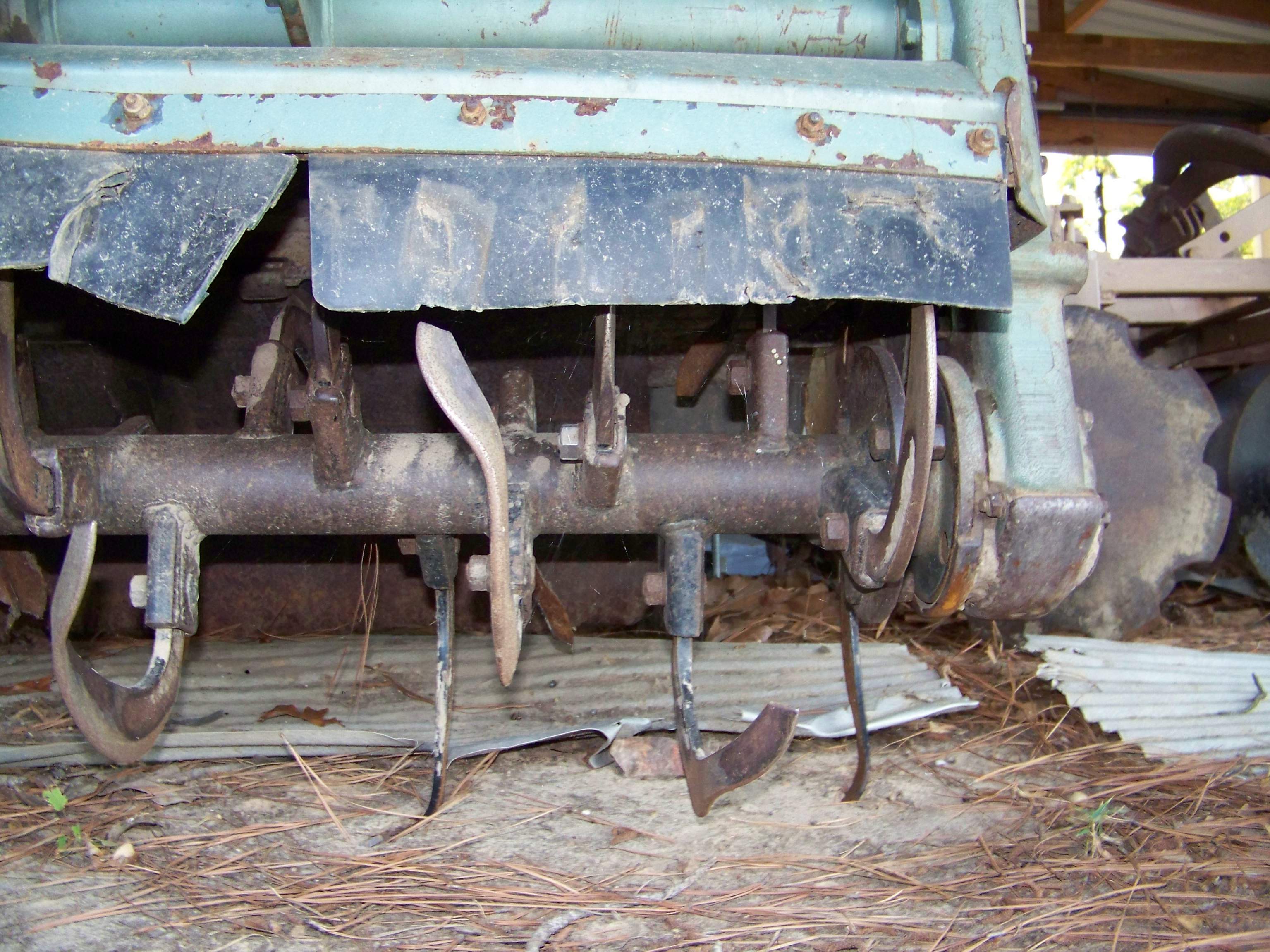

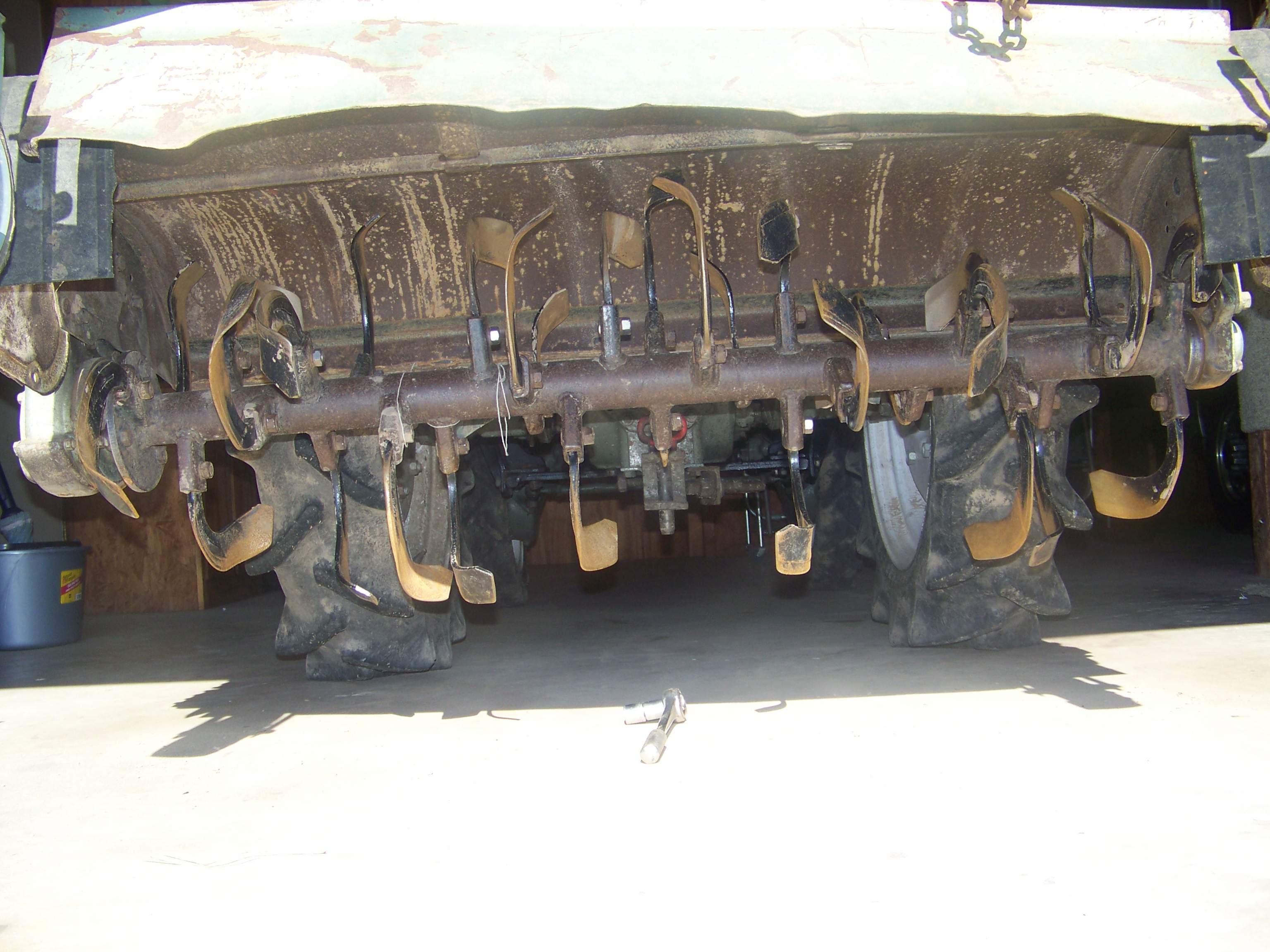

First picture is well worn original Yanmar tines. Second picture is the ones available now.

Well it's obvious now. I have the original tines, and they are well worn too! About like the ones in your picture. So I guess my work is cut out for me- removing them when I get the time, one or two at a time. Are the nuts important? As I recall they are well rusted. Might get a cutter for them- one of those screw-in jobs that wouldn't mess up the bolt. Or does the bolt matter? If not, it's going to go a lot quicker!
I sure appreciate the effort to take those pictures (even if they weren't just for me) and post them. I will not retire for another few months and I actually can afford the loss on this tiller, but I would feel a whole lot better about the whole thing if I could recover some of the cost. In other words, I wouldn't feel so stupid when I pull up to the recycle center with something I just bought! It wasn't until I really got to working with the thing that I realized the case was an oil bath issue, and that the break went right through a bearing race. I don't think it ever had a chance.

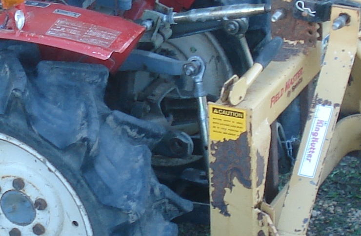

The special upper link component I am calling a 'bridge' is shown in this tiller diagram, and in this photo (copied from someone else).
Note in place of a standard upper link, there is a fixed component bolted to the tractor then a very short special upper link. Yanmar did it this way to change the geometry. Using this, the tiller doesn't get closer to the tires when it lifts, as it would with a standard upper link. This is still a 3-point tiller and attaches in moments like any 3-point implement, in contrast to a 2-point tiller bolted semi-permanently to a tractor that lacks 3-point components.
If you're lucky that special assembly was included with the tiller, and is worth some money.
