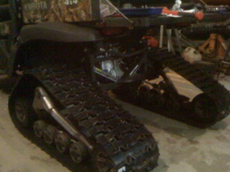

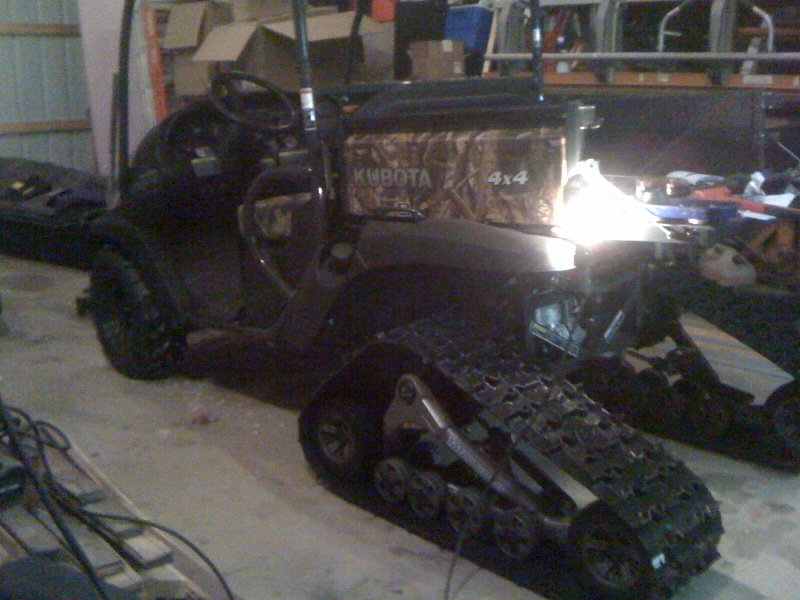

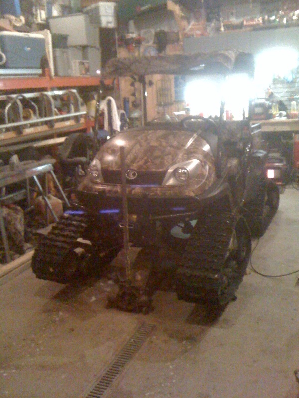

Ok, I finally got the mount kit last night around 6pm so naturally I stayed out in the garage till 11:30 installing them:). Of course I'm sick as a dog right when I finally get these on but hopefully this weekend I'll feel better and get it out for the action pics (going to drag our spear house out on the lake).
Install notes:
-Easy to do. All bolt on parts, no drilling for mounting hardware
-One required modification is to cut each side of the bumper/grill guard off by 2-3 inches:( for track clearance
-Hub adapter plates use the factory wheel lugs. The front plates need either 1 washer spacer in between it and the hub like I did or you need to cut down/ get shorter studs. When I tightened those they pushed on the brake disk causing them to distort so that is a must to alter, nothing included in the kit to fix. Instructions just say to "check clearance"
-I always coat all threads/hub surfaces with anti-seize lube, makes for easy removal from corrosion.
I just have them mounted but still need to hook up the stabilizers and adjust them. The initial set up calls for quite a bit of adjustment the first time on so I decided to wait till tonight to finish the set up when I wasn't so tired. I'll post any issues on that later.
One cool thing is that I easily picked up 5 inches or so of lift. Way more clearance under the buggy now. That was one thing that I didn't like about the kubota but now it's like a jacked up mud truck:thumbsup:
Here are some teaser pics, of course lots more to follow:thumbsup:

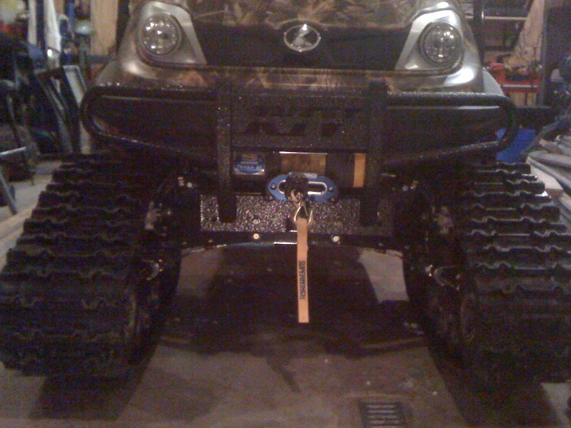

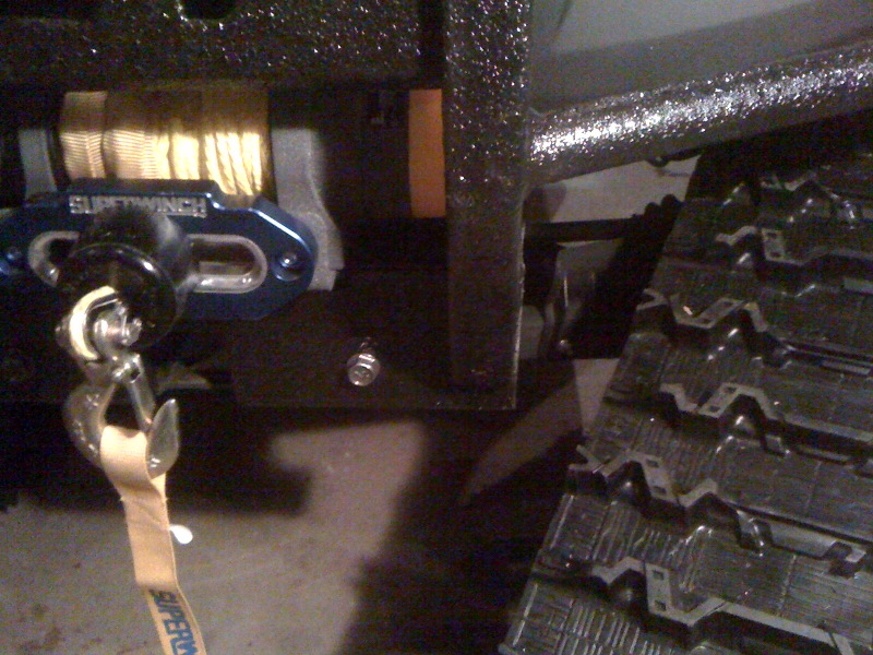

It's as slow as I figured but it seems unstoppable which is what I wanted. Too dark for pics but here are more install pics. They are of the cutting modification on the front bumper.
First is without the cut, second is with and last is the clearance with the track turned after the cut. Oh, and I got my winch cable saver in the mail today and put that on too, it's in the pic.

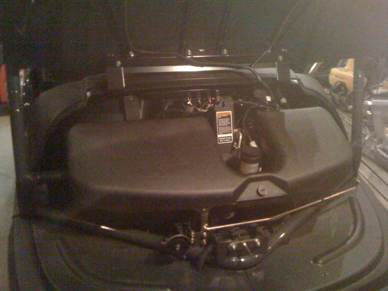

Bit the bullet and bought the storage box. I saved on many things so figured I would try it over making something. Nobody that I've seen has posted pics of it so I figured I would. Nice to have somewhere for tools, straps ect. that fits the space nicely. It even has it's own lid support in the back. Only disappointment was the way kubota used the plastic as the lid hinge. I know someday I'll be mad as I try screwing a hinge to it when it fails.

Sweet looking buggy! Where did you snag the front storage bin?
Yep, got that from my kubota dealer. He hit me around $150 which I said no way to when I ordered it in November but since nobody makes aftermarket ones I reconsidered as I REALLY needed some dry storage on this thing. I also picked up a camo soft top at Gander on close out for $17. It's meant for a prowler but hey, it will do until I decide what to do with the cab.
