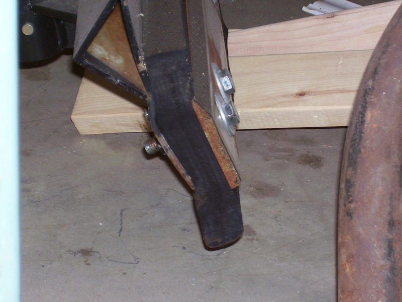

Hsllo - I am trying to work out what to put on my 5' back blade (on my JD 1050) to keep it from causing damage to a new driveway of asphalt (which is has slopes and valleys for drainage) plus stone blocks at the edges that are held in place with cement and not entirely smooth.
Ed
Ed, here is how I did it to my fel blade. The rubber came off a local county snowplow. Real tough material, especially to cut with a utility knife. Works great though as I plow several neighbor driveways that are all covered in blacktop. No damage issues using this.
