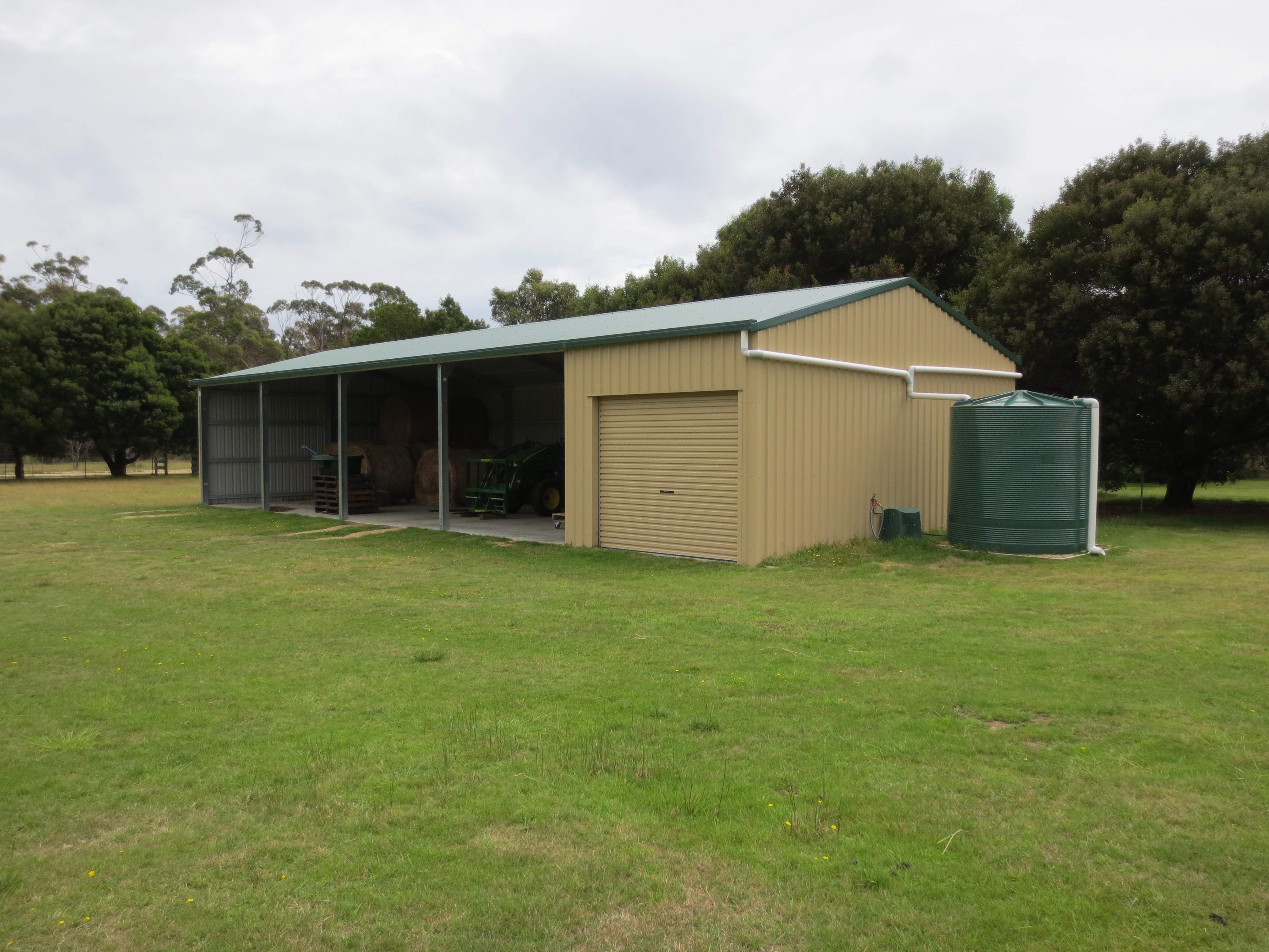

I would imagine that you could fully or semi-bury the tank. The tanks we have here all come with a screen on top to catch debris from the downspout + an overflow hole at the top.
It's pretty simple. This is the system I've got hanging off my shed... it waters my horses & I can use it with my karcher for hosing down stuff.
