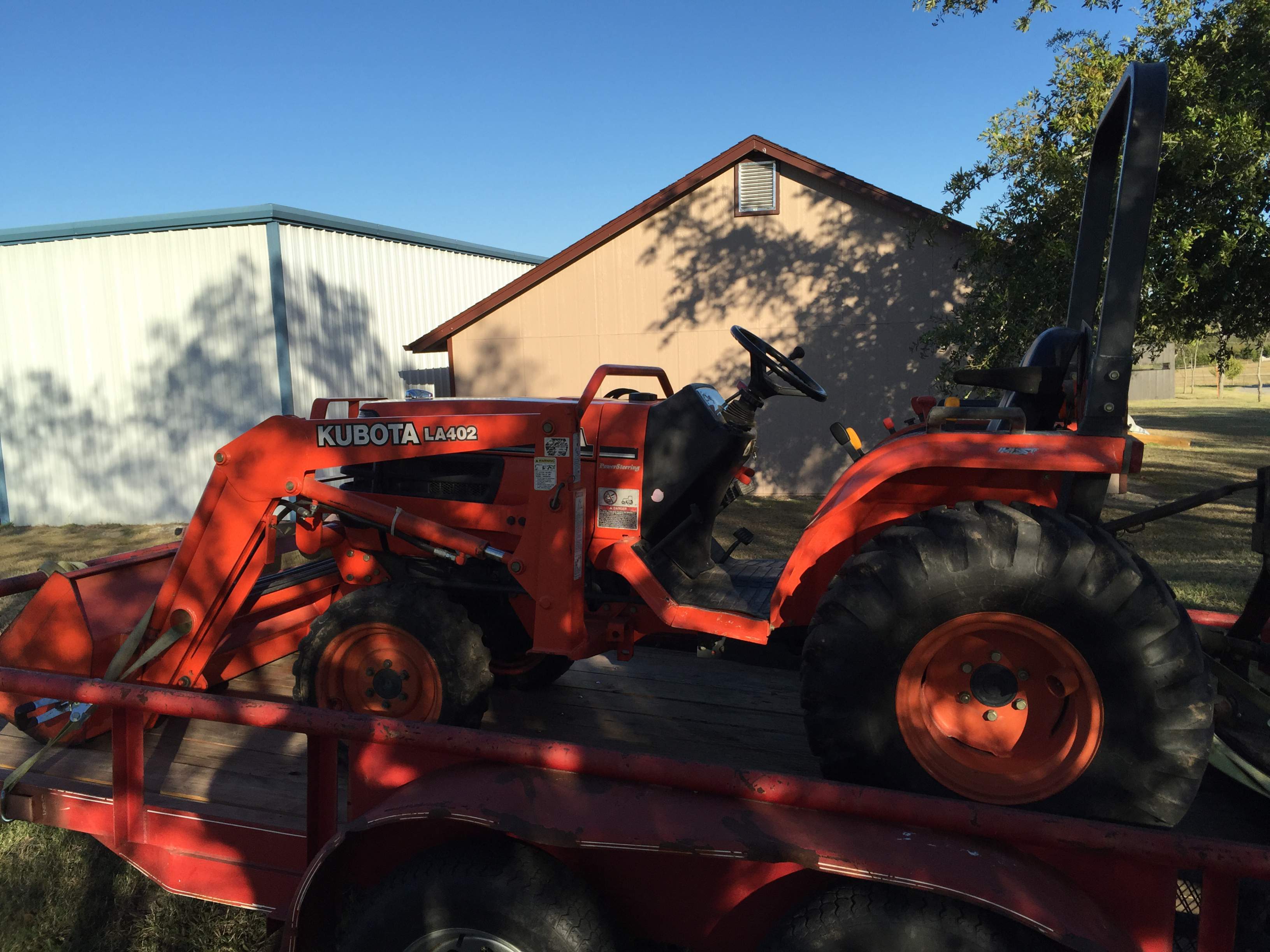

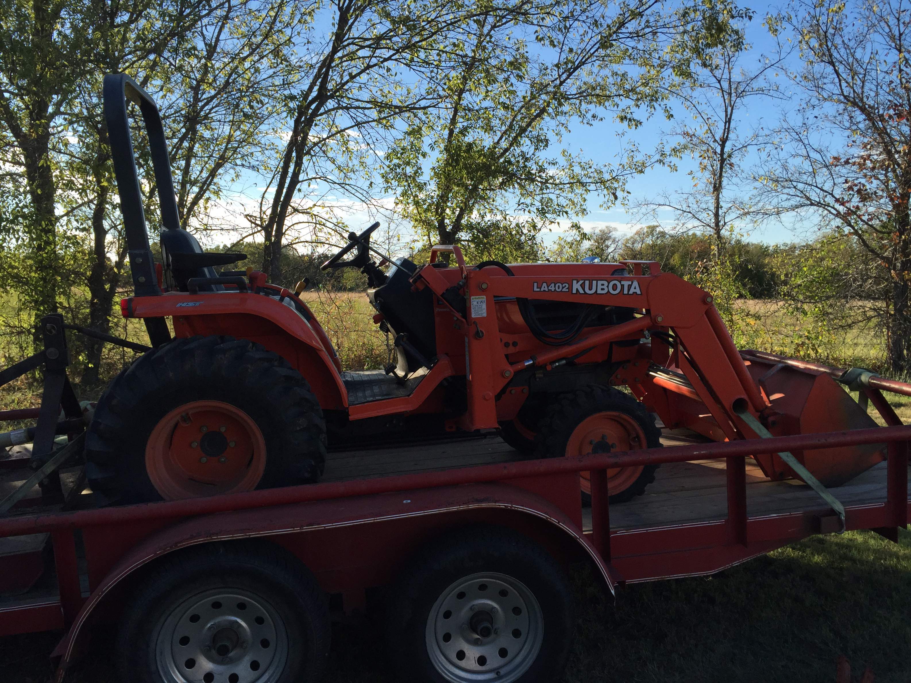

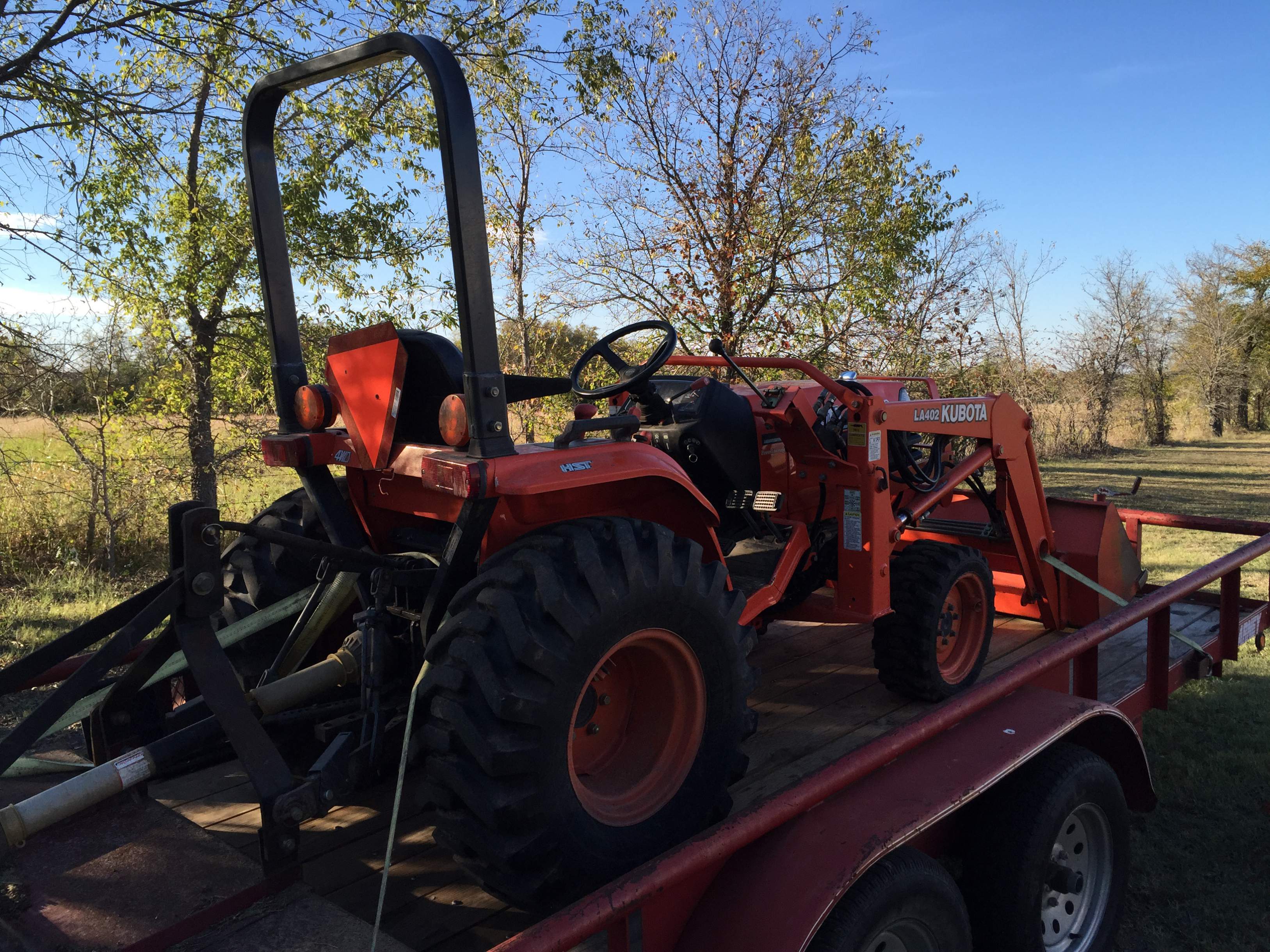

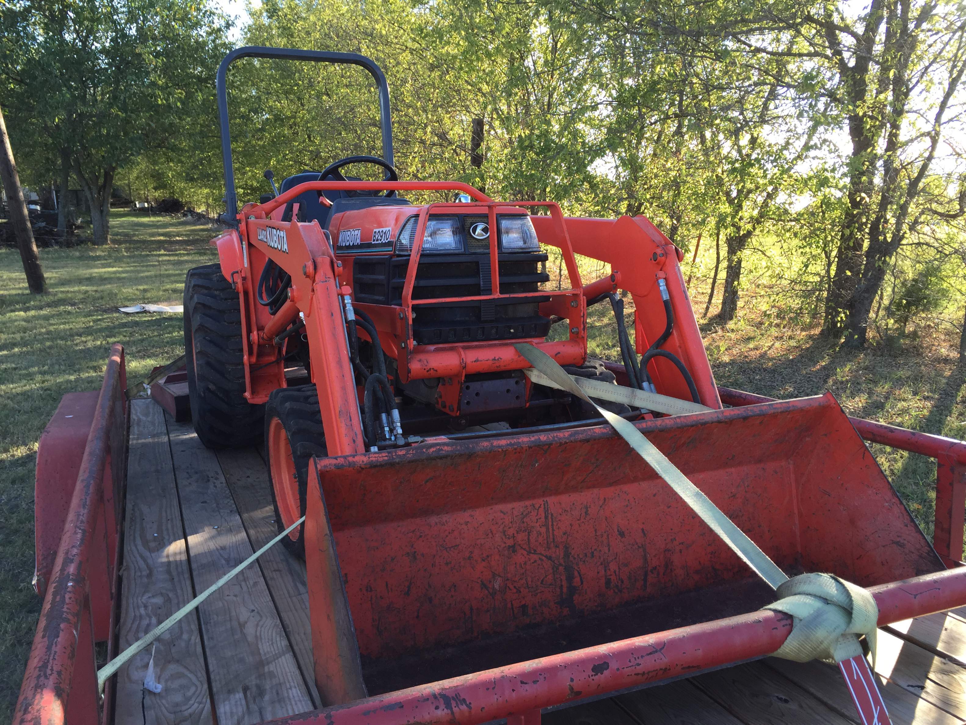

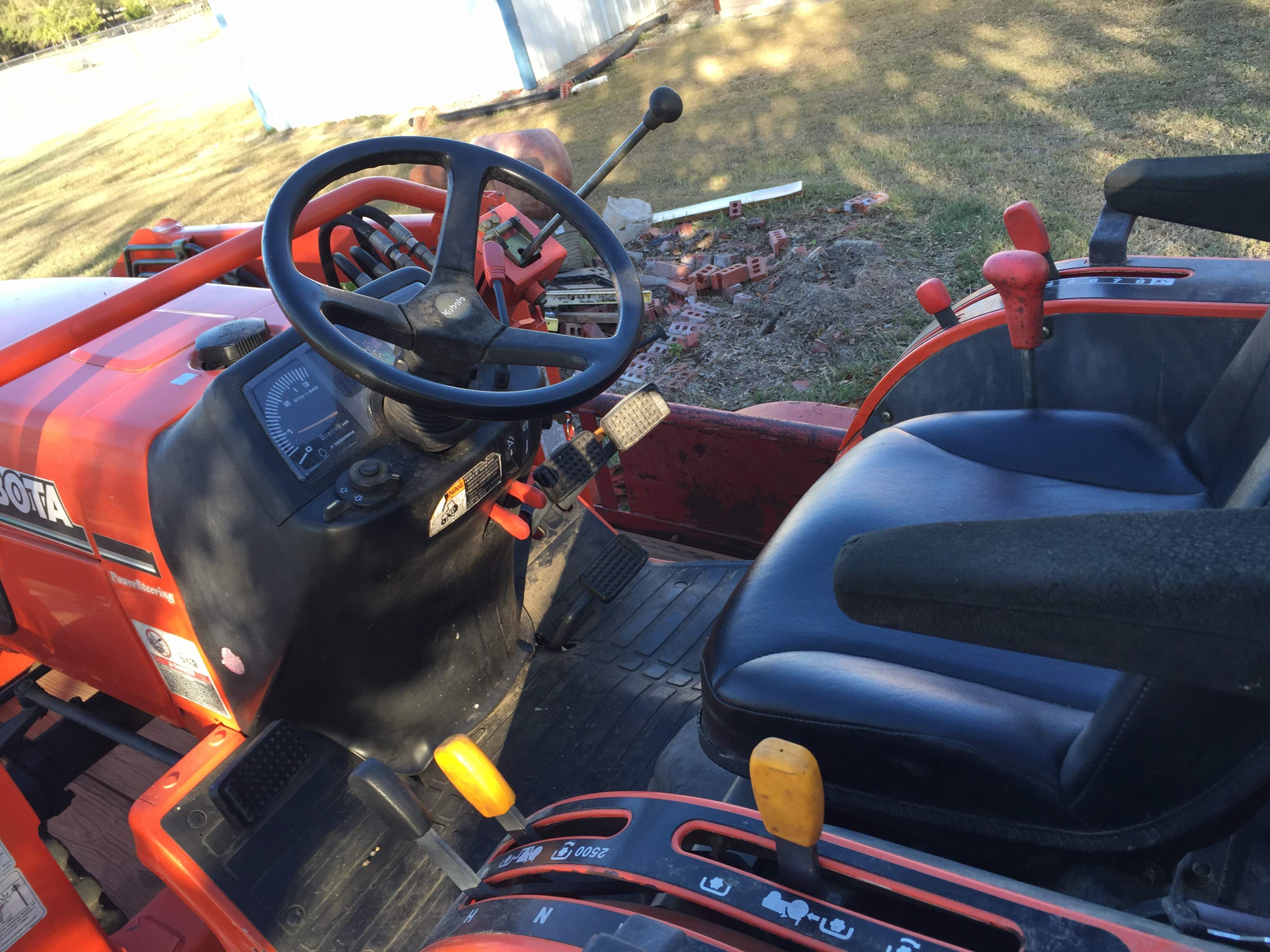

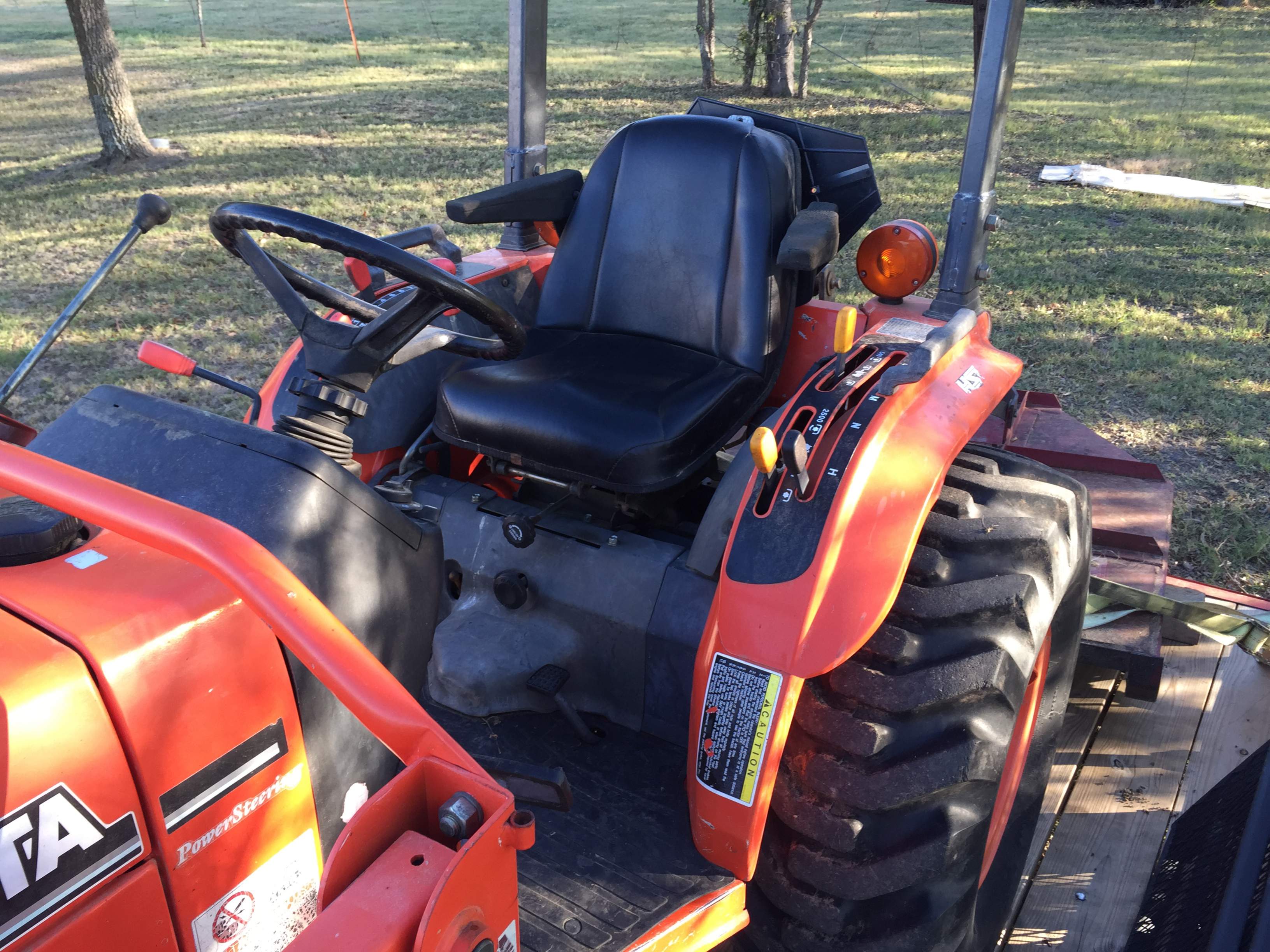

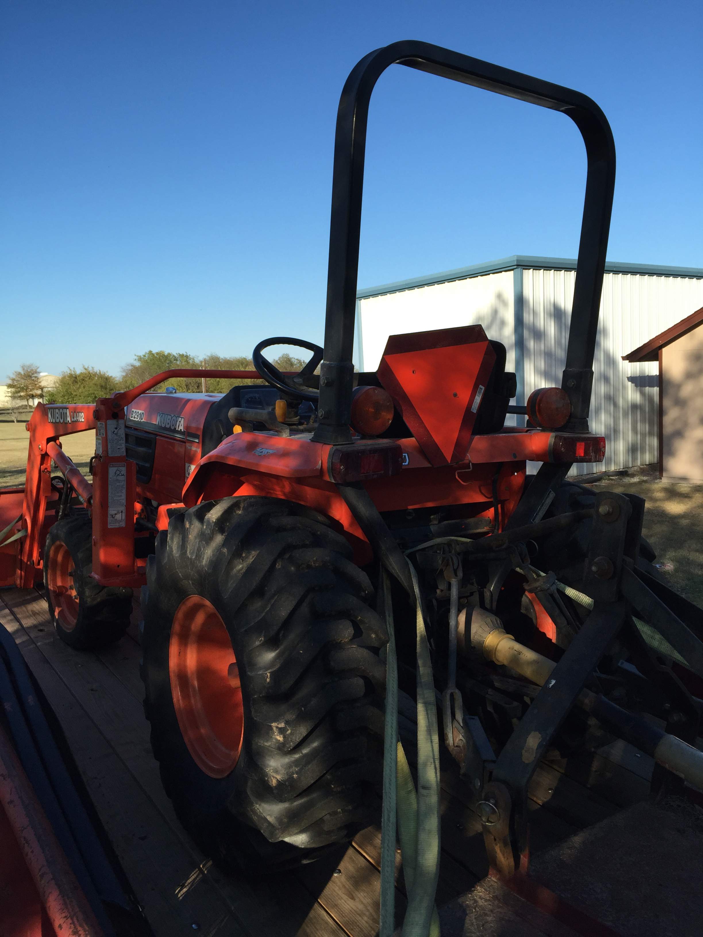

Thanks for all that great info. Sounds like another happy B2910 owner. To be honest I never know this particular model existed. After looking at it I really like this model. Just going to have to check it out better and make a decision. I definitely will take some coolant and my pressure tester and see if I can find anything out with the coolant. The hydrostat, 3 pt hitch, hydraulics, and pto all worked super nice so hopefully there is no serious damage from the lack of filter and/ or fluid change. Here are a few pictures of it before the owner unloaded it from his trailer. He had just brought it back from the land he uses it on.

At least the engine oil filter has been changed once. It should have been changed about 5 times by now. Ask him how many times he has changed the oil/oil filter and what kind of oil he put in it. My B2920 still had the gray hst and hydraulic filters when I bought it. That didn't worry me because it only had 112 hrs. 800+ without those being changed would give me a little more concern. I believe the hydraulic fluid should have been changed twice by now. I would be skeptical about the hydraulic fluid having ever been changed since the filters have not. I can't remember if you said anything about the look of the hydraulic fluid. Does it look fairly clear? It was talked about how the owner would have been smart to change the hst and hydraulic filters prior to putting it up for sale. It could be he got some of it right (in the wrong way) by changing the oil filter and oil just before putting it up for sale. Could it be that gray oil filter hasn't been off long? Then there is the coolant thing also. I would proceed carefully. Check for leaks thoroughly around the engine and underneath everywhere prior to running it. Then check again thoroughly after running it long enough to get all the fluids hot.
I know what you are going through as I just bought my B2920 two weeks ago. Fun and extremely stressful all at the same time. I certainly don't want to discourage you, but do want you to be satisfied down the road with what you get. It is hard to keep the buying fever in check.

It looks like it's been used and has spent some time living outdoors ... I can't really fault that as mine has been thru similar ...
Overall, it looks to be in better shape than mine cosmetically, albeit with a few more scuff marks in certain places (tops of curl cylinder, brush guard) ... should clean up real well tho'.
The seat cover looks like it has been replaced ... mine needs to be, the vinyl having split open in a couple of places. The arm rests are cracked (so are mine) ... there's a plastic dip coating that is used for tool handles available at Home Depot that might be worth investigating to restore those.
Check the hard lines on the loader cross tube - they look bent in the picture. Two of mine have bad dents in them (need repaired/replaced) ... acquired when I loaned (never again !) the tractor to a former employer who was an idiot and who probably wrapped a chain around the lines and cross tube to pull/lift something.
The front rubber looks like it has plenty of life left ... mine have almost all the tread worn off (avoid 4WD on hard surfaces like pavement - it tends to make the tires wear a lot faster) The rear tires on mine are in great shape, considering hours/age ... look near new.
If the tach is working in the one picture, the idle speed should be raised up to around 1200 rpm to help prevent wet stacking.

Fascinating thread! Like others have noted, the tires look good- and the machine has sat outside, from the looks of it. That's a shame, but shouldn't affect the major systems. I'd say if it takes just a little coolant, and runs fine without leaking or overheating, and the oil seems good, and the hydraulics work and the fluid is clear, then the price allows you to invest some in going thru the machine and getting it ready for a "fresh" start with your ownership. Armrests and such are fixable. Take a grease gun, and see if grease comes out of the links and fittings when you shoot some fresh grease in. Might be fine. Around here, you can't find a good bushhog for $450. Did anyone mention checking the debris screen in front of the radiator? From the looks of it, the owner wasn't very compulsive about caring for it. Still, 900 hours is nothing, if all the vital fluids were okay. At least he didn't roll it.
