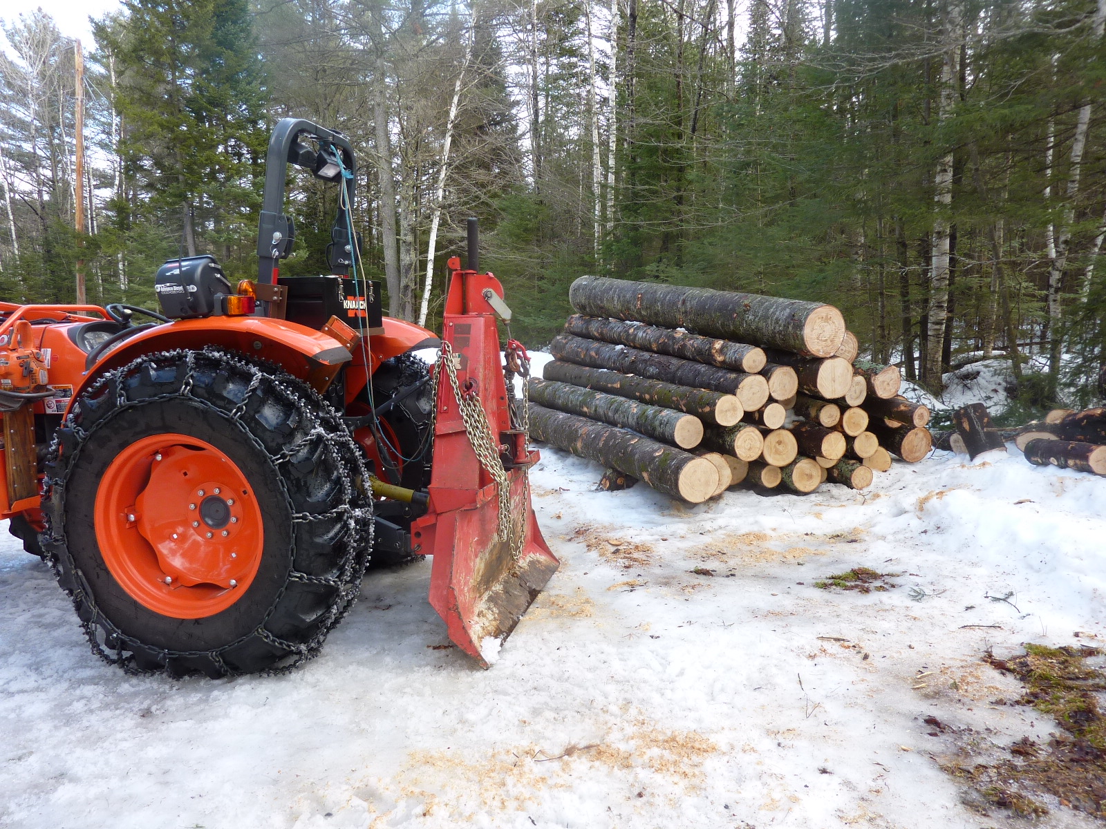

I took my chains off this summer for the first time in 15 years. This is what they look like on the R4 tires. Half of the cross links seem to drop between the lugs. After getting wheel spacers, I am thinking I may be much happier just using them in the winter and running them loose, as compared to all year round running them tight.
Of course if I do that I will not have chains on when I need them on muddy surfaces. AND just last summer I bought a new set of spring tensioner to boot, still unused.
Decisions, decisions!

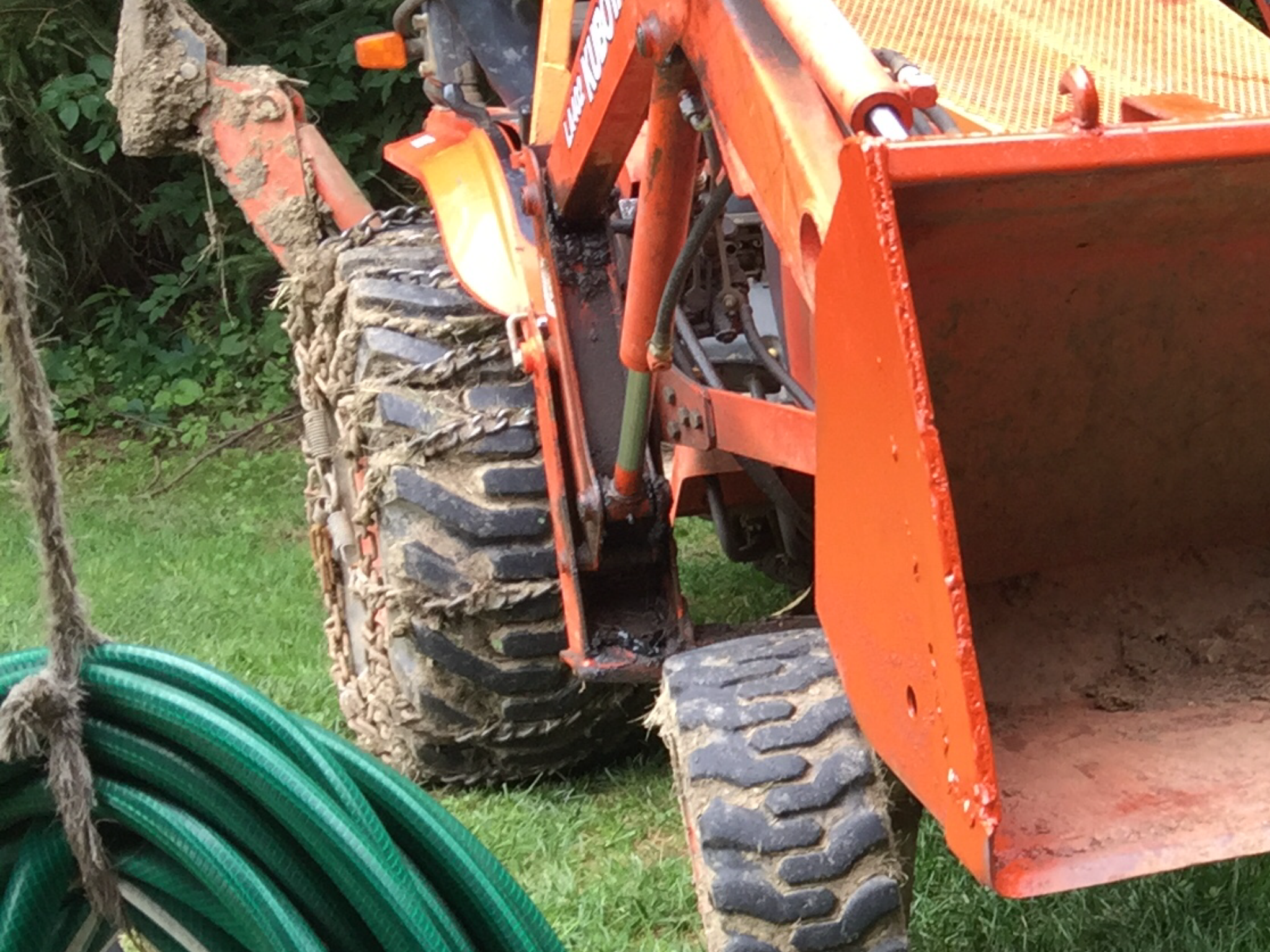

My rear chains are very similar to Gordon Gould's. They are made by Trygg, in Norway. Their instructions recommend the same looseness indicated in Gordon's instruction sheet. The reason for the looseness is so they can be self cleaning. The mud or snow gets shaken out with each rotation. I widened the wheels as far as possible, and as long as any extra links are hitched down nothing hits the fenders. There is a video on the Trygg website that shows them being installed.
On the other hand, I stole a set of regular ladder type chains from my pickup to put on the tractor's front tires. They have to be snugged down tight because when the wheels are turned they just barely clear the loader supports.
