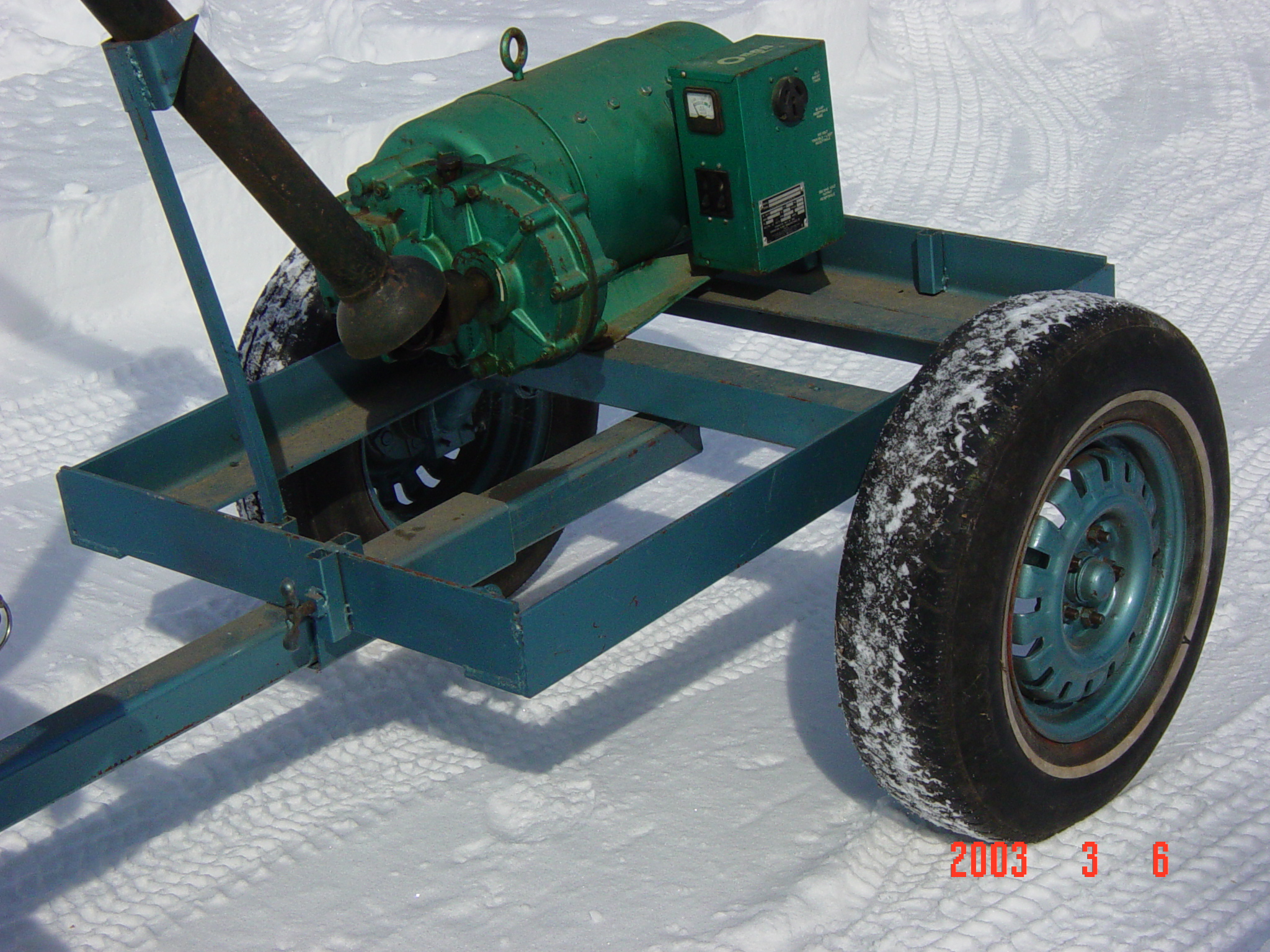

   / Running Generators in Parallel? #9
Better than a portable or one of those lawn mowers in a can, and most certainly better than nothing but I got tired of the PTO. You never know how long the outage, and with the PTO, I always hesitated going through the motions, maybe for nothing.
Also, you really need to periodically warm up the windings of a generator to keep out moisture, so really any attached engine would get exercise and be ready for service. You hope.
My old Onan 15KW PTO set
