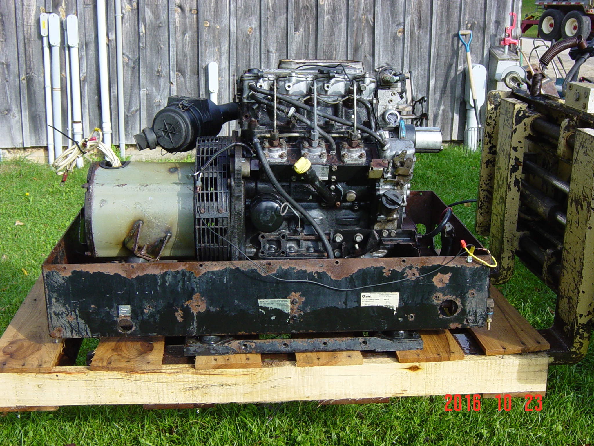

That 12.5 KW Isuzu Generator Ralph mentioned is a sweet running machine. It's a current project of mine.
I bought a 200 amp ASCO Switch (I figure one of the best) off E-bay CHEAP. You don't always need to spend lots of money to get quality and substance!

Yeah, bought from Central Maine Diesel. The enclosure I bought from them has tended to rust around the edges of cutouts, etc. I've painted on Rust Reformer and seemed to have stopped this. Also give the paint a wax job a couple times/year.
Disappointed in the seemingly poor quality of the radiator hoses. NOT like the really high quality (rad and heater) hoses (never replaced) on our 1983 240D Benz that we had through age 26. Think I'll have to order new hoses from Central Maine when I change out the coolant at around age 10. Thinking it would be very difficult to match them up with local hoses.

Ralph. At least you have hoses. That Onan/Isuzu had some remotely mounted rad. Changing it over to conventional rad, electric fan and appropriate hoses has been way more work, effort and money than it might be worth. I don't need another generator, but if I did, the Ebay Military surplus route would be a better bet. For the quality, I bet that 15,000 dollar installation is probably a huge ripoff if it's consumer type crap!
