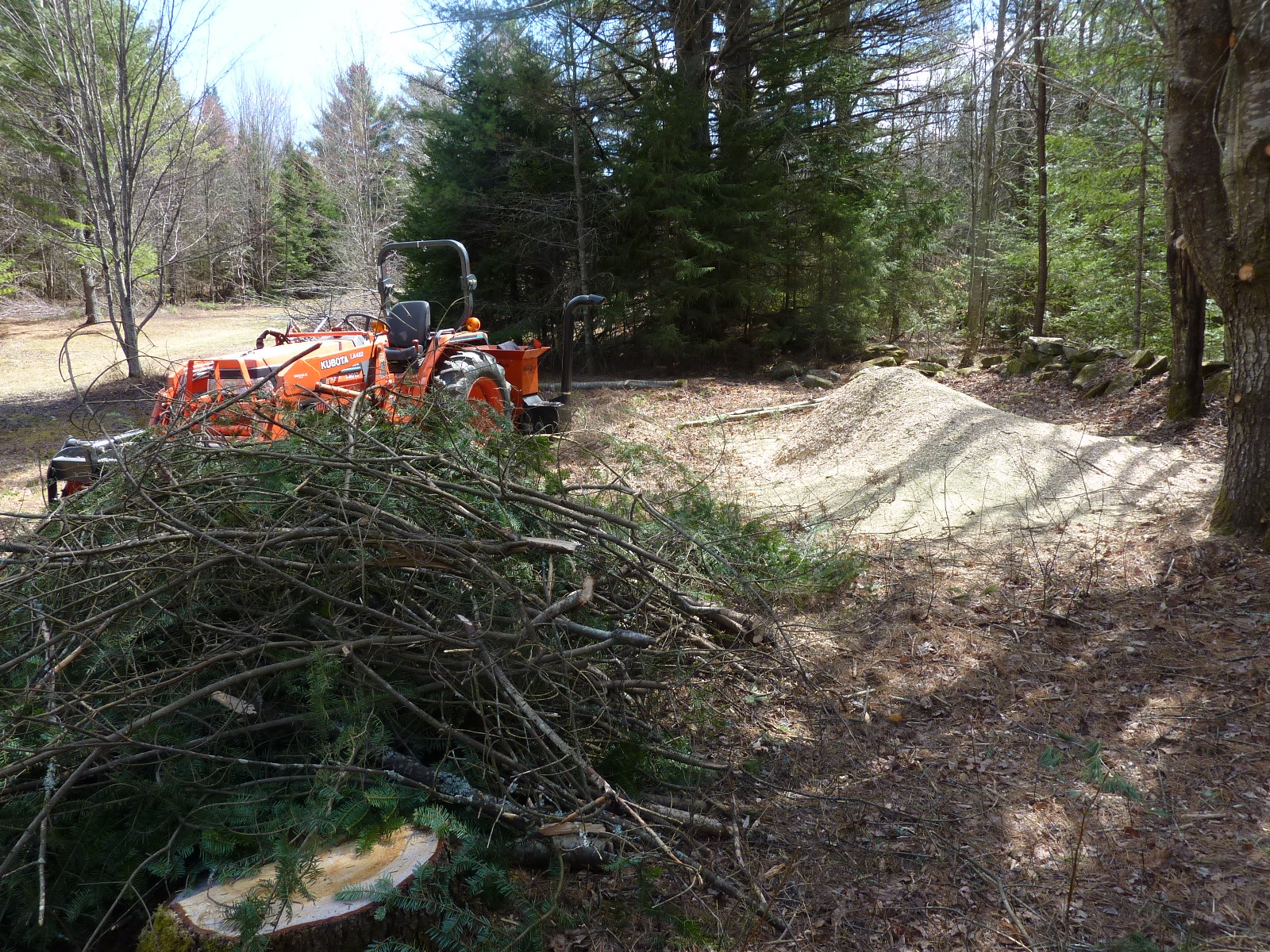

I've seen some recent advise that a chipper w/o hydraulic feed is not desirable. My BearCat is manual feed and honestly feel hydraulic is not necessary on it. I have never run other brands so I don't know about them. I put a video at the end so you could see how mine works.

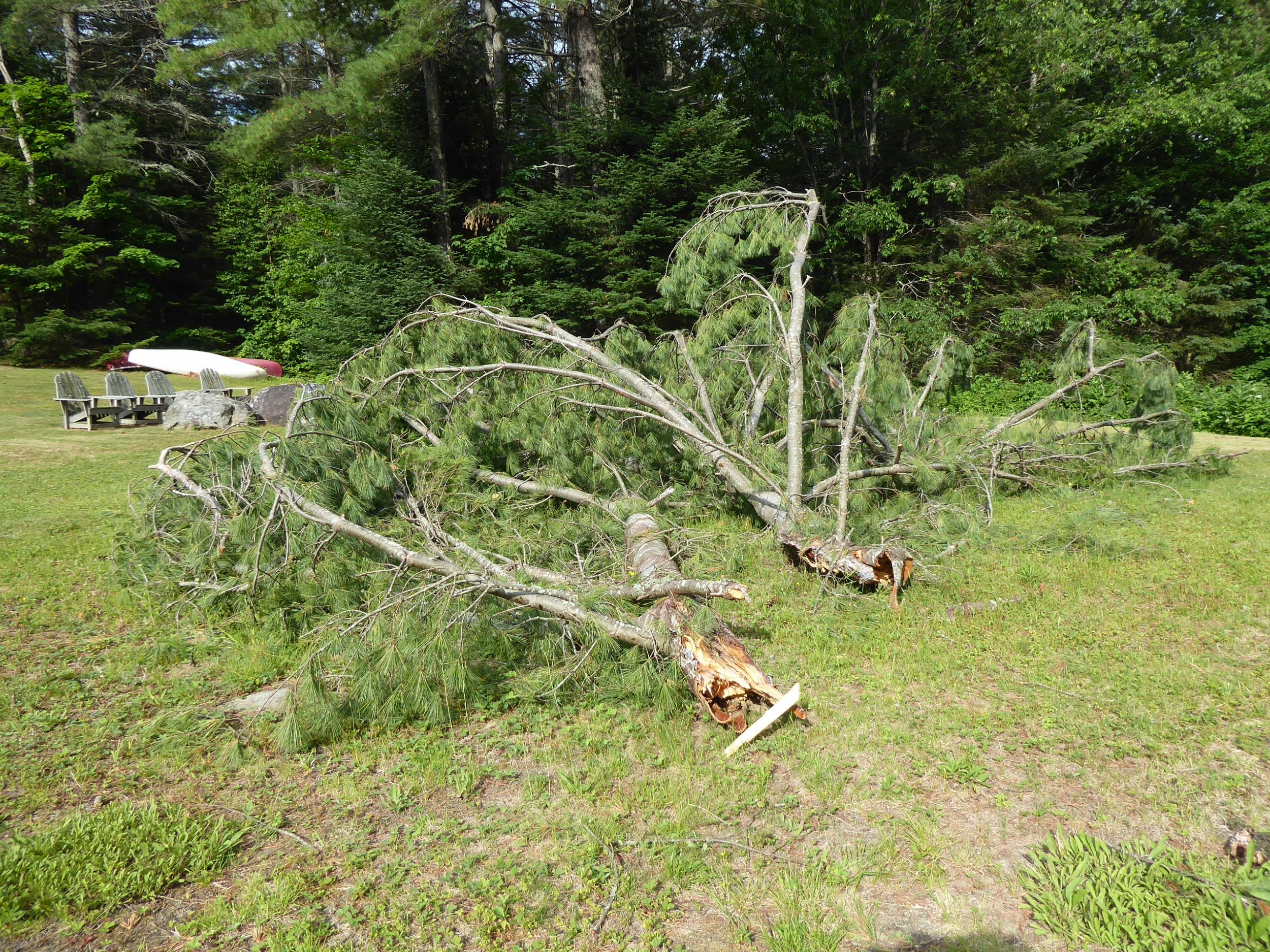

The top of a backyard pine blew out in last weeks big storm. It broke where it got weevilled many years ago and 3 leader came together.
Stuff that comes down in the woods I am happy to let sit and rot but stuff around the door yard I usually chip all the branches and burn the rest in the fire pit. I dragged the top to where I could blow the chips into the woods.
I bought my Carry-BearCat 554*** used about 15 years ago and have always kept it in the garage so it is like new. Have done nothing but sharpen the knives. If the knives are sharp it pulls stuff right in. It will take 5-1/2" wood but to me 4" is fire wood. I am running it on a M5640 tractor and made a short video of starting to chip up that top. The bigger branches are 3-1/2" in diameter.

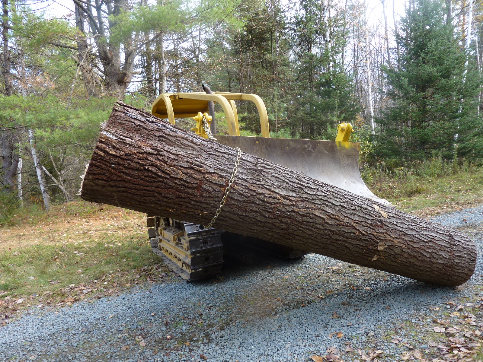

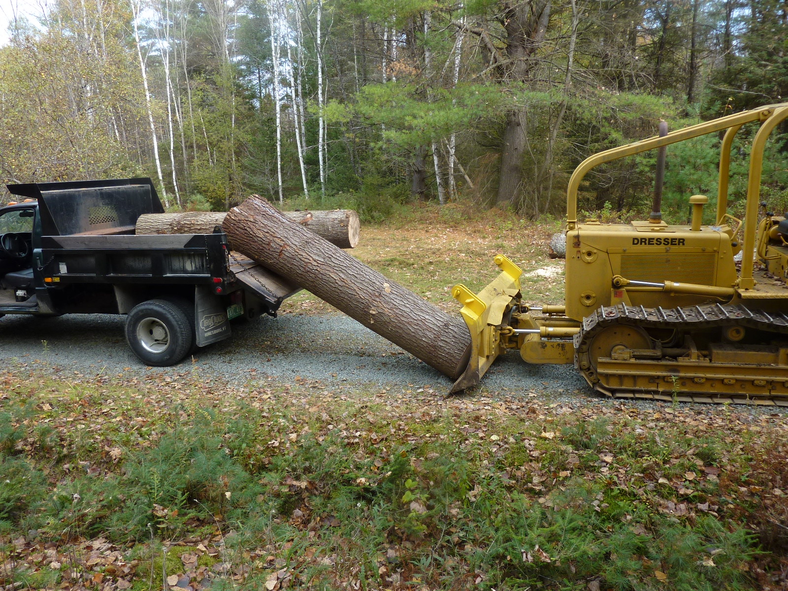

Used to have to do it this way
Then back under and push it up
Good thing my time isn't worth much -
