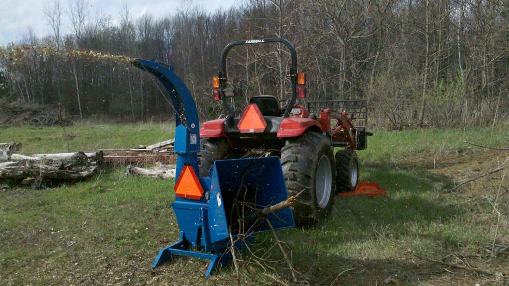

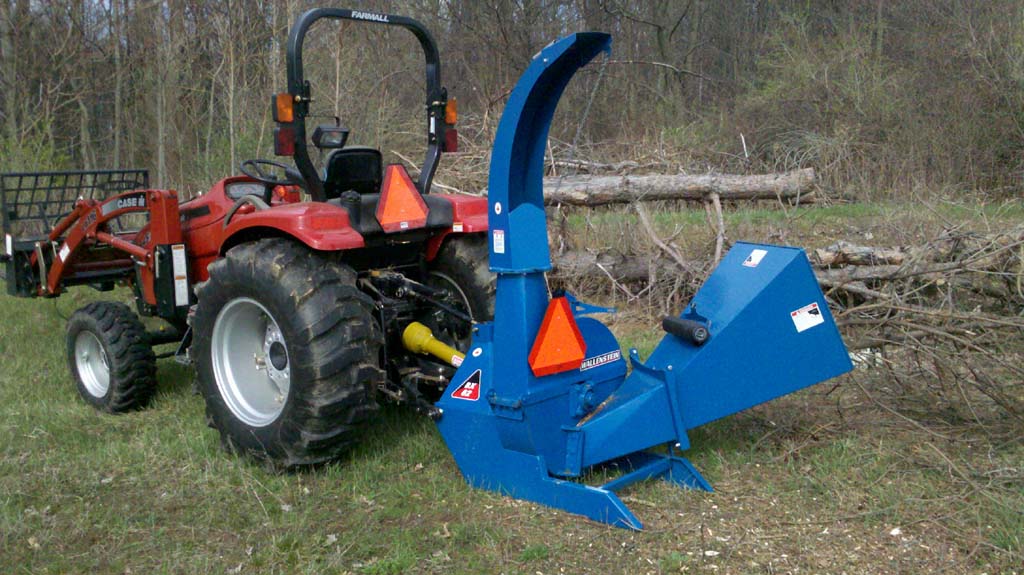

Ran my new Wallenstein BX62 chipper today and is quite the machine. I was nervous about buying a chipper without hydraulic feed (budget wouldn't allow it :() but I am impressed with the Wallenstein's ability to self feed :thumbsup:. It throws the chips pretty far, too. The first picture shows it on my Case DX45. The second picture shows a branch resting on the hopper. I had the camera ready, gave the branch a push and jumped back to snap the picture. The BX62 had almost swallowed the whole branch before I got the picture. That's pine that has been sitting for 2 years so it was pretty dry and all the limbs where stiff, but the chipper just pulled it in bending and breaking the limps as it went.
So far the only draw back is that I had to settle for the NH blue as it was the only BX62 the dealer had in stock and he gave me a pretty good price to take that one rather than order a red one.

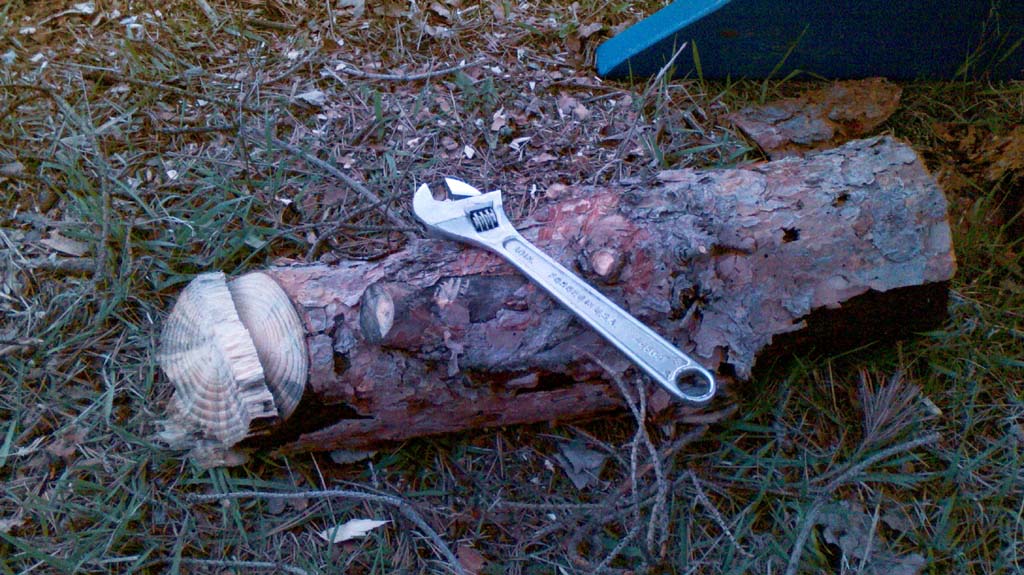

My Case has the same ratings as your Boomer, 36.7 HP at the PTO. I have no regrets getting the 62 over the 42 other than the dealer had a 42 in red. He only wanted $500 more for the 62 so it wasn't too hard to decide. I agree with Ductape that the wider opening helps with crotched branches and will reduce the amount of trimming you have to do.
I did stall the tractor with a larger diameter limb shown in the picture. It had already chipped about 5 feet of that limb. There was a heavily knotted section just before the cut in the picture that slowed the tractor and think it just ran out of momentum. I restarted the tractor and threw that piece back in and it gobbled it up without issue. I didn't have a tape with me to measure the limb, but that is a 10" adjustable wrench laying on it.
