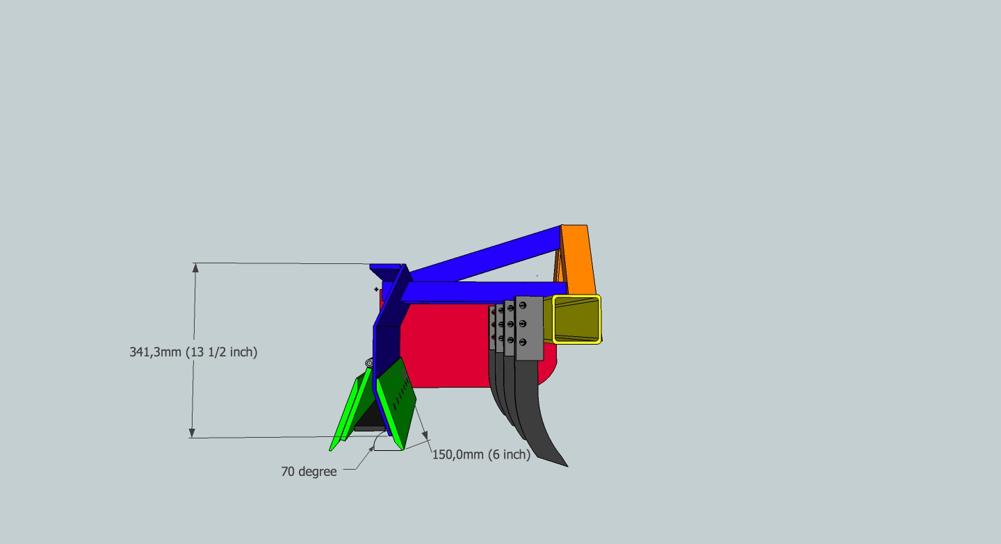

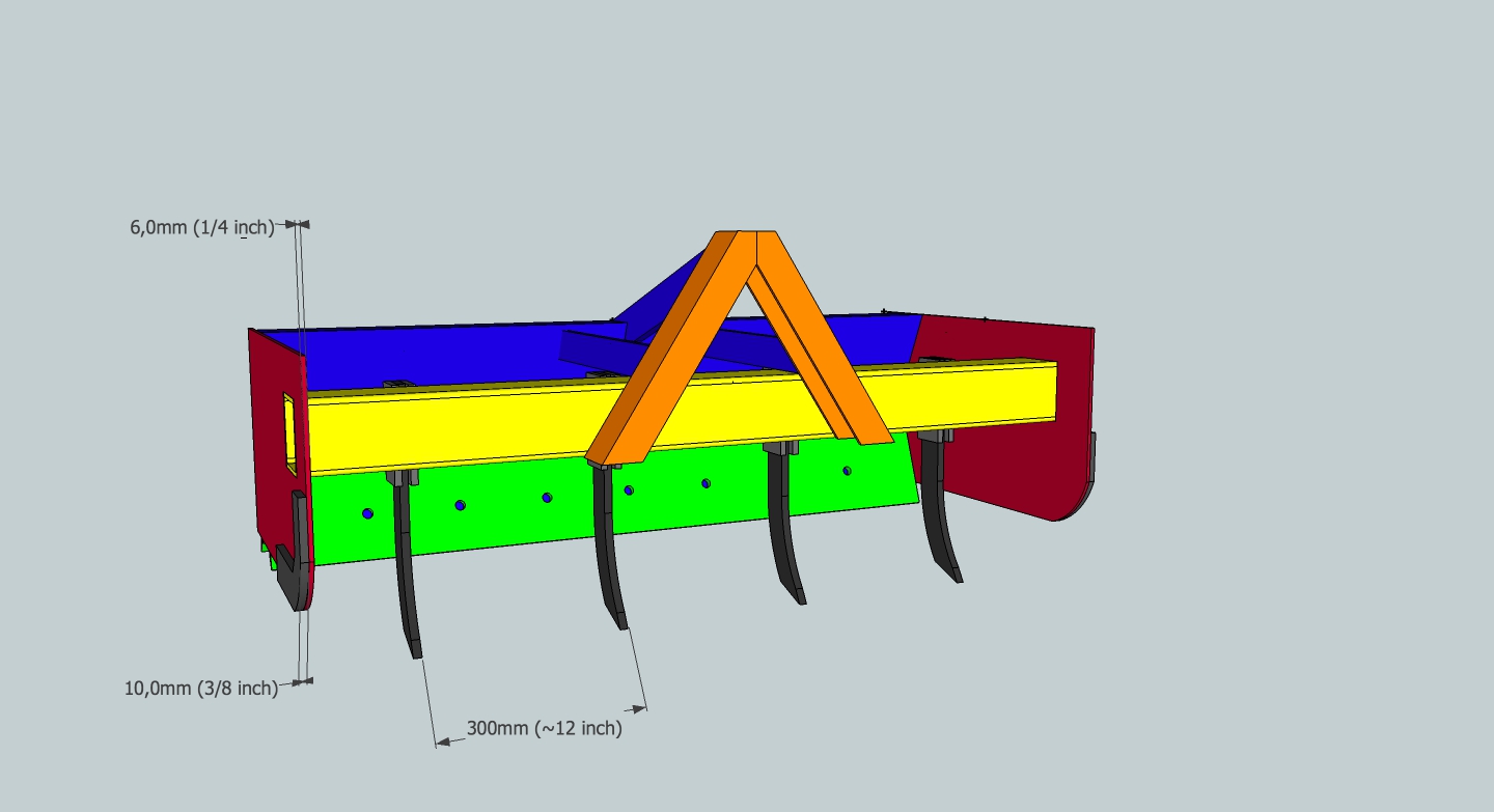

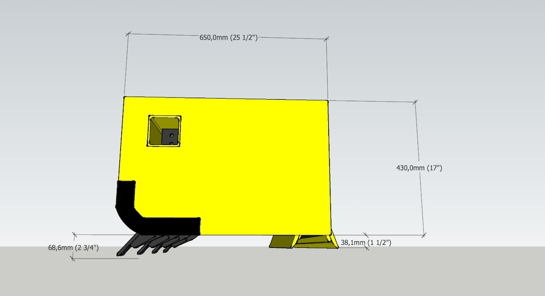

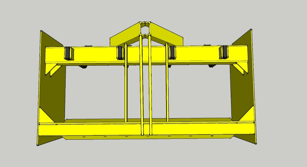

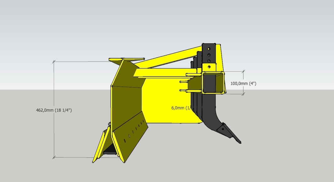

Hi,
I'm just making up a draft for a box blade. I wanna pull this 4ft box blade with my 19hp Kubota B1500. Fortunately i found Google Sketchup, as this is a really easy way to make up a few drafts on the computer.
I'm happy to hear your critic and maybe a few suggestion how to improve a few things! :)
Cheers
Rushy

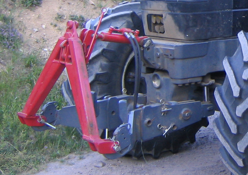

Welcome to TBN, Rushy.
That looks plenty beefy for 19hp!
How are you going to mount the pins for the 3 point hitch?
Looks great - I'll have to give Sketchup a try.
/ Rushy's box blade project (4 ft, hinged back) #3
looks like a "depth adjuster" may be needed....
/ Rushy's box blade project (4 ft, hinged back) #4
The blades on most scapers are curved. Are yours going to be straight?

That's an triangle for the european quick hitch like this here Weiste-Dreieck_am_Fronthubwerk_2.jpg
@Dave
I haven't put in the bolts in yet for the scarifier, if you mean that
@jel 1988
I'm not too sure about that, an folded blade is much easier to make for me. Maybe i do an curved blade. Not to sure, if i can find an engineer who can curve me a sheet.

If I was going to build a box blade I would design it so that at some point the rippers could be made to be raised/lowered with hydraulics...

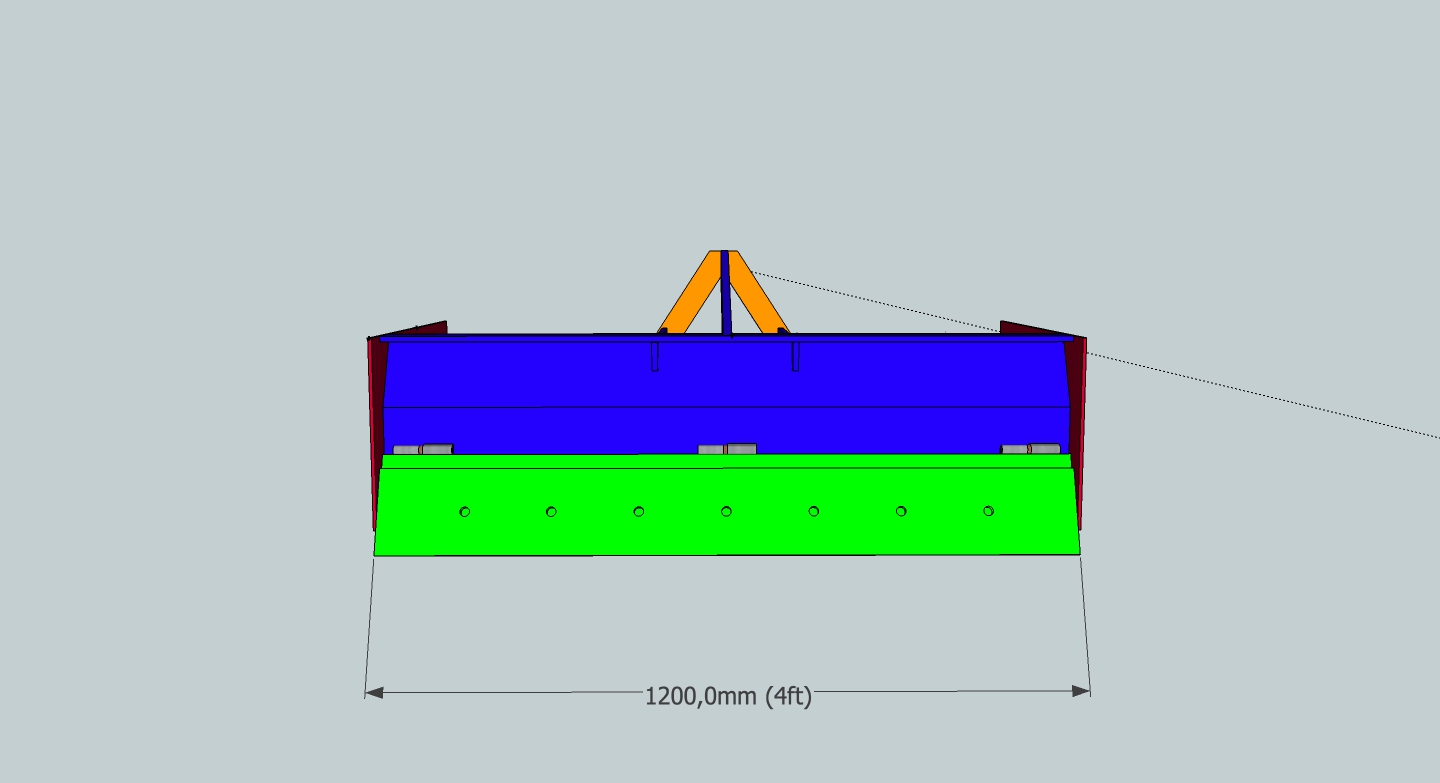

Hi,
i just did some calculations about the weight...
without any welds and bolts the box blade will have a gross weight of 153kg (about 340 pound). I think, that should give it enough downforce?:)

Nice looking box blade. I think the straight blade will work fine, it's the angle that does the cutting anyway. I'm equally impressed with your google sketchup skills!

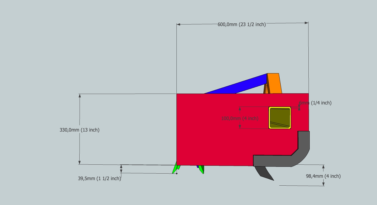

A few comments from one who built and has used a similar sized boxblade:
The scarifiers look thin to me. They'll see significant side loads and twisting forces when turning the tractor, and when they are hitting rocks/roots, etc. I'd recommend at least 12mm (1/2") or thicker material. You also may want to weld a "shovel" face on them to make the tips wider, ideally out of hard material.. The scarifiers purpose is to break up and lift the ground, not just to slice it.
I think the cutting edge angle is too steep. You want it to shave the earth, not shear it. I set my cutting edges at 45 degrees and that seem about right.
The top rear of the box doesn't have to be curved forward, unless you're using that bend to stiffen it, but it'd be easier to fabricate with just a flat back and weld a piece of tubing or angle across the top to stiffen it. The box doesn't keep curling the material like a snow plow... it fills up from the bottom up and the material just slides along the ground.
I'd make it so the cutting edge is just slightly below the sides, ~12mm (1/2"). You generally don't want the blade to take a big bite. The sides help control the depth of cut.
Oh, and plan to incorporate a trailer hitch on the back. It comes in very handy. My boxblade stays on my tractor all the time unless I have to use another implement, and being able to lift a trailer on the 3pt without having to remove the boxblade is pretty handy.
Just my thoughts and feedback on your design... take them or leave them.
Have fun building!

Thanks a lot for your tips!
-unfortunately you can't get proper ripper shanks in Germany, as no one has got a box blade like you guys have. The shanks in my draft are from a rotary harrow for preparing potato paddocks. The flat steel is 12x50mm and is the closest one i could find. Otherwise i have to let them cut by an engineer from proper steel. Generally i try do take common parts as it saves me time and are easy to replace just in case it breaks down or wears out. Btw: i wonder if it is cheaper to import a few shanks plus a set of spare one from the states, i have seen some for 17$ each? The shanks wich propose to use are 34 US$ each....
- yeah, the idea of an hitch makes sense. I thought about to put my steel roller behind the blade to compact the loose dirt immediately in the lower spots that the blade doesn't cut any deeper in the next pass. Makes that any sense?

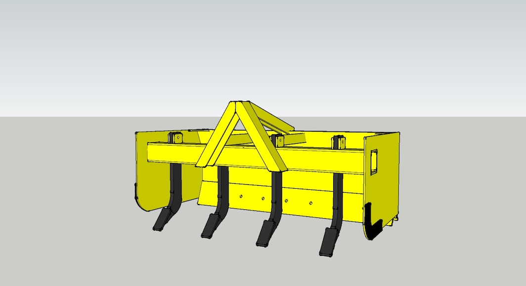

Hi,
i found a supplier for scarifier tynes in Germany and modified the design of the box blade a bit to fit the tynes. What do you think about this design?

Rushy,
The moment arm on those teeth might be too much unless you lower the square tubing cross brace. I fear they will either bend or deform the cross brace under load!

Good point, and i think with the tube steel that high it will tend to cause the box blade to roll up rather thandig in. Lowering the tube steel will be better. Look at manufactured box blades and see how high theirs are.

It looks good. I would cap off the main tube to keep stuff out of it. Are you going to make the hinged back so you can lock it in place to function like a fixed back.

Yeah, thats my plan. Just not to sure, how do engineer it. Has to be as simple yet effective as possible.
I lowered the shank beam 50mm and took the same measurements for the end plate as one model of land pride:

I also agree. Looks like there will be too much leverage on the shanks with that design. A lower or second crossbrace would probably help. Good luck and have fun! Terry
I see you have already done that! Looks good!

I'd reinforce the bottom corners of the square tube where the rippers bear on the tube inner wall. They will want to tear out the tube wall. Something as simple as welding a piece of 1/2 x 1" strap might buy you a lot of local shear strength. Looking good - when will you start fabrication? Don't forget to take lots of pictures!
