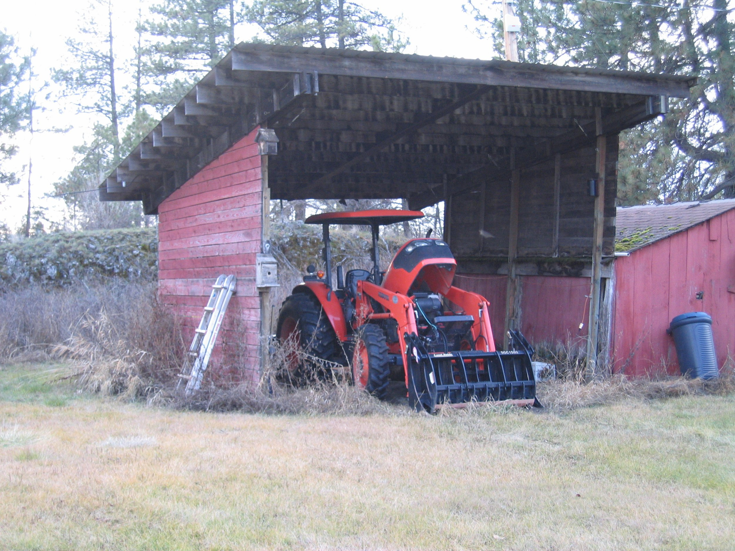

I used some brand of lead based Barn Red on a couple of my out buildings in 1982. That was 40 years ago and they still look acceptable. This picture shows full sun exposure and - basically - no sun exposure.
may have lasted but the color match is a bit off.
