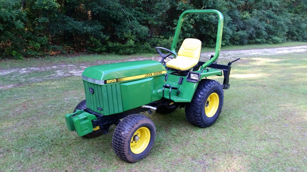

I used the JD green on my 855. Looked great at first but faded pretty quick. Still looked good when I sold it but there was some flaking at 3 or 4 years. Just in one place but I know I didn't miss that area when I sanded and cleaned.
As far as a rattle can job there isn't any better. I tried the Krylon farm paint and it took 3 cans to cover what 1 can of Rustoleum did.

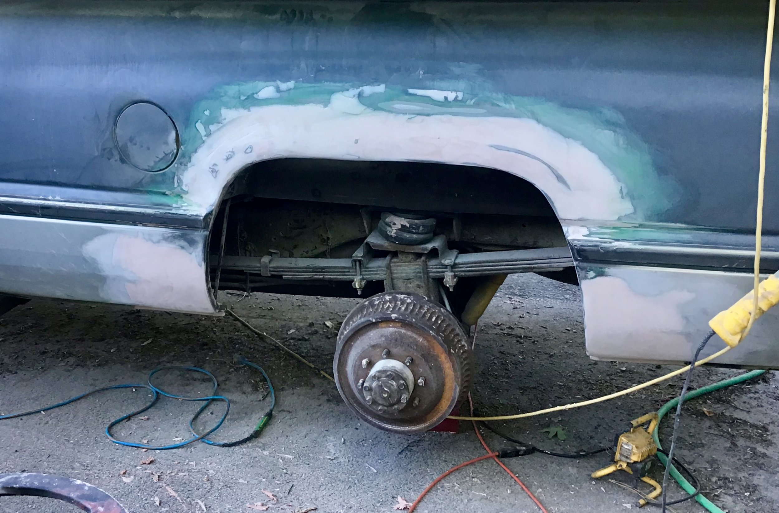

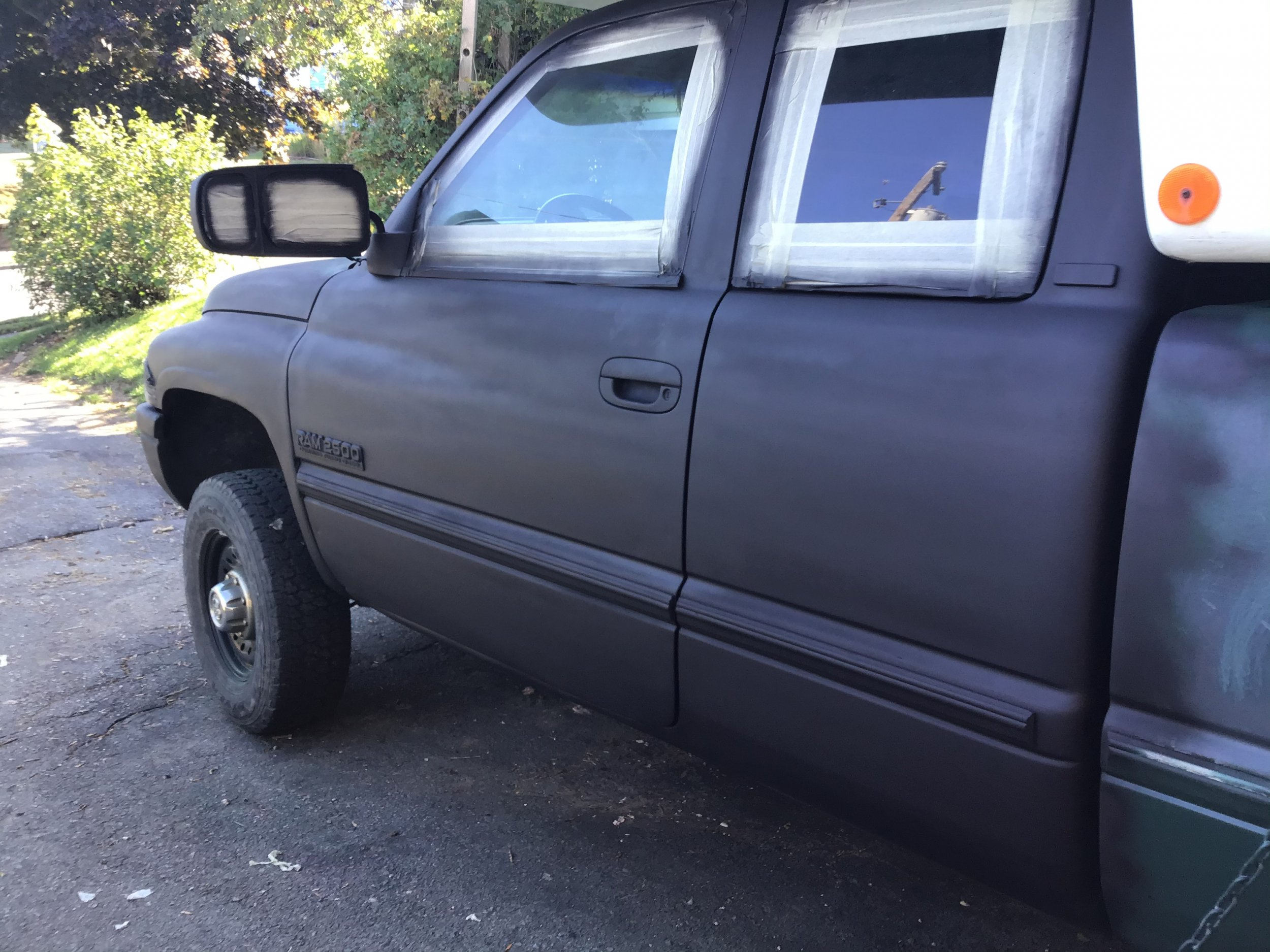

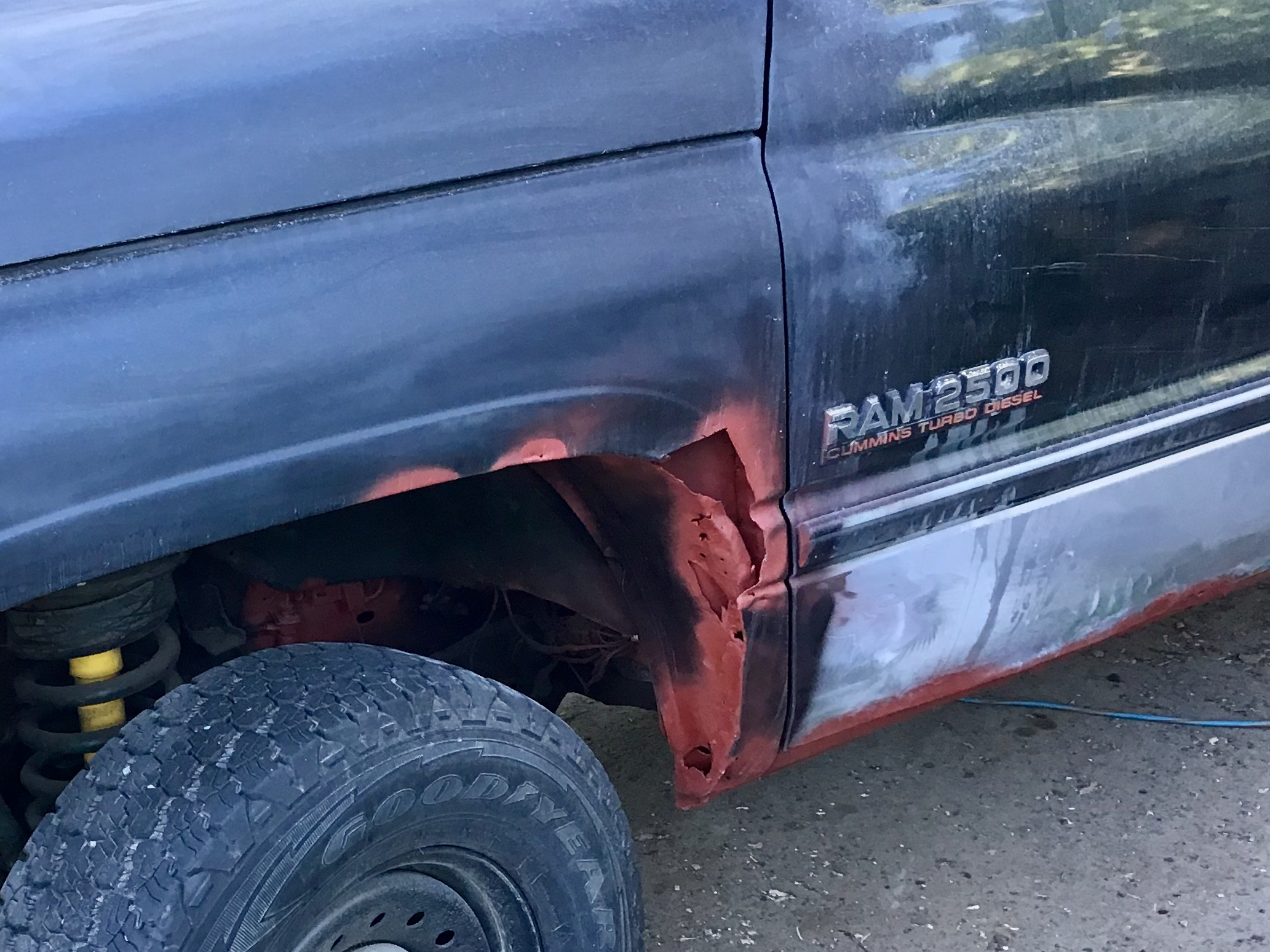

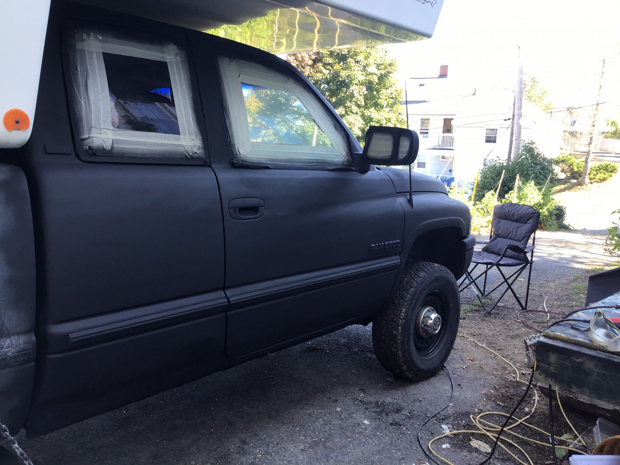

My old truck ran into some Rustoleum rust neutralizer followed by flat black rattle can and/or cans of rustoleum paint. Had to use the flat black as my preparation and application skills are not up to standards.
Looks okay from a distance.
A before and several after.

/ Rust oleum farm implement paint #15
Egon - looks totally acceptable.

You would find the truck underbody sprayed with a rust restore followed by Tremclad rust paint and finished off by a mixture of roofing asphalt/tar/gunk and diesel fuel applied with an air gun. All the frame parts are included with this spray and many of the body panels. The inside fender well edges were filled with bondo and finished to a smooth rounded surface that does not trap water Or debri.
Just can’t afford the proper materials but those I’ve used seem to work well.
