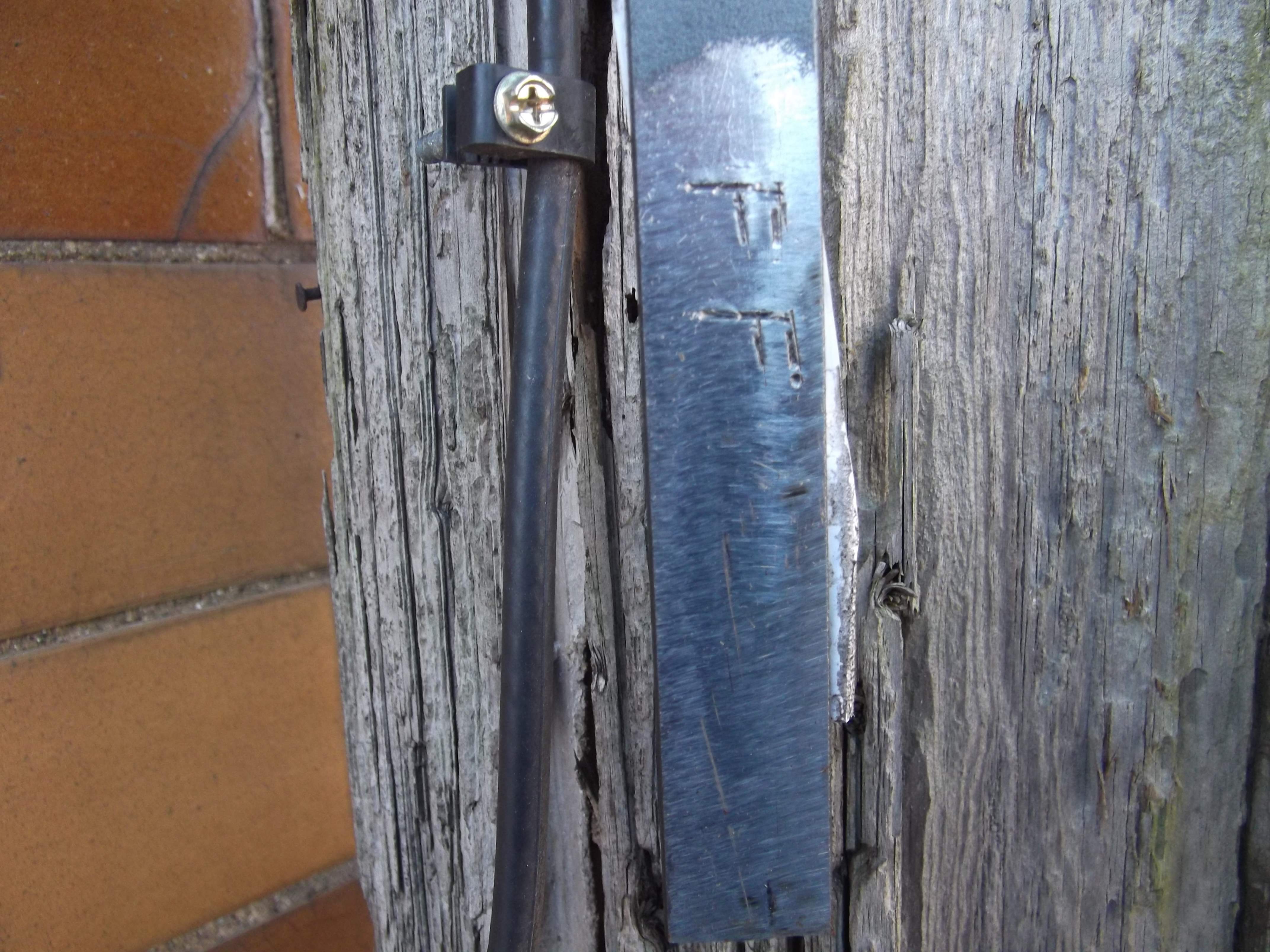

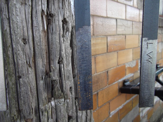

I make same test with 15 products
Krown T40
RustCheck Red
RustCheck Green
DuraTech
Metropolitain Bio
Metropolitain Old
Formula 3000
Fluid Film
WD40
Boeshield T-9
ACF-50
KleenFlow PWD
Liquid Wrend Lubrifiant
ReleaseAll
SprayOn 711
Rust Check, Metropolitain Bio and Formula 3000 are thicker
I put stuff on steel bar 02-09-2014, spray salt water 5-6 times, wipe bottom (+- 1 inch), spray salt water 2 more times and wash with soft water. 03-01-2014 picture show results.
First: Liquid Wrench (I dont understand. It was not my first choice)
Second (ex-aequo): T40, Metro Bio, Formula 3000, WD-40 (Yes), T-9 and ACF-50
Next step, I will use high-pressure washer and salt water again.

That's pretty cool. I would not have expected liquid wrench and wd-40 to do so well. Did you do any prep to the steel before you coated them? I notice that allot of the samples have rust around the fastener which could be the acids from your fingers when you mounted the samples.
Welcome to TBN by the way!
/ Rust protection comparison #51
I just sand the bar to clean previous rust. The black spot on Liquid Wrench came from first life of steel bar. The top of bar were not spray because my finger cover it.
I make this test to find the best rust proofing stuff. A stuff able to penetrate in small crack. Not a waxy thick stuff that keep moisture in crack.

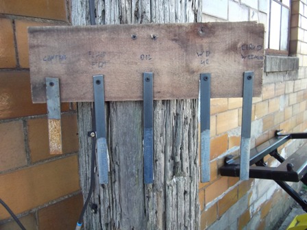

Just order CorrosionX. I understand it is a aviation stuff like ACF-50. I order GLI SHIELD IT too. I also want to test LPS Hardcoat but only find it in gallon. Many industrial storage protector can be interresting to test but availiability for 1 spay can is complicated.
You are right about evaporation. Long terme test sould be interresting.
I made a first test with 7 stuffs on a more long terme (4 month). Probably my test is to aggresive (salt water) but most sample rust a lot. Form left to right: Rust Check Red / Krown T40 / Formula 3000 / Sprayon 103 / SprayOn 711 / WD-40 / M-55 / raw
Formula 300 was the only waxy stuff
